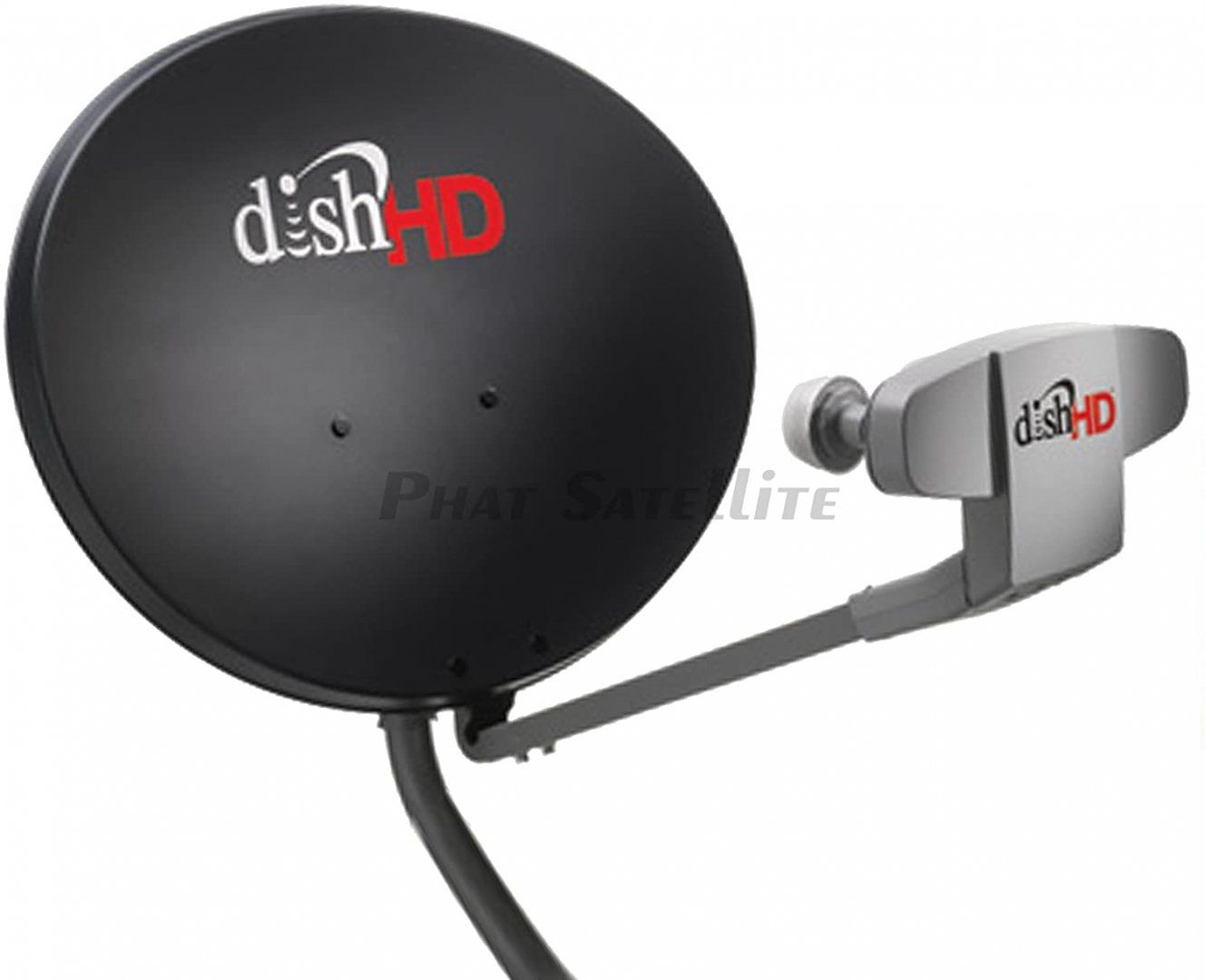

Awesome, that sounds like the gameplay then. The dish that is installed looks like the picture that I have attached. It was used with a Vip 722 and 922. Do I have to get the new LNB?
Yes, Dish usually only installs the Hybrid LNB for Hopper (especially Hopper 3) installations. They prefer to use the older LNB's for everything else. So, I would be nearly 100% certain they used an older DPP LNB on that dish.
