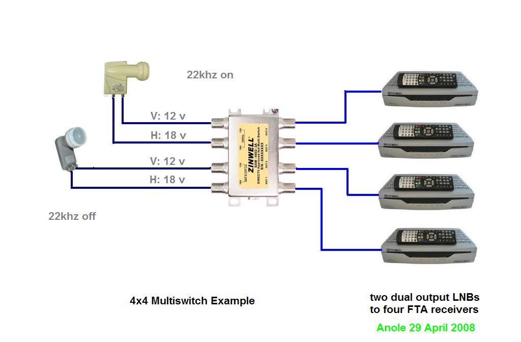

or get a dual output LNB and a 3x4 multiswitch...set up would be like below (disregard the 2nd LNB)
for receivers you could get by with any type for the SD channels and a cheaper HD receiver since its all MPEG2
