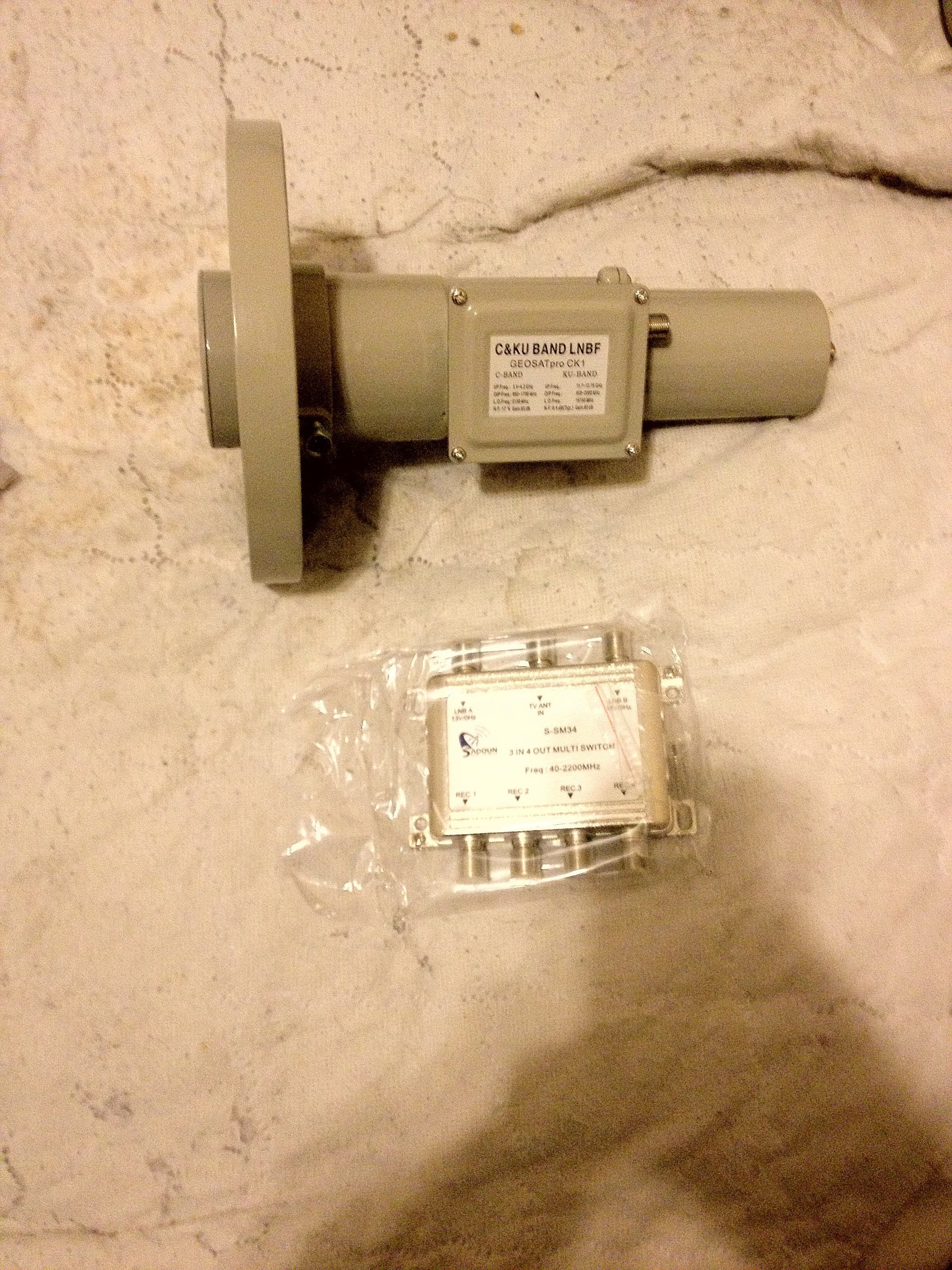

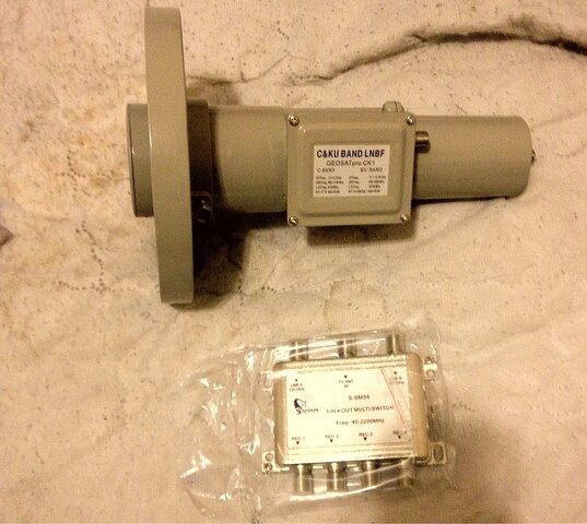

multiswitch --- how do i hook up a c/ku lnb to it
A dual band LNBF is not compatible with a multiswitch.
A multiswitch allows multiple receivers to use any of the dual output LNBFs connected to it, independent of the other receivers. Dual output LNBFs are required so each receiver can get either polarity.
Connecting a 2nd receiver via the first receivers 'loop out' allows the 2nd receiver to receive channels on the satellite, polarity and band(C or Ku) that is selected by the first receiver, when using a dual band LNBF. (NO Multiswitch)

is there a way to use the C/KU lnb in the picture with the switch in the picture?
To operate multiple receivers?
No.
Please read the SwitchesSimplified FAQ for a basic understanding of switches.
