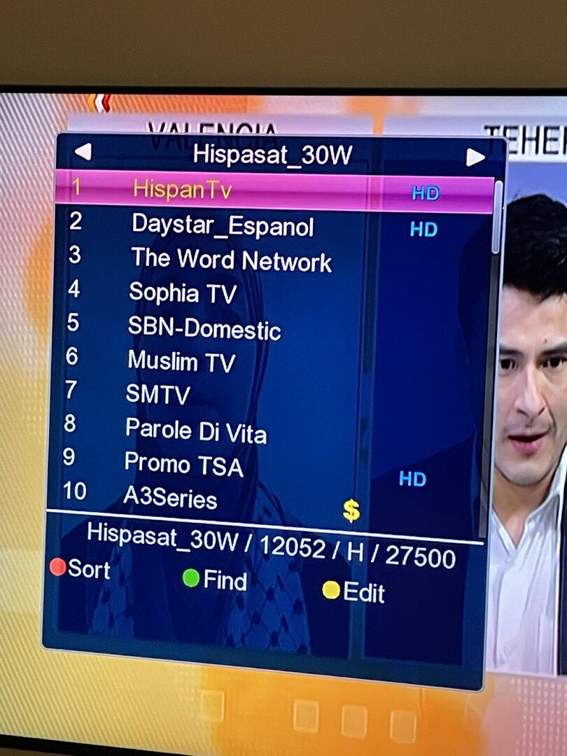

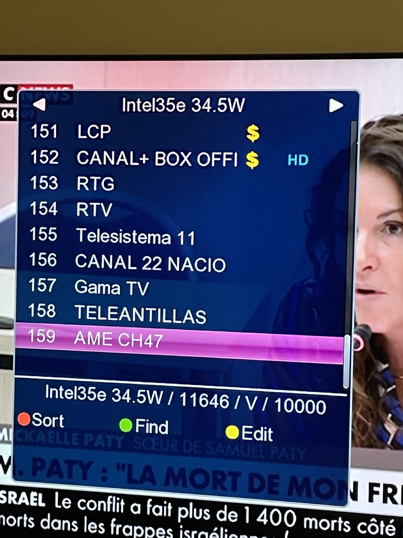

most channels on 30W are FTA, just a few are scrambled, and most channels are in Spanish (like Cubavision) or Arabic. If you are getting many scrambled channels, and just a few (FranceInfo, France24, CNews) are ITC and in French, you might be on 34.5W
Hi Brct203,
I confirmed I was on 30W. I scanned 34.5W too and got different channels. See my pics below. Thanks for checking it out.
