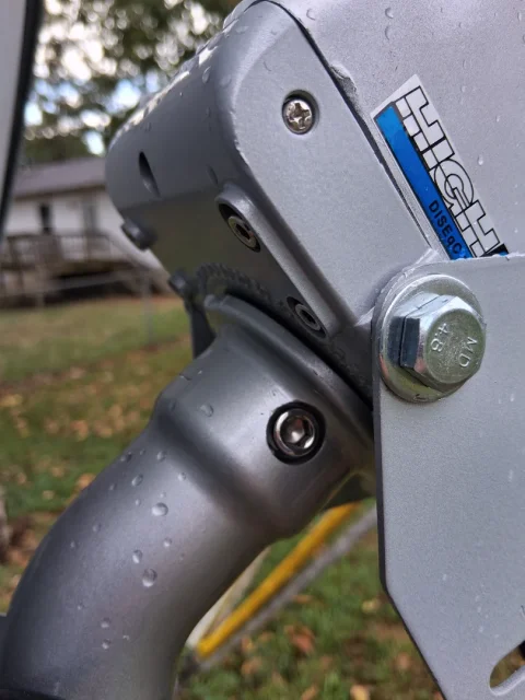

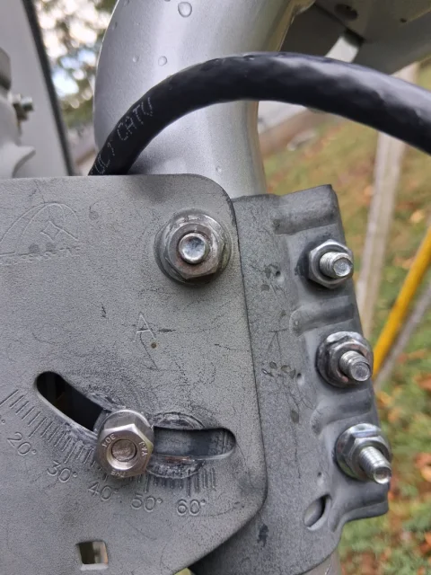

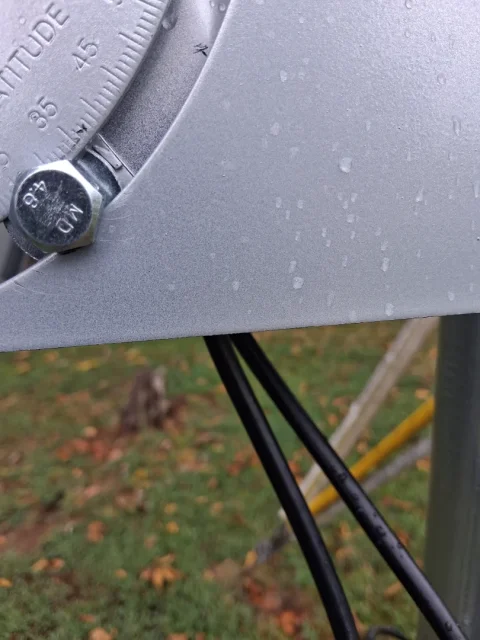

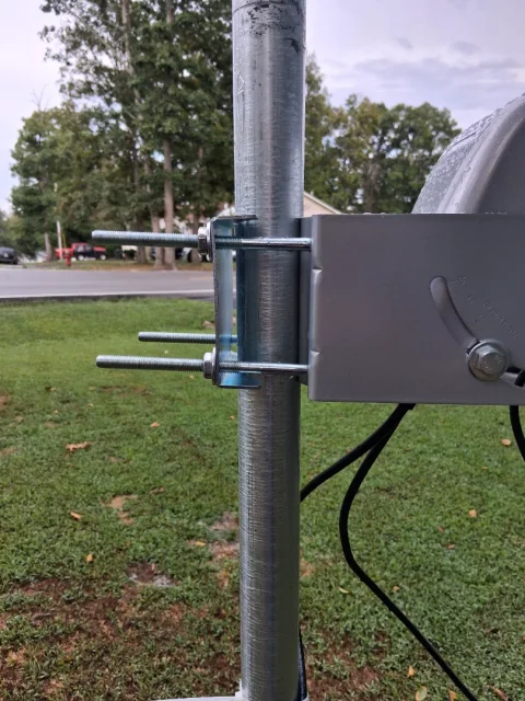

I see worm clamps in your future. At the bottom of your dish mount clamps on the tubes they are bolted to.
Makes doing fine movements more controllable w/o the mounts sliding down due to the weight of the mount.
