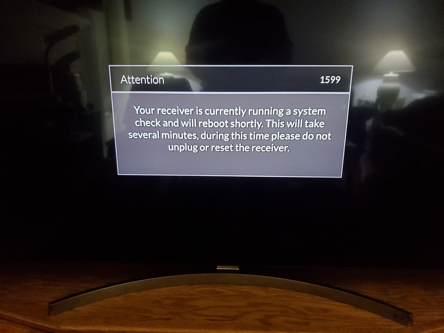

Had another incident a while ago and this time when I rebooted the H3 is took a good 15-20 minutes to come back up. There was a pop up that I have never seen before, I think it was #1599 (?), about doing a system check that might take some time. Once back up, the recording worked fine. I'm trying to pin down what is going on when this happens. But the way it just pops up and all I try to work through it without rebooting, I forget what I have done. But today was the first time of the "System Check" and nothing came back to me unless a report was sent to the "Mothership"? Could this be an "Internet Interaction" via my network related issue? I have seen over the years that certain Devices that when connected to the Internet the better the connection and operation of that connection, the better the Device operates. Even though the use of the Internet or Network is not directly involved at the moment. Although there is the MoCA connection between my two H3's . . .

Is this the pop up you got?
I have started saving pics of the popups in case needed.

I get this message every night at the 3 AM auto reboot
"YOU GET AN AUTO REBOOT AT 3AM "EVERY NIGHT"!!!"
I get mine whenever the H3 wants to reboot. AND it's always when someone wants to watch TV. Never when it's sleeping. Although they're set for 6am, it can be at 4:36pm, 12:22am, 8:13am, 1:56pm . . . . And I also get them during recordings and PTAT. 50% of the time we get the window that let's you stop it. The other 50% the screen just goes black. That's on both my H3's.
We don't get the 1599's during the reboots. Plus this 1599 was up for about 20 minutes. We usually just get a Black Screen for while then the Hopper 3 Reboot screen, Black, Rinse, Repeat, two to three times, then whatever channel was last on . . .
