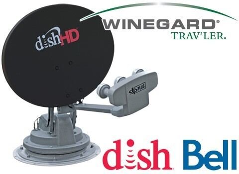

That is the area that I'm both positive and most concerned. I'm using the Winegard Travler. It automatically finds and locks in on the 110, 119, and 129 satellites, no problem. It functions without any regard as to what the receiver is doing, it just finds them and fine tunes them and it's all good. So, in that regard locking into the Satellites is positive. I'm a bit confused about using the Hopper as it seems that an internet connection is required. That can't happen.
So the Travler gets all 3 sats simultaneously without physically reorienting? That's good! Does it appear to your 211 as an SW64 (or something starting with SW)? If so, the Hopper can't deal with it.
The Travler is an autotune 1000.2. dish1000Web.jpg It works just like a Permanant mount 1000.2, just automatic.
As ziptied posted, the receiver just thinks its a regular HD 1000.2 dish. The fact that it does act the same is the main reason I chose that system. Almost EVERYTHING else moves the dish when you change channels.
Agree that looks very nice. If it has two (or three) DishProPlus cables coming out, you should be good to go with a Hopper and a solo (or dual) node in between.
