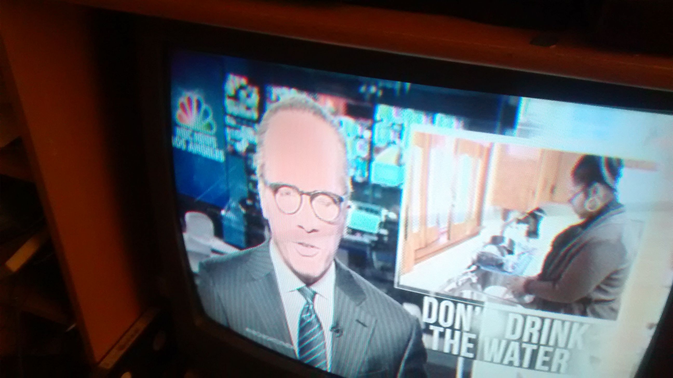

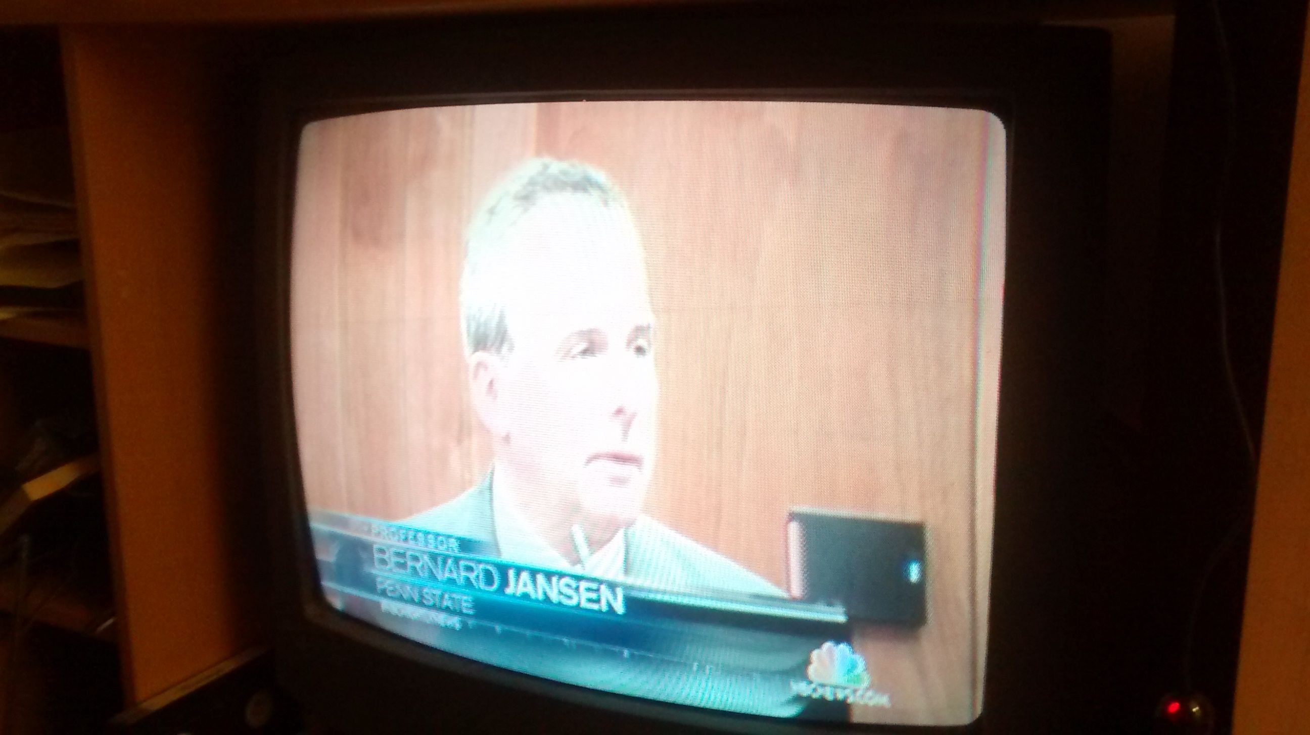

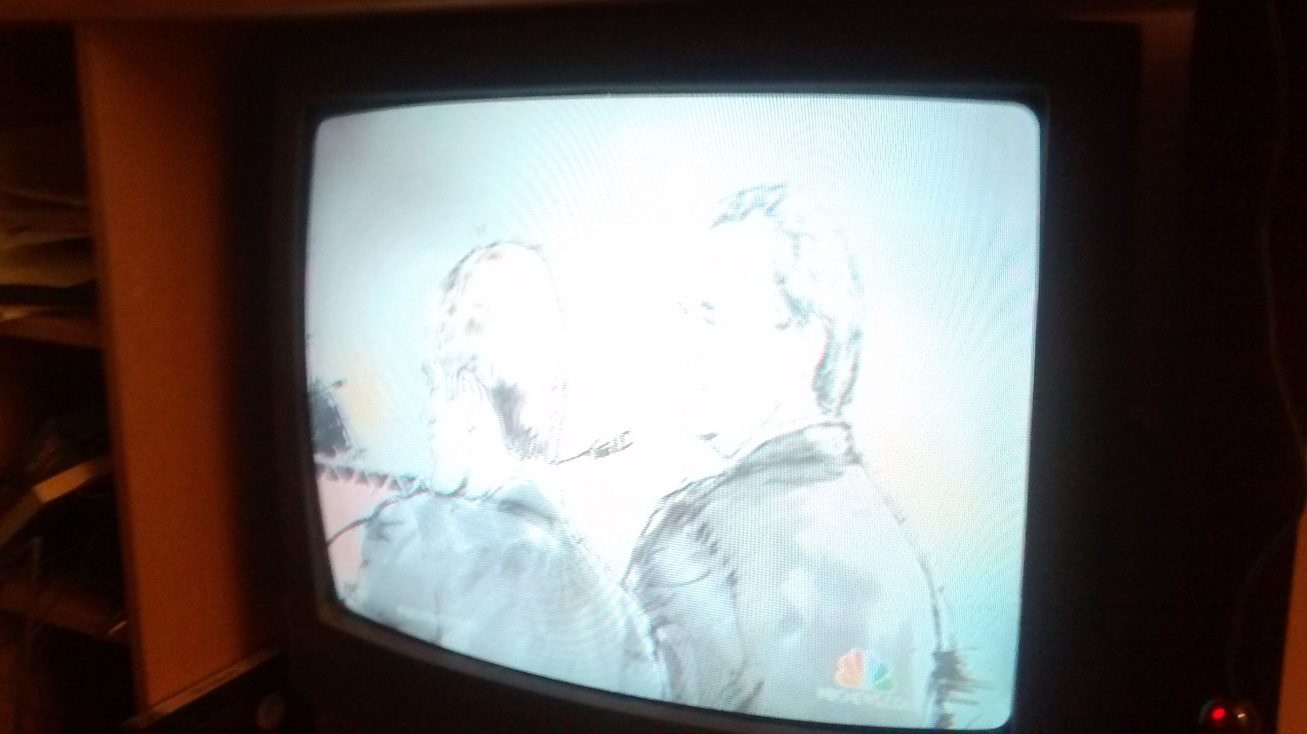

I have a video problem on mini and nano trying to figure out why is there problem with the white in the video. I adjusted my tv it does not help can anyone help?

Have you tried with a third source? Such as DVD or VCR player or media box?
On all channels?
What about OTA via TV tuner?
How is the receivers hooked up?
Yep that is what I was thinking also. :)
If two receivers are doing it and a third device like a vcr or dvd player is too, its new TV time.
Just try all the various inputs too.
Look on the bright side Dan, TVs are easy to replace, FTA receivers not so easy to replace these days.
Reactions: KE4EST
Looks like a mismatch between the STB output and the TV input. In the television production world, we would see something similar if the composite input to a monitor or other device was not terminated. Your TV probably doesn't have a termination selection switch, but the picture sure looks like it is seeing the too high of signal. The TV may be expecting lower amplitude signal and the STBs might be providing too high of signal for the TV to handle.
Are you using the same AV RCA breakout to connect each STB to the TV? Might be a defective cable or plug. Swap to a different cable?
Did you check the same TV input with a DVD player or other video source as KE4EST suggested?
Reduce the menu setting for the video output?
Install a resistor across the pin/shield (unknown value) would match the two components?
I worked on it I went into the menu had to turn down saturation, contrast, brightness on the receiver it helped. Hopefully that fixes it my tv works fine. I do like mini hd thanks guys for the help. Thanks Brian for good deal on the receiver.
