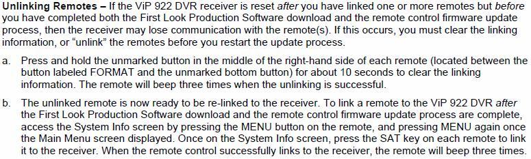

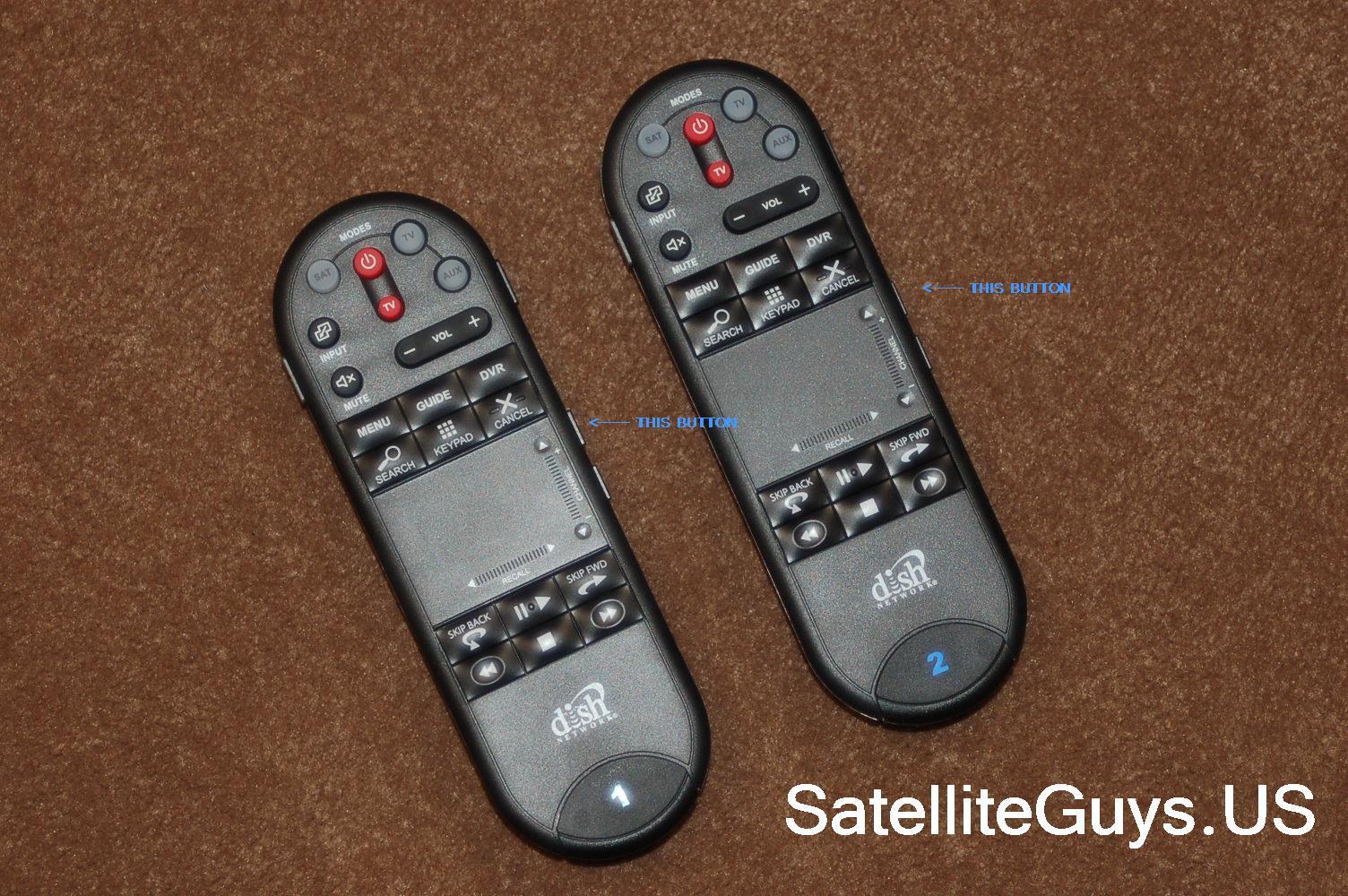

I did the exact thing you did. I didn't have the Job Aid at the time so I messed a few things up. Your remotes will not sync up because there are already synced. You need to unsync them. On the right side of the remote there are 3 buttons. The top button is the format button and the bottom 2 are blank. You want to hold in the blank button between the format button and the bottom blank button. Hold it in for 10 seconds I believe, it will beep at you telling you it is unsynced. Once that is done press the sat button again to sync the remote to your receiver.
Here you go, this is from the Job Aid... It was way down the bottom, they should move it up near when you link the remotes just incase there is an issue like yours...
Sherrman was yours in dual tuner mode as well? And was your Check Switch grayed out? I don't think you can turn off the dual mode at setup since nothing on the front panel works without the software download.

Yes. I had the exact same problem. Then we called Dish and thats how we found out about the job aid and that we had to email them. Went smoothly after that.
So how did they get your 922 out of Dual Mode so that you could do a check switch and download the code? or did it just work after you rebooted and repaired the remotes?
It just worked. When I went back the point dish screen I was able to do a switch check. Didn't take long after that. Then I put in my service request to have it activated. Monday morning they called me to check some info and within a half hour it was activated.
That worked thank you!
