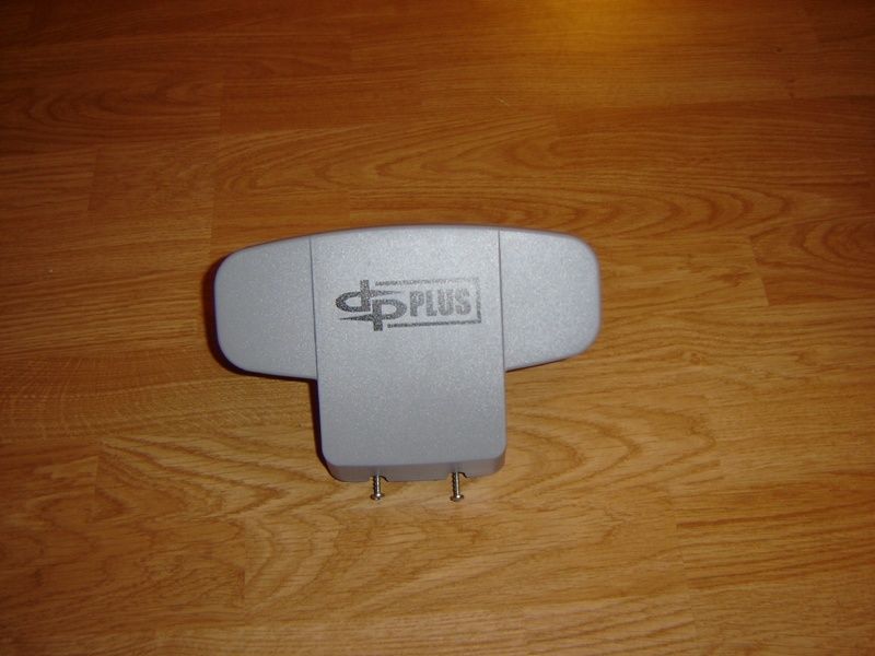

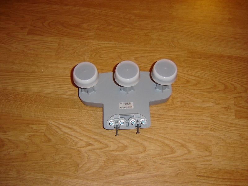

Actually the dish 1000.2 has a new DP Plus LNB that looks like the Directv one. I'll post a picture in a moment.
And you can find it here:
http://www.dishstore.net/product_info.php?cPath=38&products_id=292
