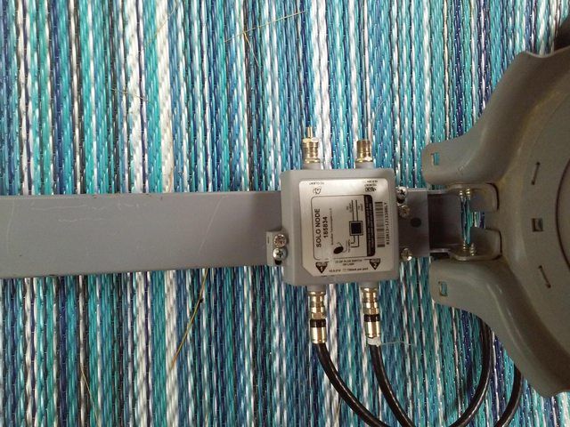

I only wanted a single wire running to our RV, so I installed the solo node on the dish arm. That allows me to remove the reflector when I stow the dish in a storage bin.
If you find you can't get a clear view of the western arc from your location, you can install an eastern arc LNB. I switch back and forth fairly often as we move around.
