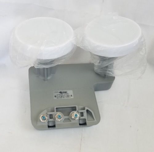

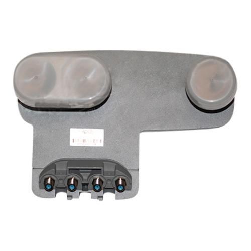

157092_zoom.jpg is this what i need. will i need to change arms for this to fit
View attachment 138056 View attachment 138056 is this what i need. will i need to change arms for this to fit
That's an LNB for a 1000.4 eastern arc dish. In order for you to use the pictured LNB you will need a 1000.4 dish.
You probably have a 1000.2 western arc dish now so you will need an eastern arc 1000.2 LNB. It gets 2 satellites which should get all of your channels.
