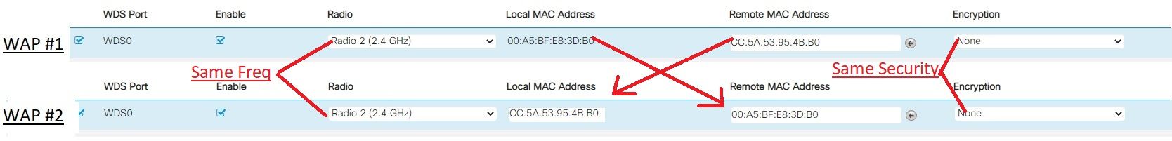

I used to set up wireless bridges all the time at work when we had some temporary work areas set up for special projects. I have no experience with EnGenius' networking products, but they make awesome rugged phones. :)
This is my writeup to my nitwit boss at the time in simple terms how to configure our Cisco SMB wireless access points, in case I was out of the office and he needed to set this up.
- Plug in WAP #1 into a switch that connected to network inside of main location and configure it, make sure to manually select a wireless channel to tx/rx on
- Plug in WAP #2 into a switch that connected to network inside of main location and configure it, make sure to manually select the same channel as you selected on WAP #1 wireless channel to tx/rx on
- Access GUI for WAP #1, find the Wireless Bridge option, enter MAC address of WAP #2
- Access GUI for WAP #2, find the Wireless Bridge option, enter MAC address of WAP #1
- Get a switch for secondary location, plug it into power
- Connect WAP #2 to that switch via ethernet
Vuh-la! That WAP is now providing wifi coverage in the secondary location, as well as providing an uplink for additional hardwired devices that are plugged in to that switch.
I had more of a vision of plugging in the church-side transceiver to the church switch and the hall-side transceiver into a switch or WAP in that facility. Getting Cisco involved in anything on this scale has a very high cost/benefit ratio for no practical advantage.
I wasn't suggesting Cisco, just using them as example since that's what I am familiar with from work and home. The WAP581s I have aren't really that expensive, we paid around $200 for them, but here they are not correct for the use case. Outdoor rated and long range is what is needed, and if EnGenius' networking hardware is anything like their portable phones, it should be they out perform expectations.
I have never used their networking hardware before, I have no idea you can set them up using a traditional web interface, or if it's some 'cloud' crap. In the event you set it up via a traditional web based GUI running on an internal web server, setting up a wireless bridge between two APs is very easy no matter the brand. That was my point. Enable it, place both on the same channel, enter each others MAC address and done.
