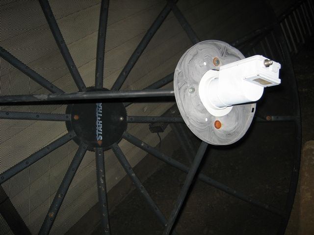

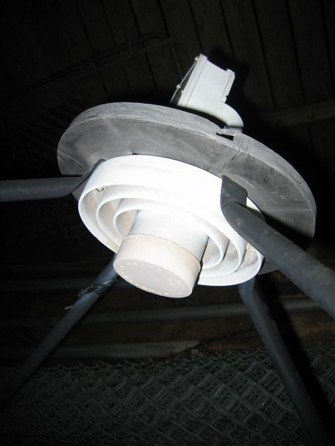

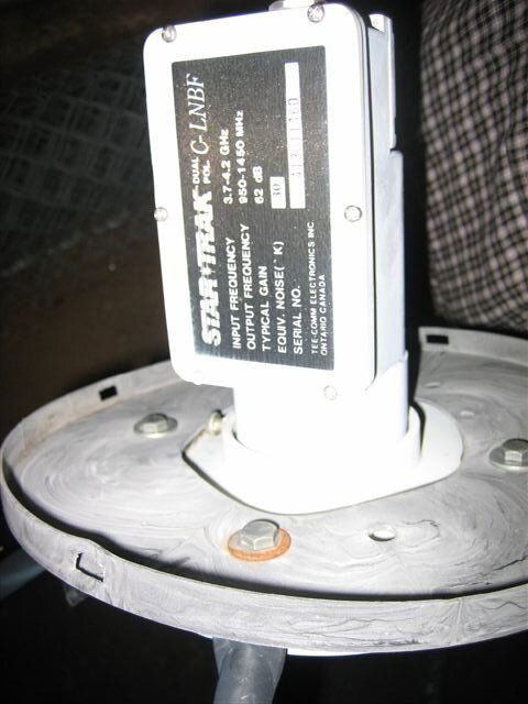

Here is a couple pics of the LNB and dish, does say dual polarity.
I have loosened the lnb and moved it around, so not sure if I will absolutely need to re-adjust anything.
Its also missing the feedhorn cover.
Can anyone describe to me what each of the parts are? Is anything missing, I don't really know what part of this is the feedhorn. I have been around broadband C-band dishes plenty and can easily spot the feedhorn, but those dishes are nowhere near like these ones....thoughts??

Feedhorn is the part with the rings in it-pointed toward the dish. It collects the signal that the dish reflects and focuses toward it, and the lnb part of it (part with the label on it) amplifies that signal, passes it to the receiver.

that bolt you loosen is the settings for the lnb. . .
you may hav offset the focal distance of the lnb, this is how much of the dish it sees (in other words) and the if you also rotated it inside of the feed that will offset the skew, since yours dont carry a servo its basically setup like and lnbf (think i saw "dual pol" marked on yours)
if you are lucky you should be able to see the old marks to reset the focal distance. . .settin the lnb you can do when you set up and ready to go. . .adjust for MAX quality.

this looks like a lnbf a lnbf is a lnb & feedhorn built together it slides into the scaler
when alinged it almost always sits flush with the other rings of the scaler so it might need to go out a inch or two if its been moved in...

Well, the C2 is still an okay idea, but that LNBF you have is fairly less common on an old dish.
It'll probably work...?...
You'll need to get it twisted for skew, moved in/out for proper focus, and of course, aim the dish. :)

The disc with the rings on it is the scalar, the tube through it is the feedhorn, and while you'd normally have a bolt-on LNB, yours is fixed-mounted onto the feedhorn permanently.
The C2 has the feedhorn with permanently attached LNBs, too.
