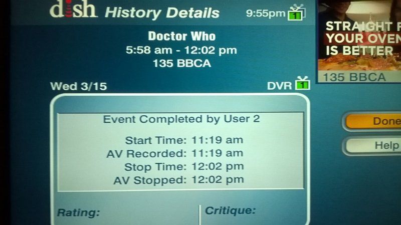

Have I been bitten by rhe bug? Last night I set a manual timer to record a 6-hour block of Doctpr Who. Everything showed up nornally in the DVR schedule before I went to bed, but the history (and the subsequent recording) shows that only 43 minutes were recorded. I can't imagine that any of the guide data bugs would affect a manual timer, since it is just channel, start and stop time.
