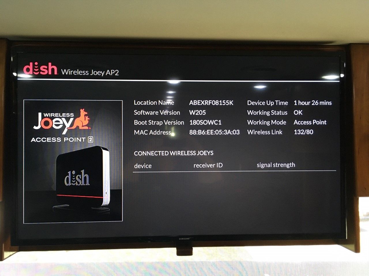

Followed all the install instructions and in the end the Wireless Joey (WJ) isn't showing under the Wireless Access Point 2 (WAP-2) as connected. I've pressed Select on the WJ and the WPS on the WAP-2 and nothing. I had the WAP & WJ 30' apart and in direct view of each other. One of these units has an problem but which one? Thanks

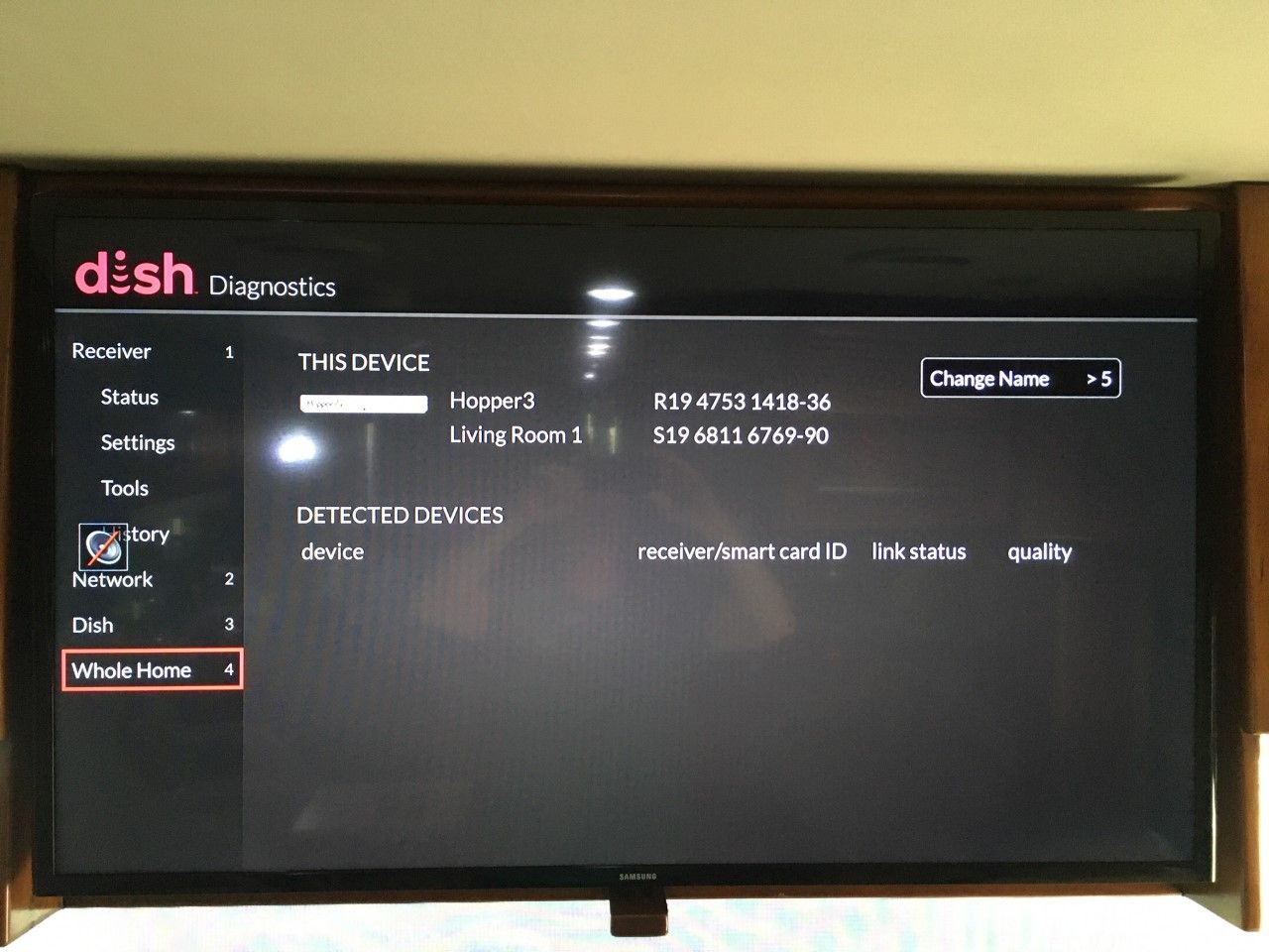

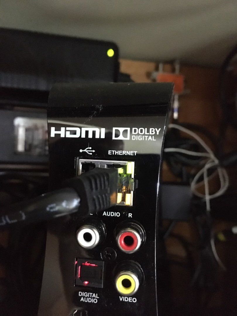

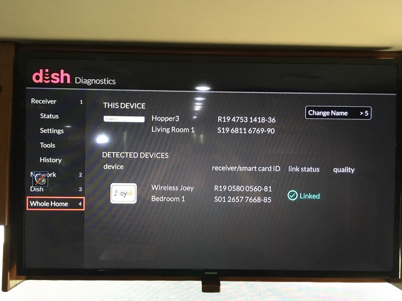

The Wireless Joey (WJ) showed up in the Whole Home Screen. The only indication I can see that it's downloading is the indicator light for the ethernet jack. I'm assuming the top green light indicates connected and the blinking lower amber light means it's transmitting data?

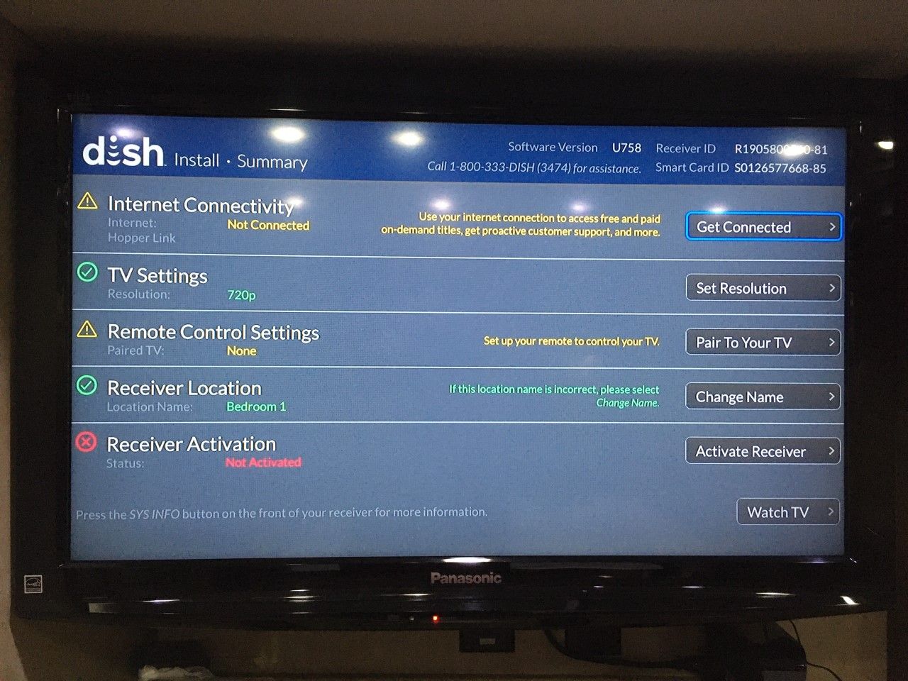

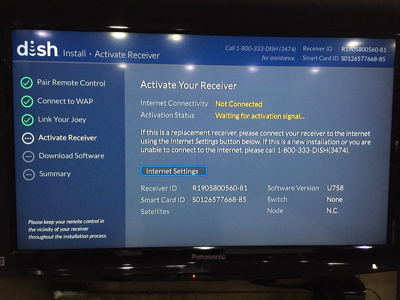

I did what HipKat suggested and got further into the install. But it stopped at waiting for the activation signal. Called Dish and they tried to send an activation signal that never got here??? I've attached the screen shots from the Wireless Joey. Any suggestions? Thanks
I did what HipKat suggested and got further into the install. But it stopped at waiting for the activation signal. Called Dish and they tried to send an activation signal that never got here??? I've attached the screen shots from the Wireless Joey. Any suggestions? ThanksView attachment 143377View attachment 143378
What I can tell your receiver is not connected to the internet, go into network to check this.
You did right. Activation comes from the Hopper so here, I would replace the WiFi Joey to the permanent spot, plug the WAP back into the Hopper, go into Networking settings on the Joey and press select, then WPDS on the WAP and see if it connects

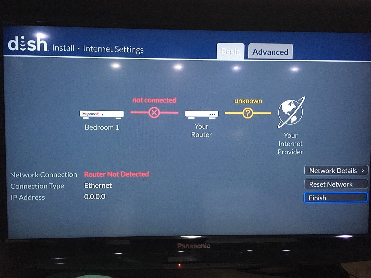

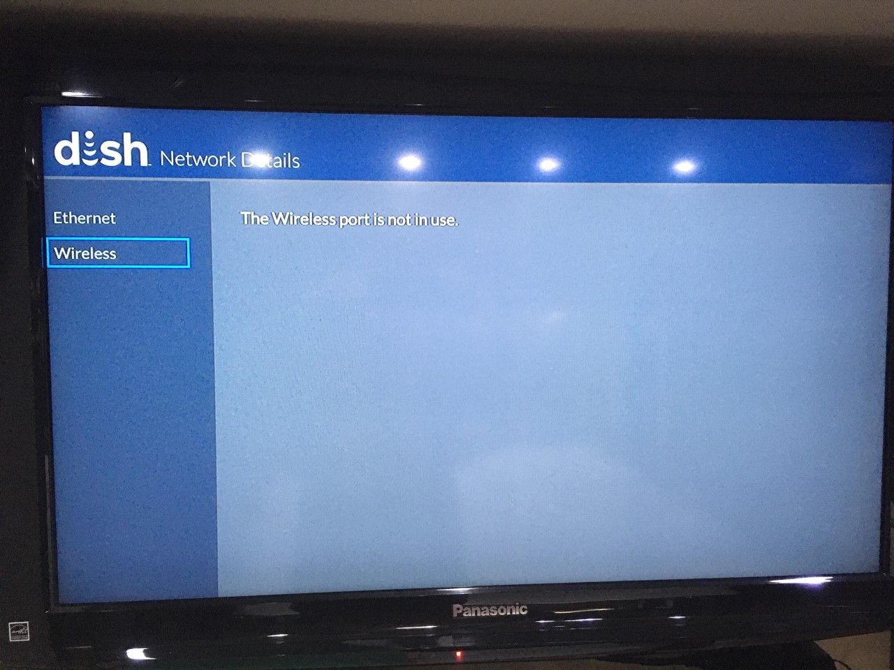

The Wireless Joey has a "Select" button on the front. When I pressed that I got a new menu showing the Joey the WAP and the internet (which I don't have). On the lower Left it says Router Not Detected and below that it says "Connection Type - Ethernet"? Thought I was Wireless? I click on Network Details and see I could choose Ethernet or Wireless but it doesn't change to wireless. So I select Reset Network and nothing. So I pressed Select on the WJ and then WPS on the WAP to see if it will connect. Nope......

So I selected "Reset Network" at the WJ and it returned message 1229 that "Joey has successfully configured the network" Still not seeing it under the WAP in the Dish Diagnostics. Decided to hard reset the system. Restarted the Hopper & WAP then the WJ. Hummm I think that is only the Internet Connection. So in the end pressing Select on WJ and then WPS on the WAP did nothing.
Unplug your receiver your WAP and your WJ, Disconnect your ethernet cable from your WAP--plugin your receiver let it boot to live tv--plug in your WAP DO NOT plug in ethernet cable in yet there is a reset hole on the back of the WAP use a paper clip in the hole to reset watch the lights on the front will flash wait a couple of minutes then plug in the ethernet cable--wait a hour then plug in the WJ and try to connect. Let me know if it works
Unplugged everything. Powered up Hopper to Live TV. Plugged in WAP with ethernet unplugged. Pressed the reset on the back of the WAP. The top green power light flashed for some time then went solid. Plugged in the ethernet cable and the bottom blue network light came on. The center orange light for the WiFi did nothing and has never been on solid. Now I'm waiting the hour to plug the WJ back in. From other troubleshooting activities the WAP Orange WiFi has only come on flashing when I pressed the Select Button on the WJ and then the WPS button on the WAP. It flashes for a while and goes out?
