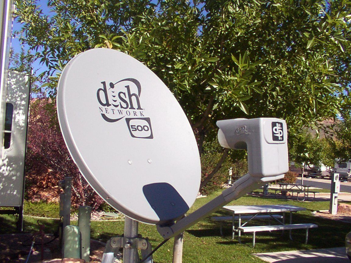

New installation: 119 good, no 110
Iceberg said:
if they are the same angles, then skew is 90 (straight across)
The skew angle from the screen is 92
Iceberg said:
Try Simon's tinfoil thing. Cover the right part of the "eye" (this is if you are looking from behind the dish...119 is on the left and 110 is on the right (due to the bounce off the dish)
I'll give it a shot. My wife is getting frustrated when I work on it; many channels seem to work fine on 119W but there are more that we should have. Would they be broadcast on 110W?
Iceberg said:
no. They're on 119 or 110
I think you agree with me; we have some channels but not others.
Iceberg said:
I dont know if this has been asked but once you get 119, did you do a check switch?
Yes, several checks, but I either have no 110W or wrong satellite (119W with 110W selected.)
So lets see if I can backtrack here…I'm going to ask a few questions (they probably have been answered already)
You get some channels, but not all? Do you get Channel 101?
This was working before?
The skew on the dish is set at 92? (per your post above)
When you aim the dish, the screen says "Dish 119" and the bar is green?
You've run check switch so we got that…
What happens once you get 119 and you change in the setup screen to 110?
You're not trying to use a DishPro LNB with a Legacy receiver?
WakeBdr said:
Sorry I don't have anything useful to add, but I had this same problem last weekend at my tailgate. I could pick up 119 and 129, but never got 110 to come in. Even though, I picked up 119 and 110 the night before at my house in 5 minutes, I couldn't get it at my tailgate.
Think about it.
If you're getting 119/129 instead of 110/119 might you be aimed 9-10 degrees too far west? :cool:
Why don't people listen?
Cover the damn 110 eye with foil, attach the receiver to the cable under the 119 eye, and move the dish until you have 119. If you are plumb and have set the skew for your location, 110 will magically :rolleyes: appear when you remove the foil and run check switch.
Yes on 101
Yes, in Oklahoma, then packed up and set up here in Utah.
Yes
Yes, I can get >100 on the bar, and it says locked.
It says wrong satellite, 119W with high numbers OR nothing. RED
No, this is new stuff from installer (early Sept.), 311 receiver 500 antenna.
