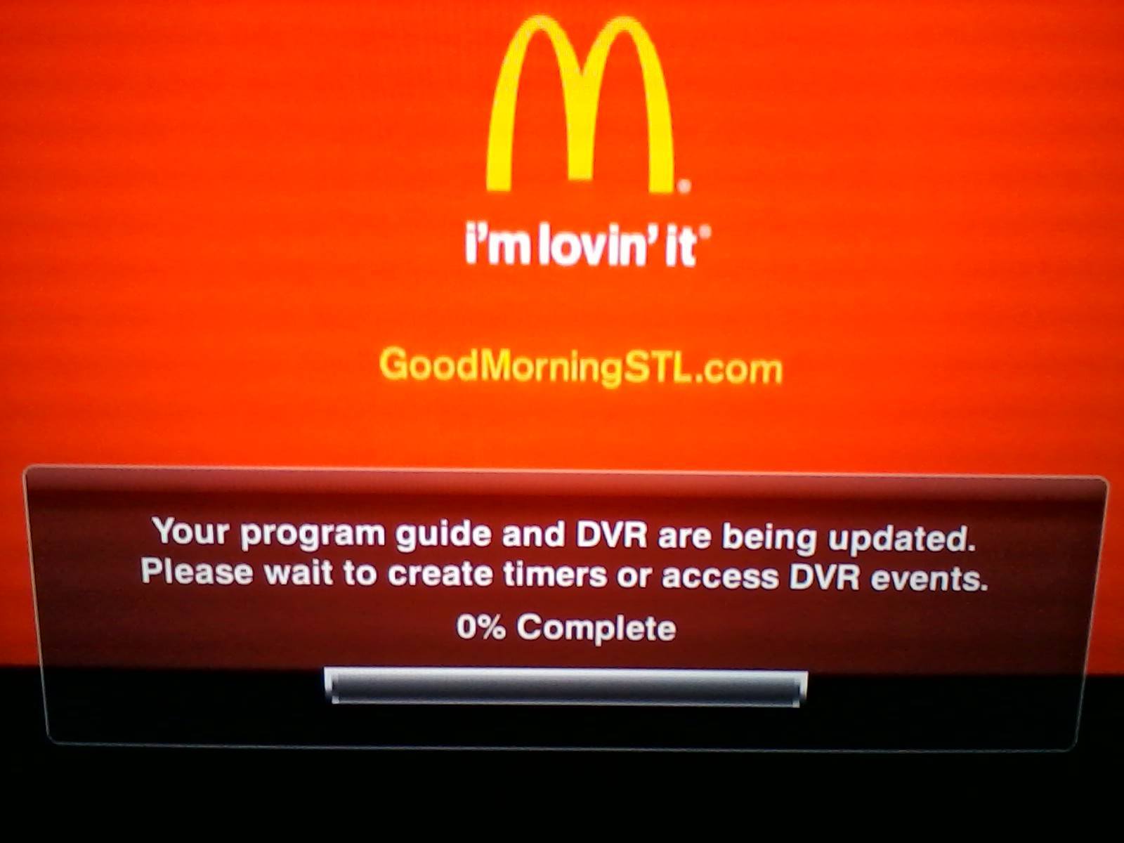

Came back up with the "Hopper with Sling Starting Up . . ." message, and then it reset itself. So I tried the un-plug/re-plug reset, and actually left it unplugged for quite a while. Went through the Start Up messages, then I saw this 0610140840-00.jpg

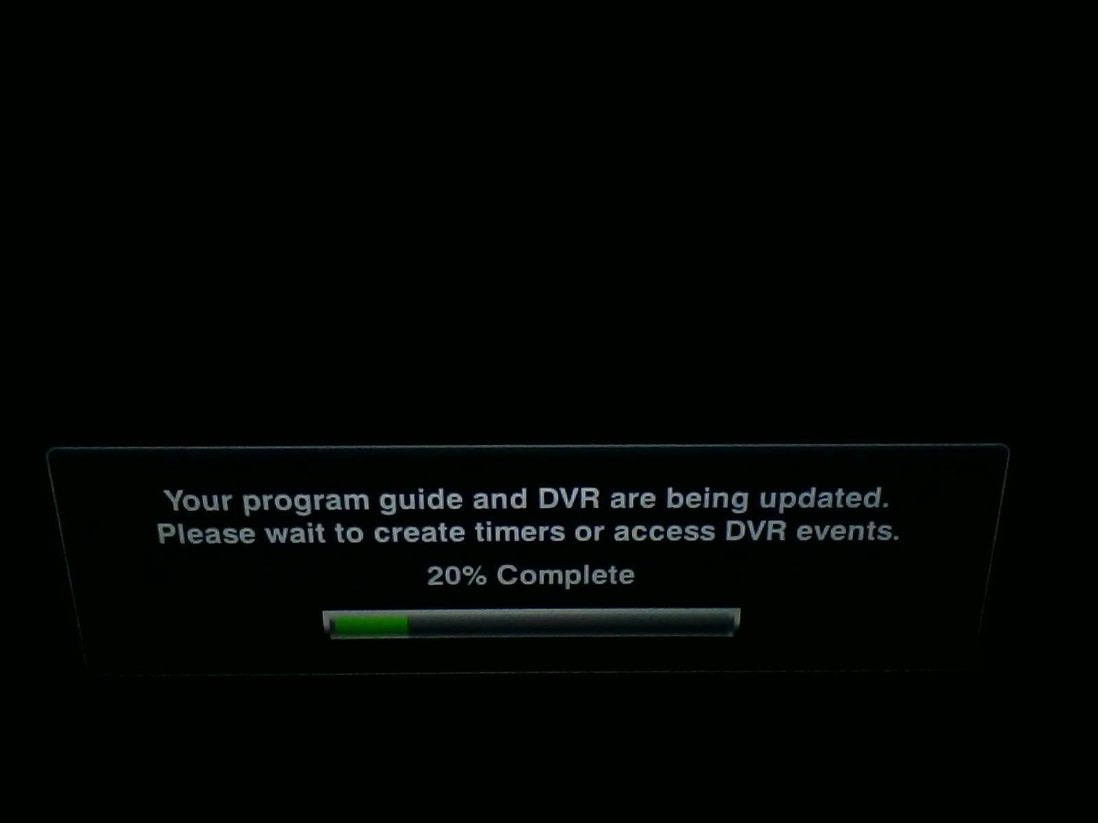

Don't remember ever seeing that one before. Of course it started at 0%, but after it had been at 20% for some time, the receiver reset again. After that reset, I finally had a picture from my local Fox network, but still had the message overlaying the screen 0610140838-00.jpg
I experienced a few more resets as it reached 20%, then it finally went farther - I think as far as 70% - before resetting. As I type, the screen just froze, but it just jumped to 95%. Aaaand, it just went blank. And reset again.

I've seen that on my Hopper too. It's a new feature and I believe it shows up when a software update is downloading to the hard drive.
That message has been there as far back as I can remember. I remember when I first installed my Hoppers how it would get stuck on 95% until a reboot.
The (frequent) random reboots are not normal, though.

The message noted above may be a "feature", but the accompanying behavior certainly is not. Along with the frequent re-boots, some of the menu screens (like Point Dish) don't completely load, and most responses to the remote are taking from several seconds up to minutes to happen. I had a long chat with tech support yesterday, and he concluded that I need a new Hopper. I've sent a message off to DIRT Zach in hopes that he can help me figure a way to off-load at least some of my recordings, as I would really hate to lose them all.
