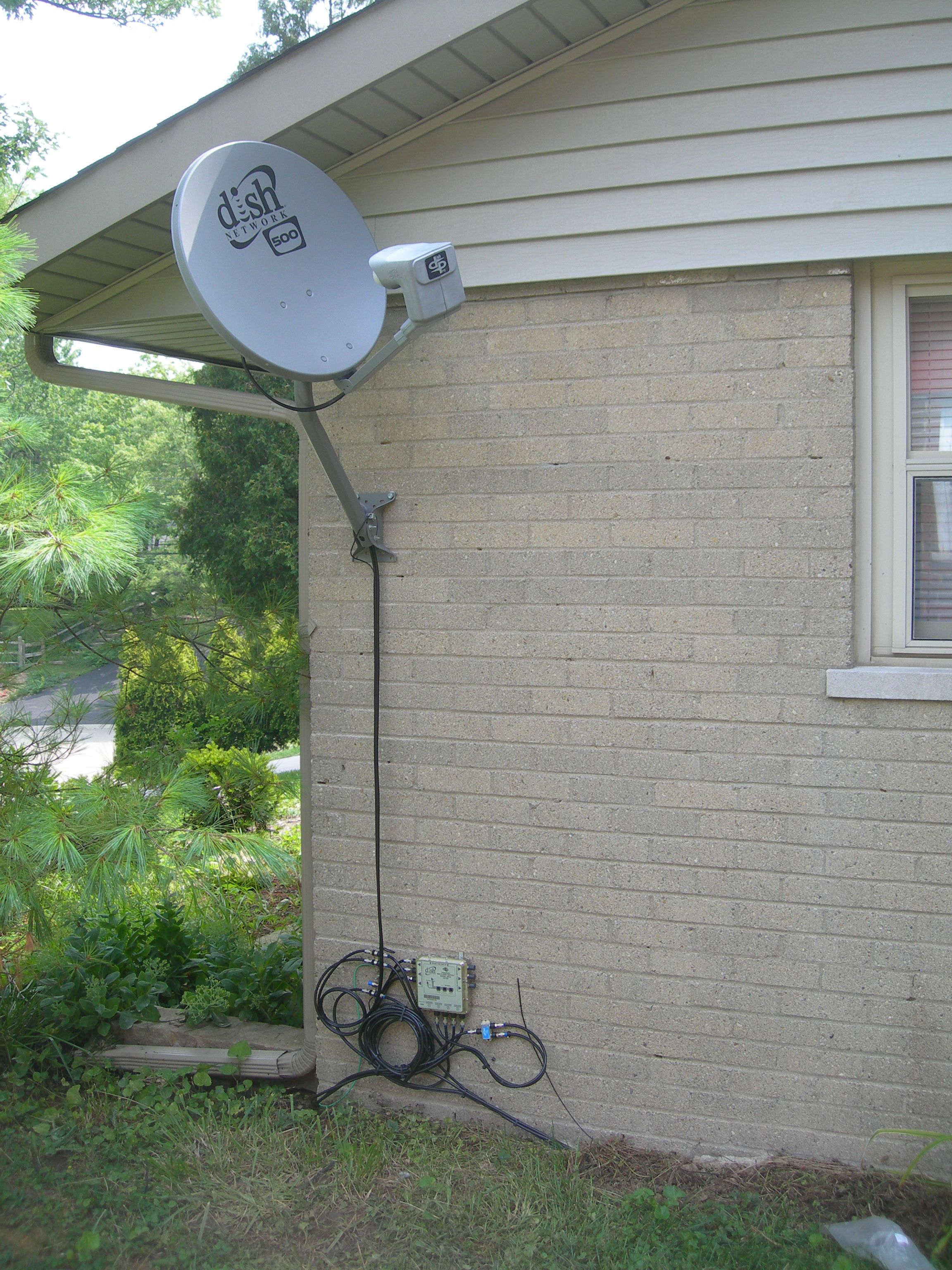

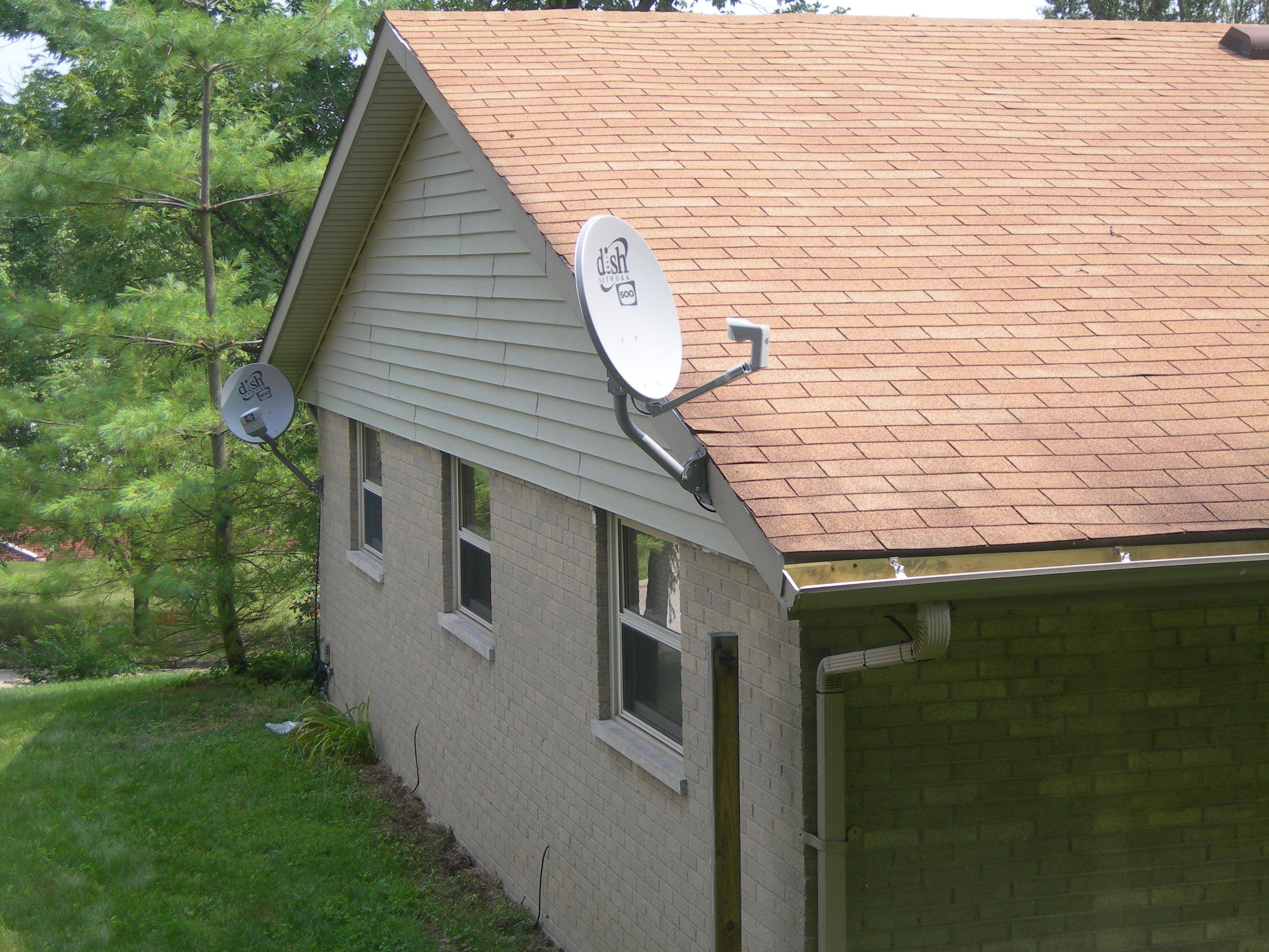

they did install 2 dishes, one is pointing kinda south (same way the direct tv one was pointed) the 2nd dish is the opposite way, my neighbors son told me the second dish is the HD dish and it has 1 cable coming out of it,
Is the HD dish cable supposed to run back to the other dish? there is 1 cable coming from the HD dish and than 2 coming out of the other dish

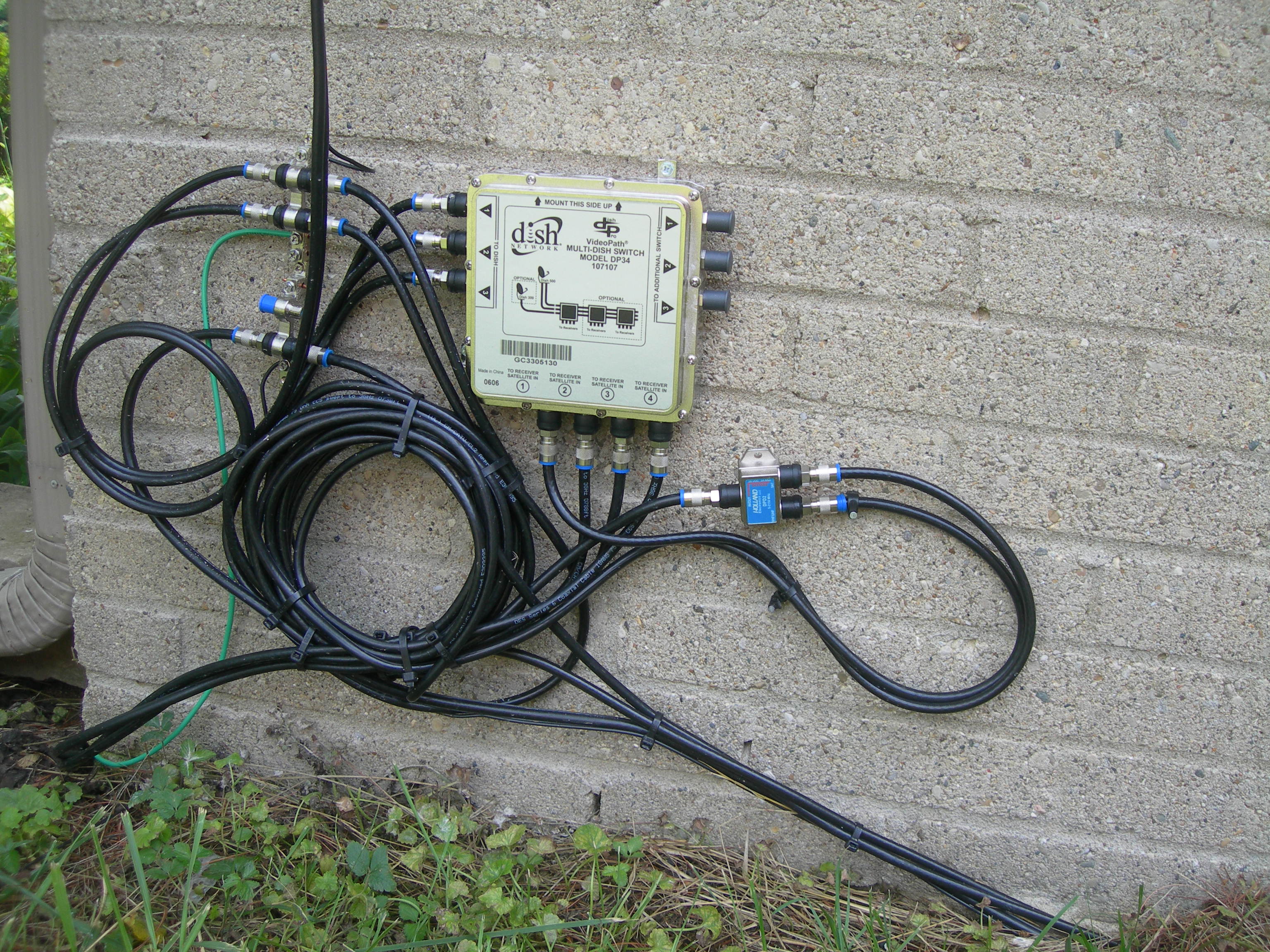

there is no multiswitch just splitters, I also read in the receiver manual that they are not supposed to use old cable tv or direct tv coax, which was done here, how much does that matter?
forgot, HD/DVR receiver is 722, Sd receiver is a 322
There HAS to be a switch otherwise it wouldn't work. A switch does just what is sounds like it does. When you tune in a channel on the receiver, the receiver knows which satellite and transponder the channel is on and commands the switch to select the proper LNB (Dish) and polarity.
The one cable from the dish pointing southeast (61.5° HD programming mostily, other stuff there too) combines with the two cables with the dish pointing southwest (110°/119°). (It could be integrated with the LNB on the 110°/119° dish. From the switch, one or even two cables run to each receiver so the receiver can "see" the satellites.
The receivers have to feed your TV2s as well. So there is cable that runs from each receiver to each of their respective TV2s. These cables running to TV2 COULD be combined with your regular cableTV cable using things that LOOK like splitters, but are actually diplexers. These combine and then split the signals in such a way that they do not interfere with the cable channels like a standard splitter would.

Sounds like you have a DPP lnb that has a in port so the one dish is picking up 110/119 and the other is picking up 61.5 that dish feeds into the other dish and the DPP lnb acts like the switch and combines 110/119/61.5 to one line.
I don't have any "switch" that's the same as a multiswitch correct? either way I don't have one. Like I said there is 1 cable coming from the HD dish that runs to the SD dish ( I dug it up and followed it), from the SD dish there are 2 cables that come out thru the wall of my shed, (the same 2 that were used for my direct tv), the installer didn't even go in the shed so I know he didn't do anything in there, from the dish the 2 cables (1 white 1 black) go under my trailer to a ground block (with no ground), from there the 2 cables go to a bunch of diplexers.
"Sounds like you have a DPP lnb"
I'm very new to Dish I don't know what this is
that's probably what I have than, thanks for all the info so far, I'll have more questions I'm sure, hope you all can put up with me.
