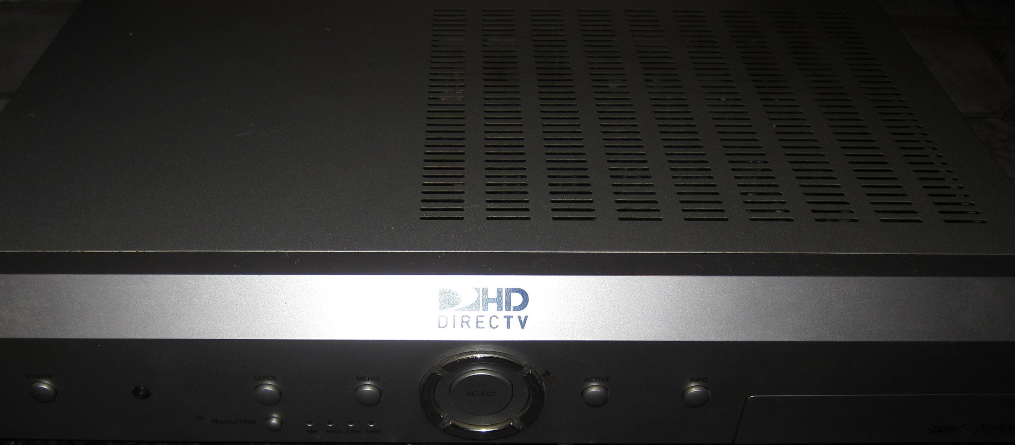

I have had the same receiver for years. This one:

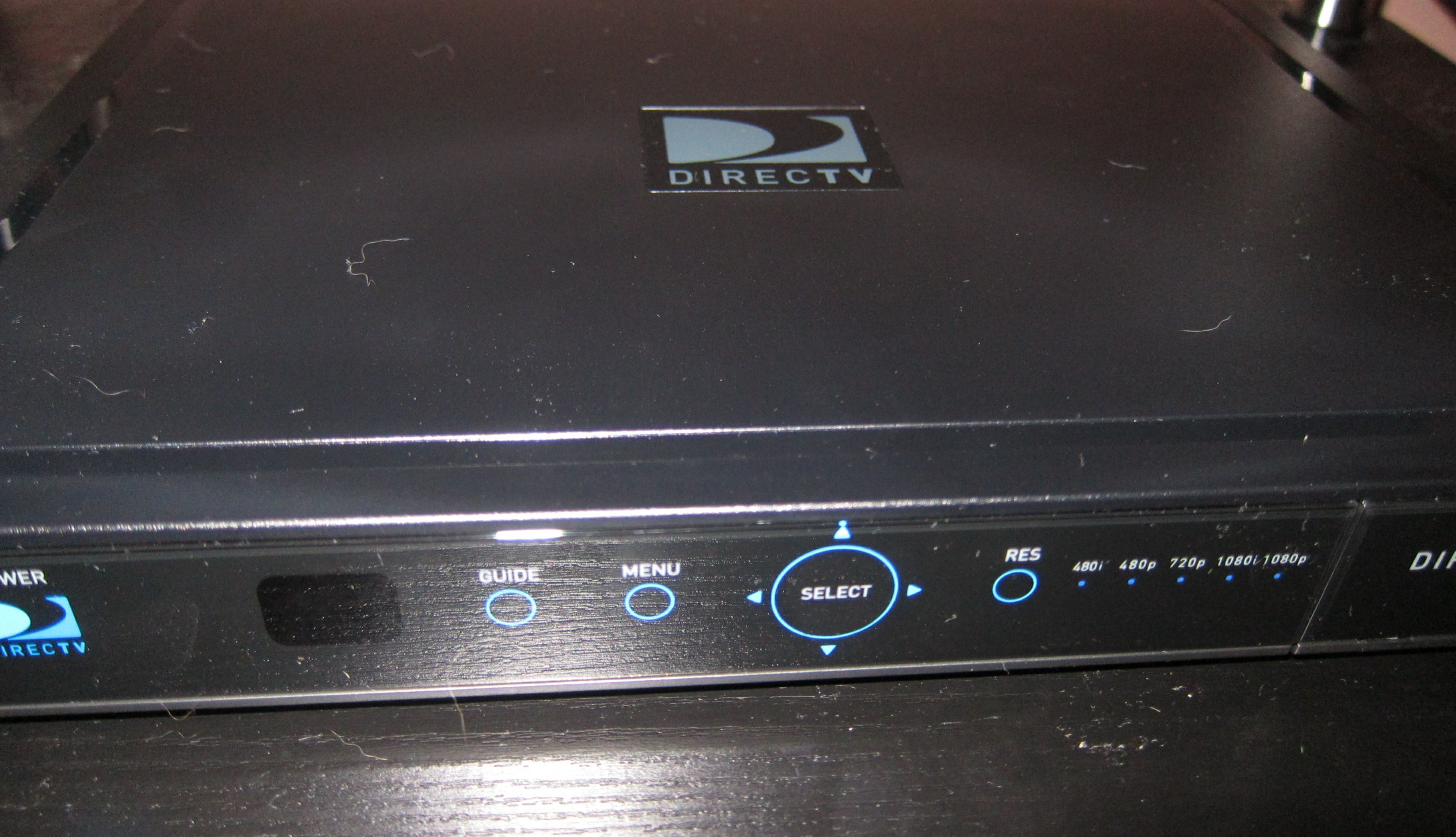

It recently stopped working completely, it was really old. Anyway, I contacted them and they sent me a new receiver, which arrived in a couple of days, this one:

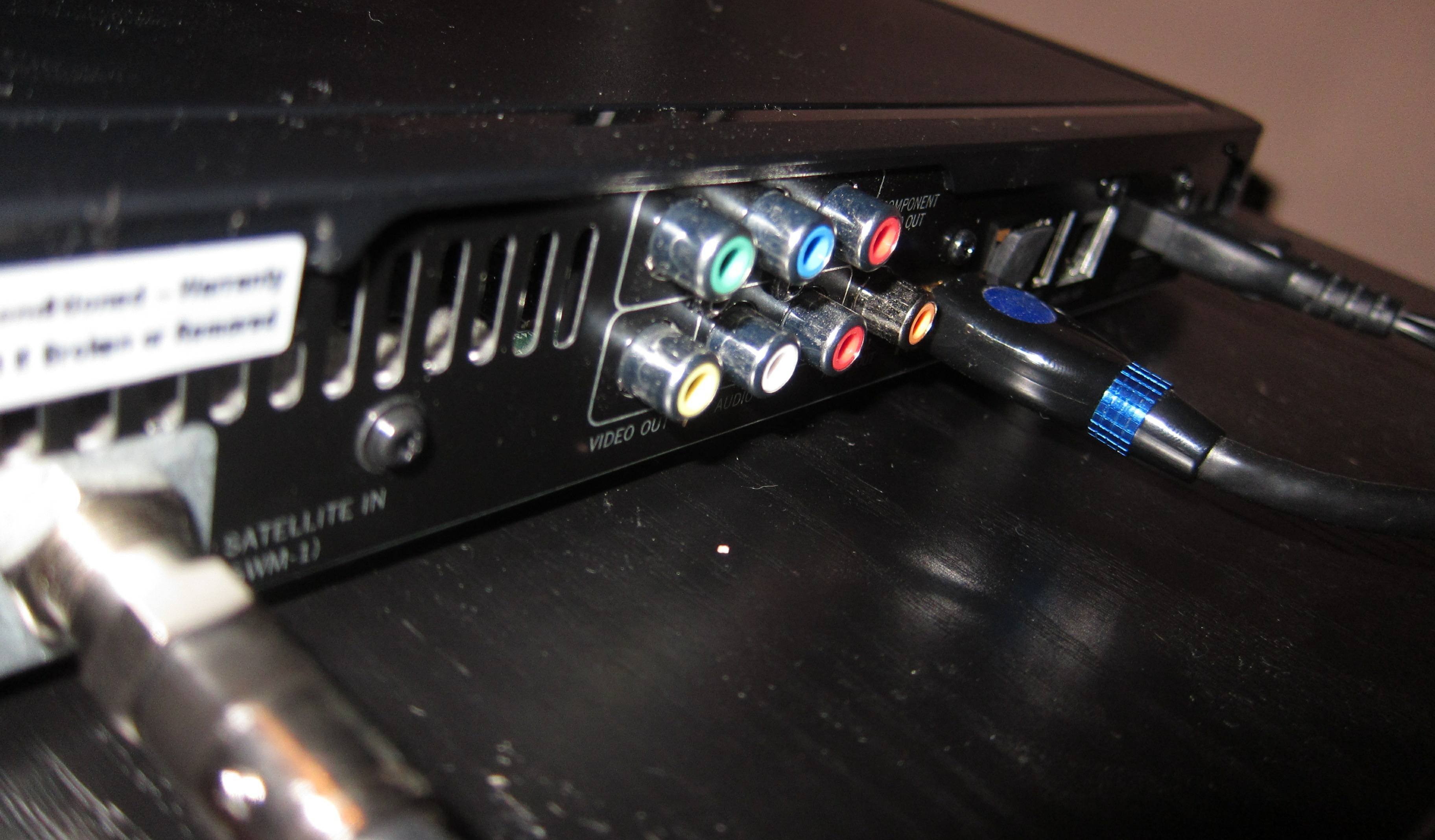

I hooked everything up exactly as it was with the old one. The DTV guy came and professionally installed the dish on the roof and ran all the correct cables. All I did was swap out receivers. This is how it is all hooked up:

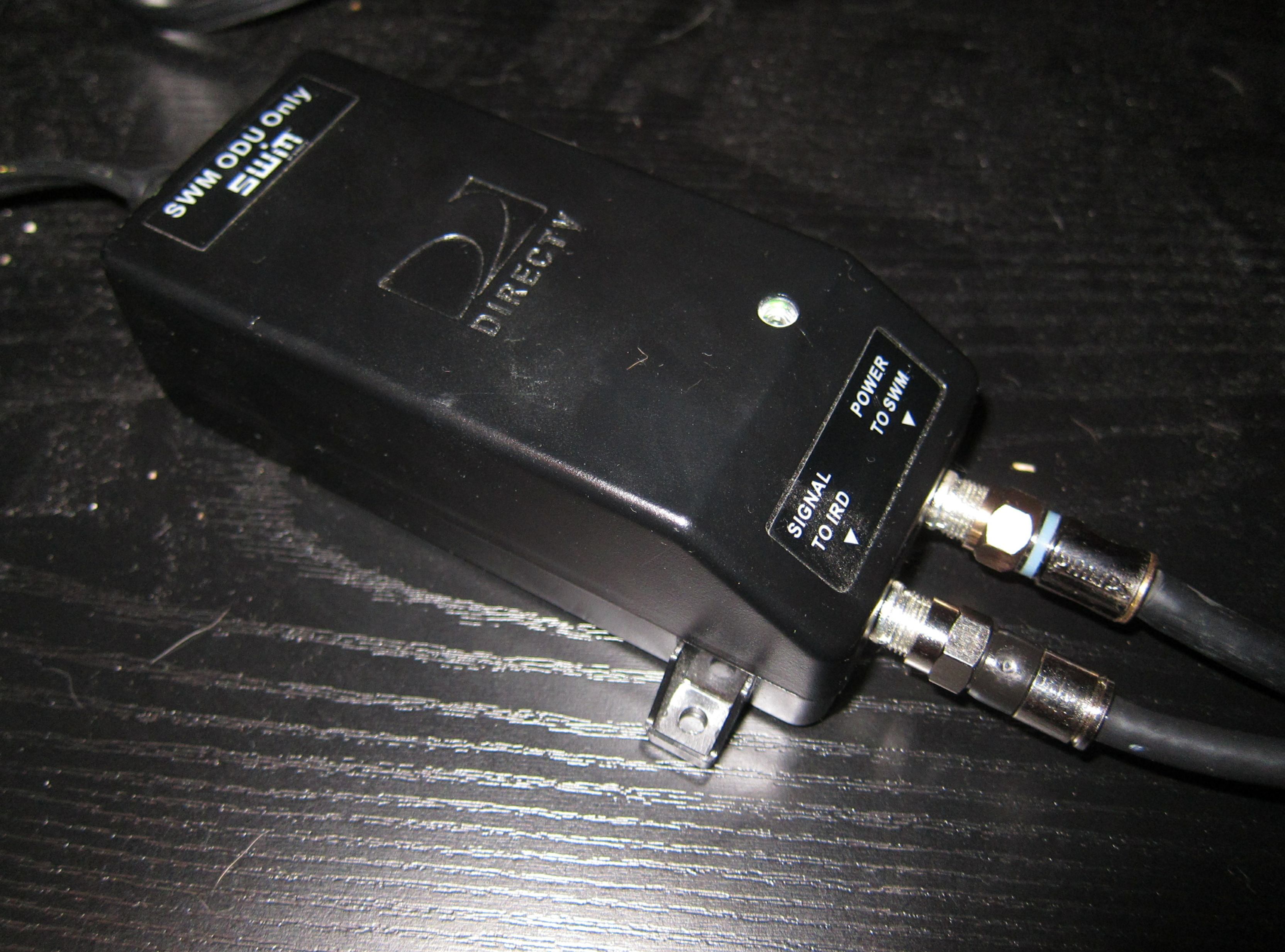

The old receiver also was hooked up to one of these, which the new one is also:

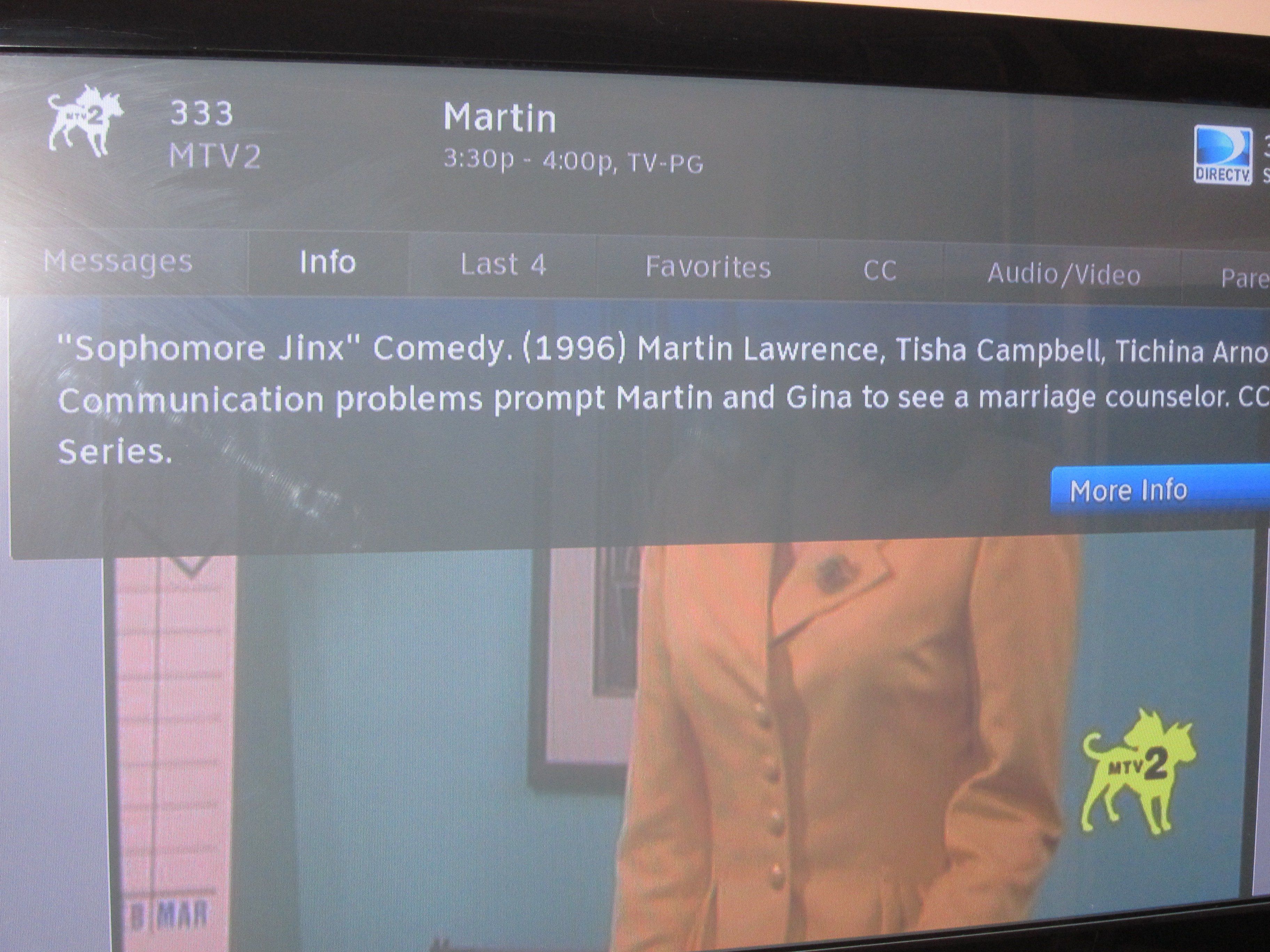

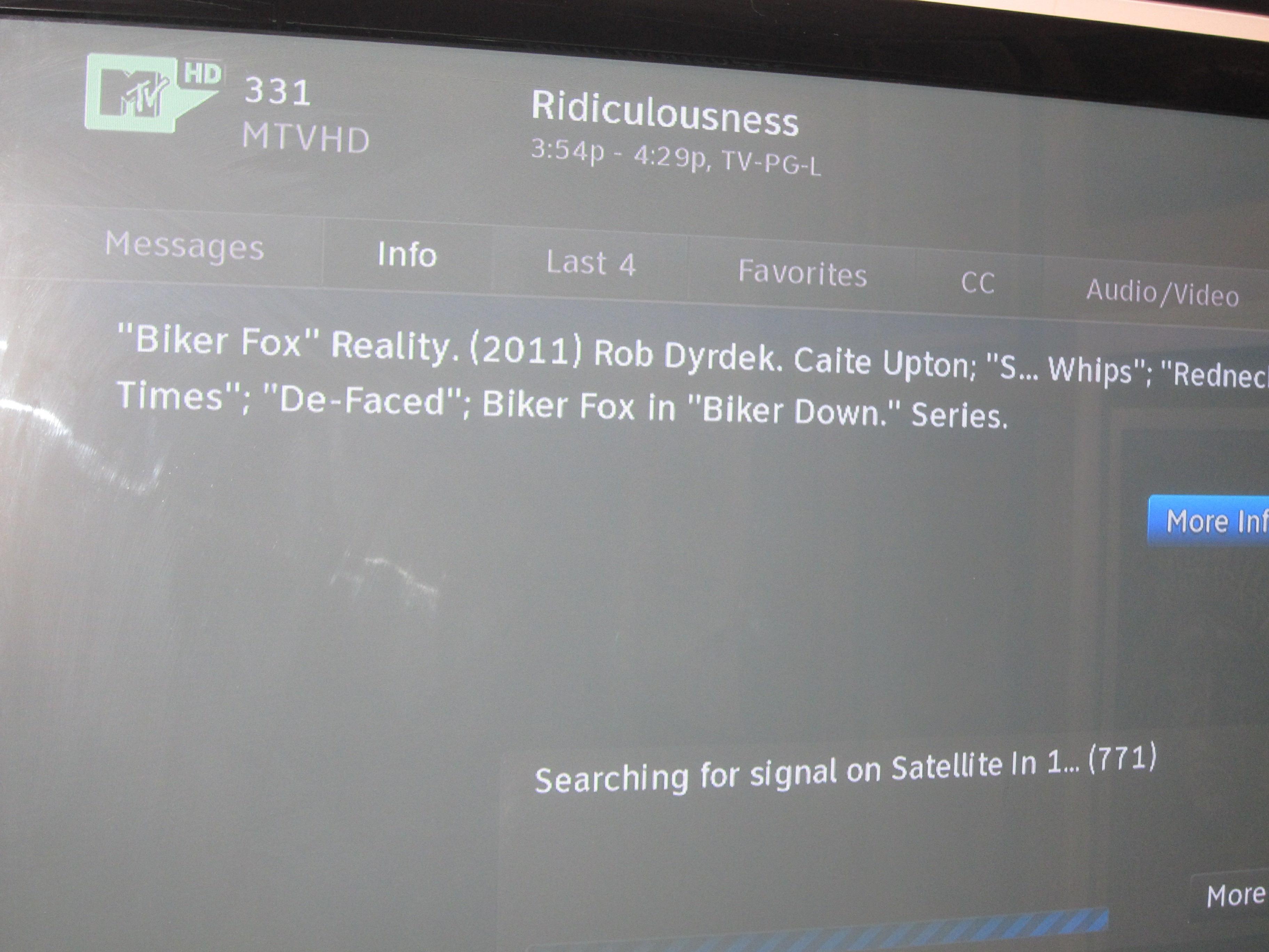

The HD Channels give me this error:
I have reset and redone everything numerous times, I even had the them reauthorize a couple times and still nothing. Same error message. I am getting frustrated. I have called and they were little to no help, telling me just to "Reset the receiver" which I explained to them I had done numerous times.

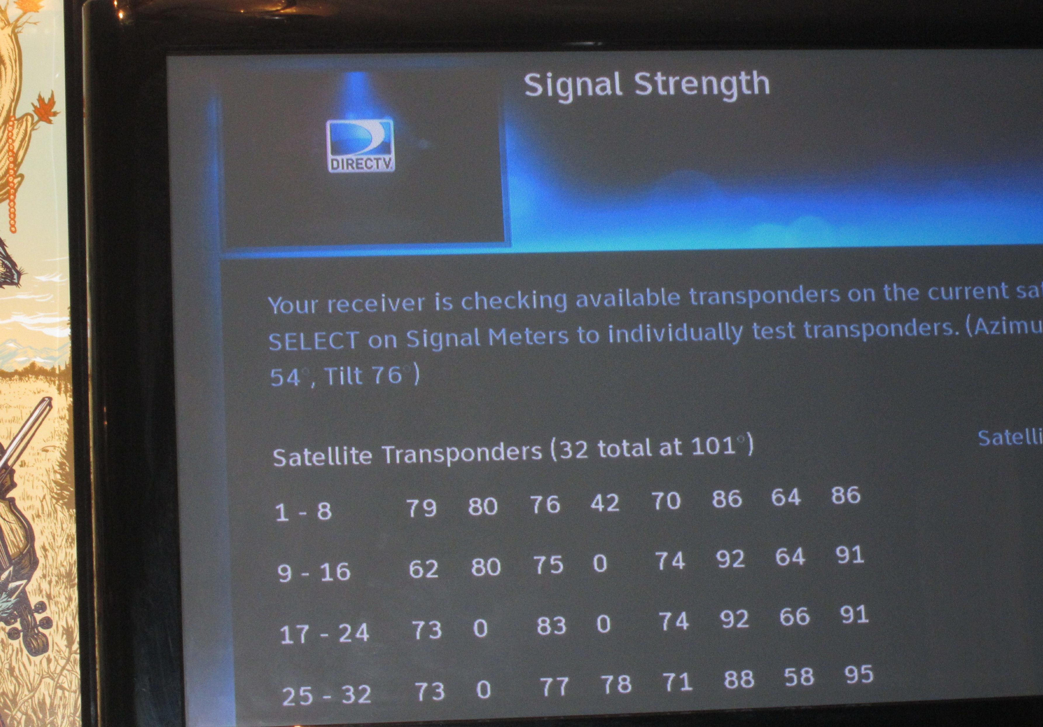

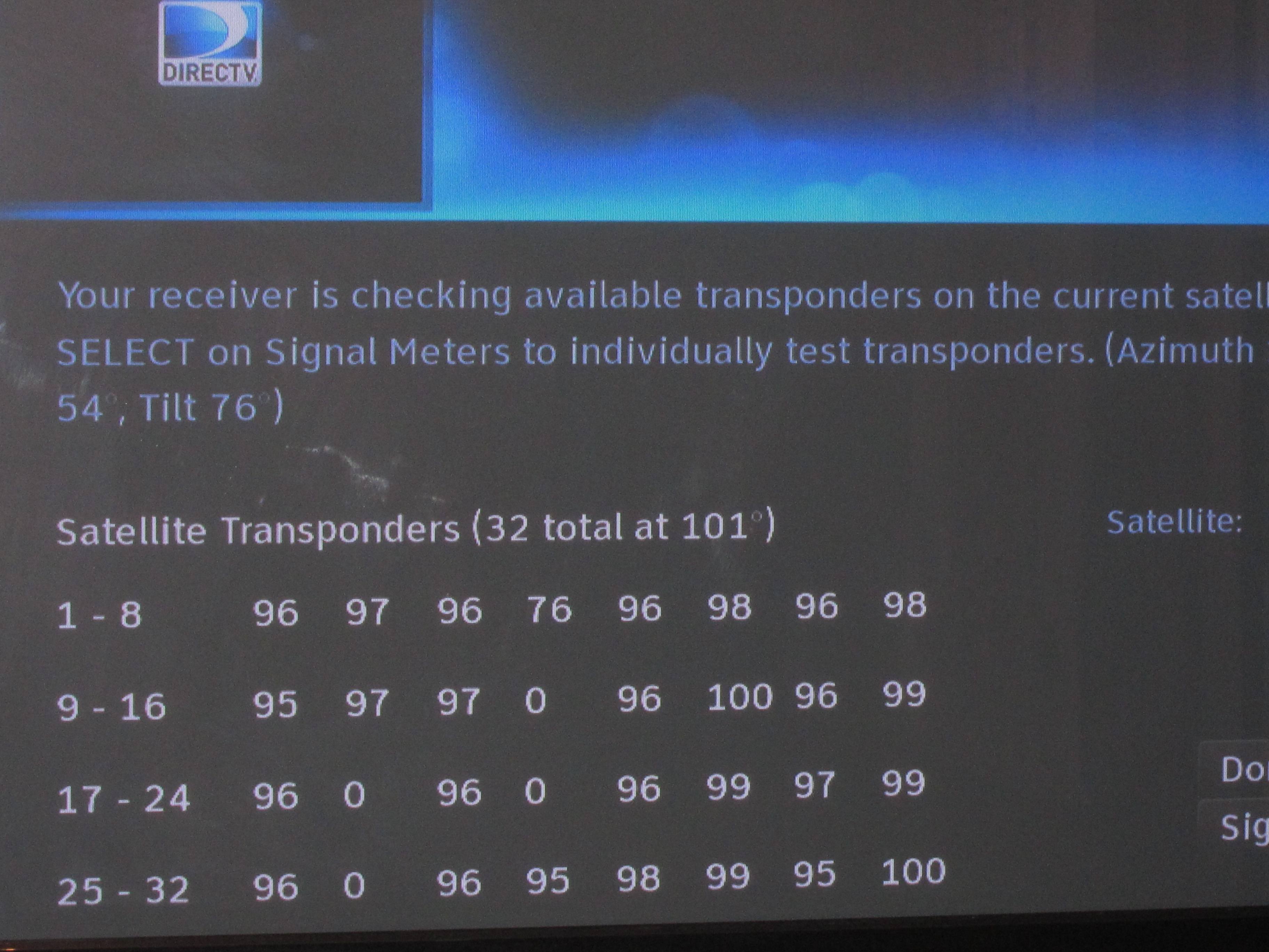

I am no satellite expert by any means, but I figured this info might also be useful for my problem. This is the Signal Strength test I ran:

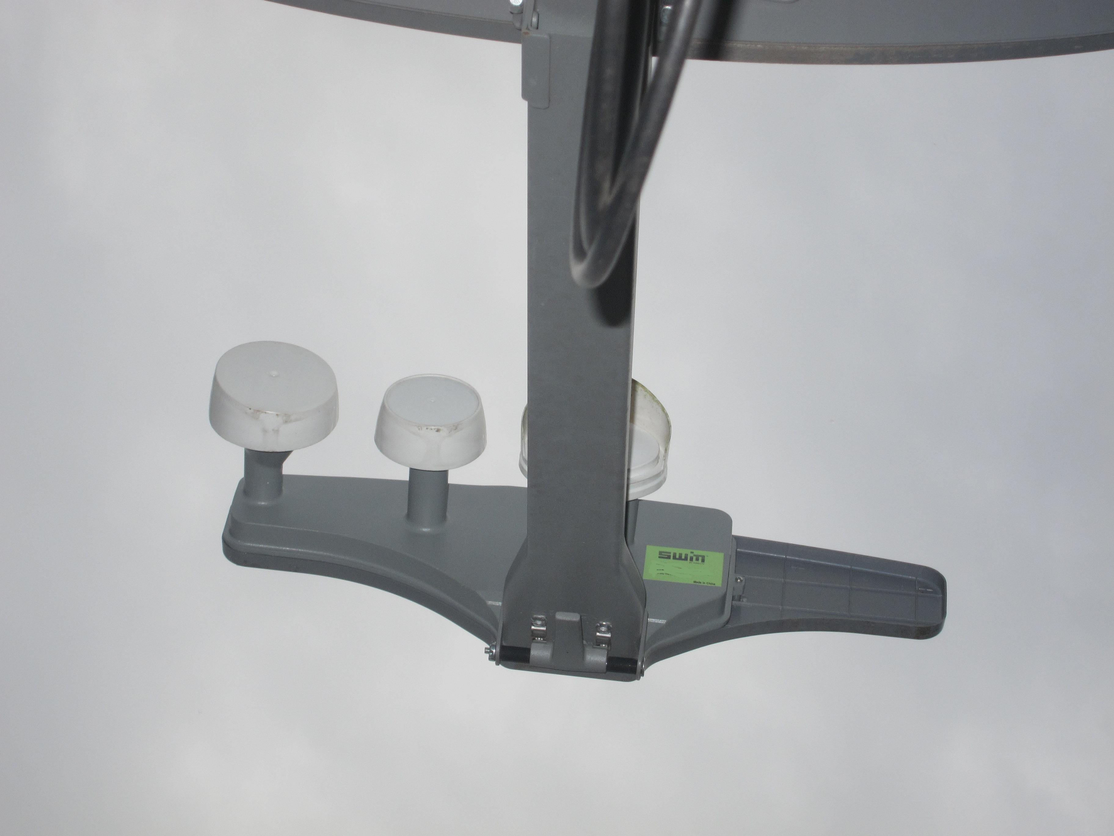

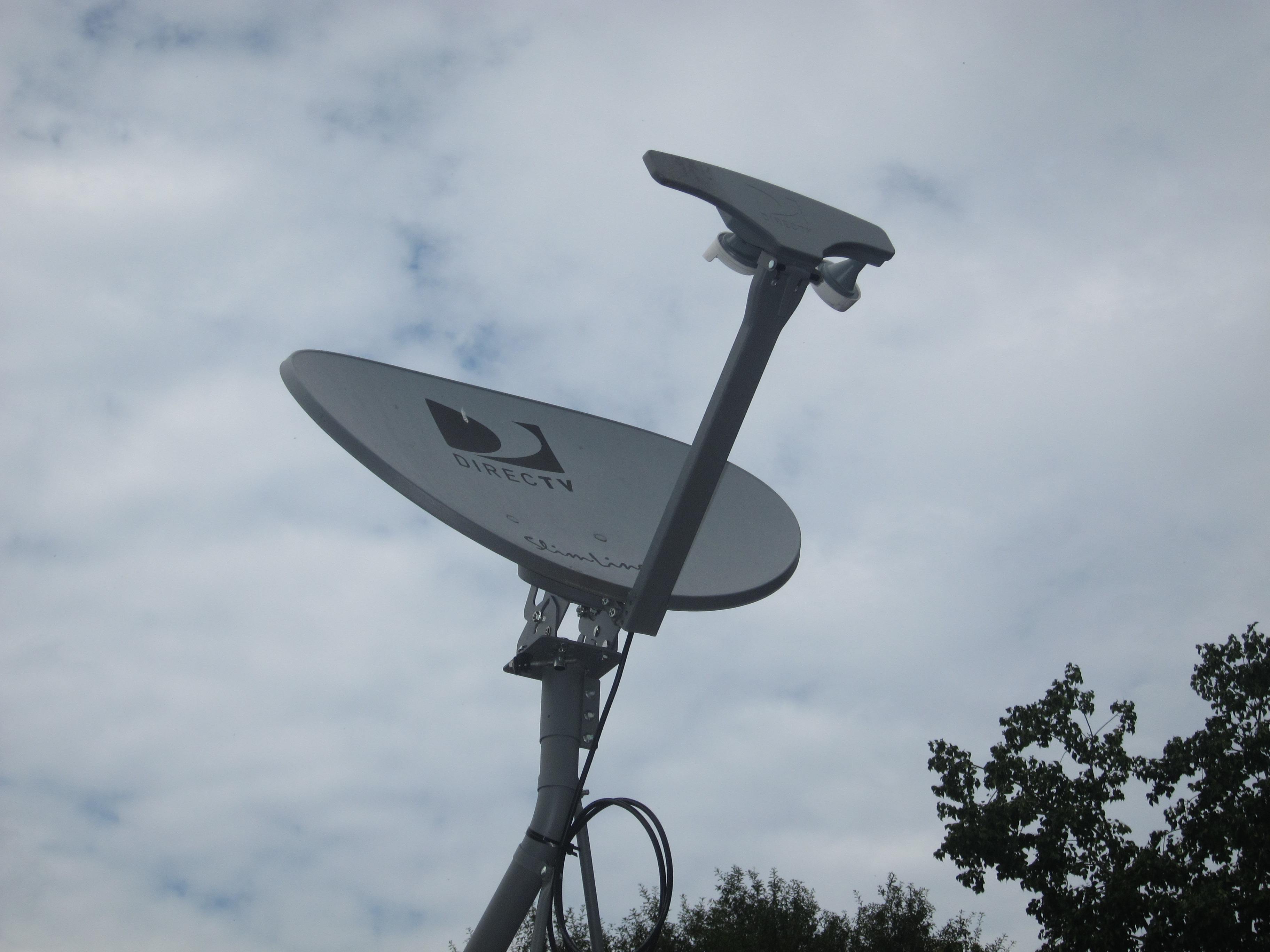

This is the Satellite model which was professionally installed on the roof and has not moved or anything which is why I don't understand why the SD Channels are coming in fine and not the HD.

You have an alignment issue. Check the dish to be sure the mount is tight and the dish is firmly connected to the mast.
If there are no issues there, then you need to adjust it. While someone is watching the signal strength screen, push gently on the back of the dish on all four "corners" and see what happens to the numbers. Allow a few seconds for any changes to occur. That should tell you which direction the dish needs to move. There are small knobs on the mount that will move the dish in small increments. Try adjusting the dish and see what happens. Good luck and let us know how it goes.

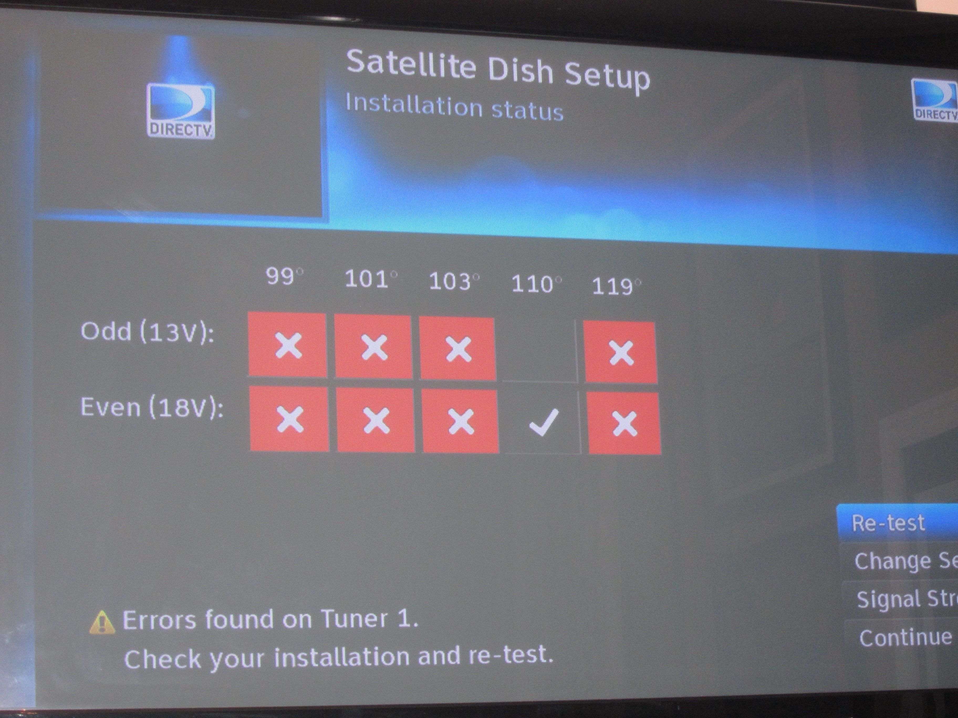

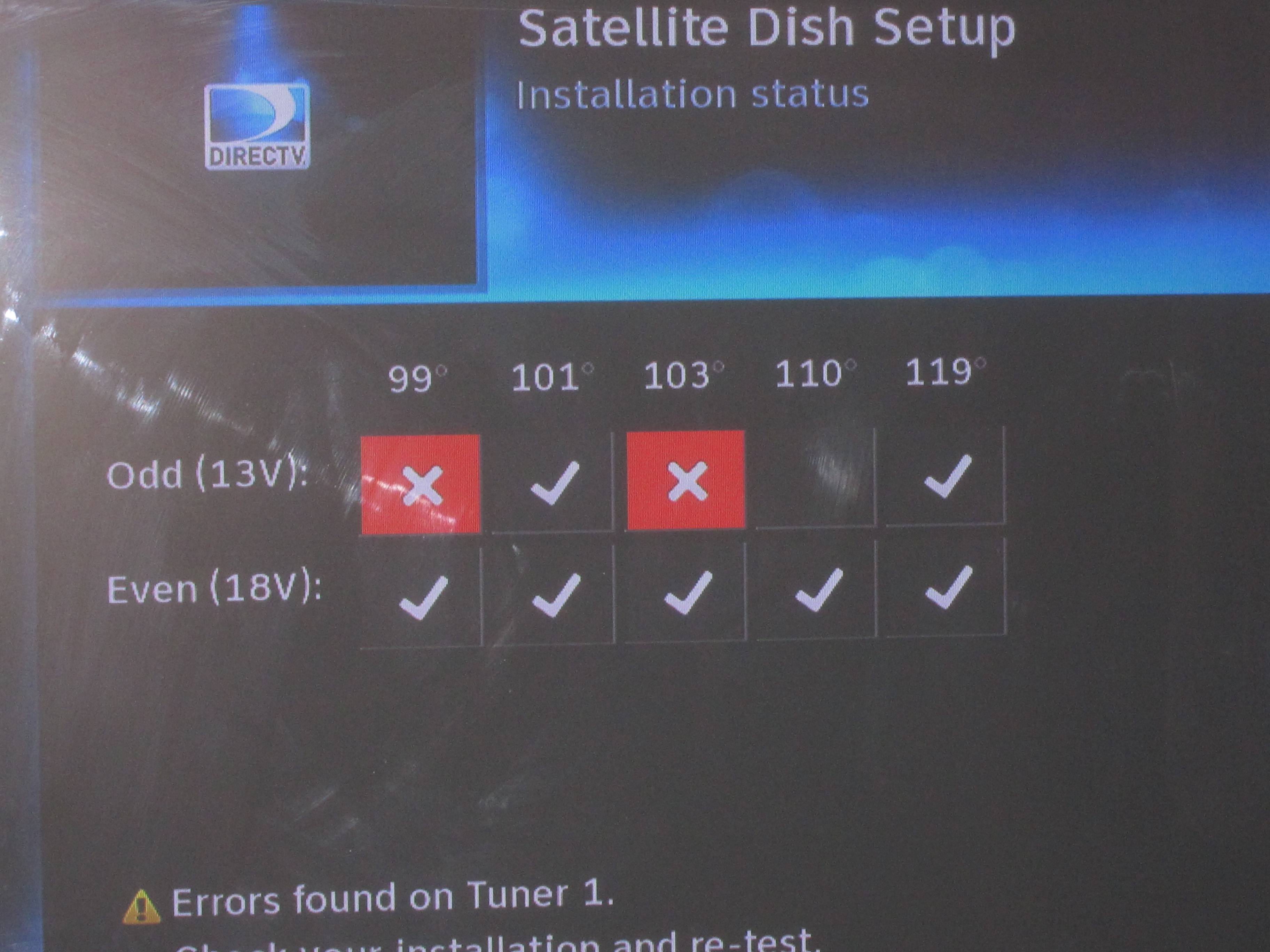

Edit: Also, this was the screen for the setup. I know it should not have that many Red X's for sure.
You shouldn't have ANY red X's. As for the post, way to go! Very helpful indeed! You need to just go to the satellite strength and just keep it on the 101. This is the satellite you'll need for pointing the dish. Once you get that satellite in you'll need to tighten the dish back down and then start the dithering process. It's very hard to explain but check out some YouTube videos and that should help out a lot!

Go to menu, settings, sat & antenna, view signal strength. Check the numbers for 101. It's the same one in your 7th picture. Then check the other satellites, but don't worry about 99s or 103s.
Okay, I understand. What type of numbers am I hoping to see when I adjust it? I will look up some guides etc. on proper satellite alignment. Thanks again for everything guys.
For 101 you should get almost all mid to high 90s and a few 100s. For the 99c and 103ca/cb sats, similar but maybe a little lower.

Hello all. I am sorry I have not gotten back sooner. There was a hurricane/tropical storm in my area here in louisiana. I finally got up on the roof and adjusted properly. The HD Channels all come in fine now. So thanks to all that helped and replied with suggestions. I am still getting a slight problem. When I would originally do the Dish Setup, I would get pretty much all RED X's on the one test screen. Even though all the channels are currently working fine, I still get 2 red X's across the chart. Is this something I should be concerned with. I seem to have realigned everything properly unless I am missing something. Here is a shot:
Like I said, other than those 2 X's everything is working fine. ALL HD channels are now coming in just fine with no skipping or errors.

These mean you still have a dish slightly off. They're good enough to receive programming buy could be better. You'll notice rain fade much quicker than you should.
You may find a couple of the transponders are in the mid 80s or so. That's enough to give the error message, but not enough to affect reception in good conditions. Like Hutch said, you may lose signal quicker in the rain. Can you post your signal strengths for all of the satellites? You might be able to dither the dish and get those numbers higher.
Good start, but can you post 99c, 103ca, and 103cb?
I sure can, if you tell me what options to go to do so. I have run the initial setup a few times but I didn't see specifically what screen to bring up that option.
It's the same way you got to the 101 screen. Check the right side of the screen and you will see the + sign highlighted. Hit enter and it will move to the 110, then 119, etc. Keep going and you will get to the screens I mentioned.
