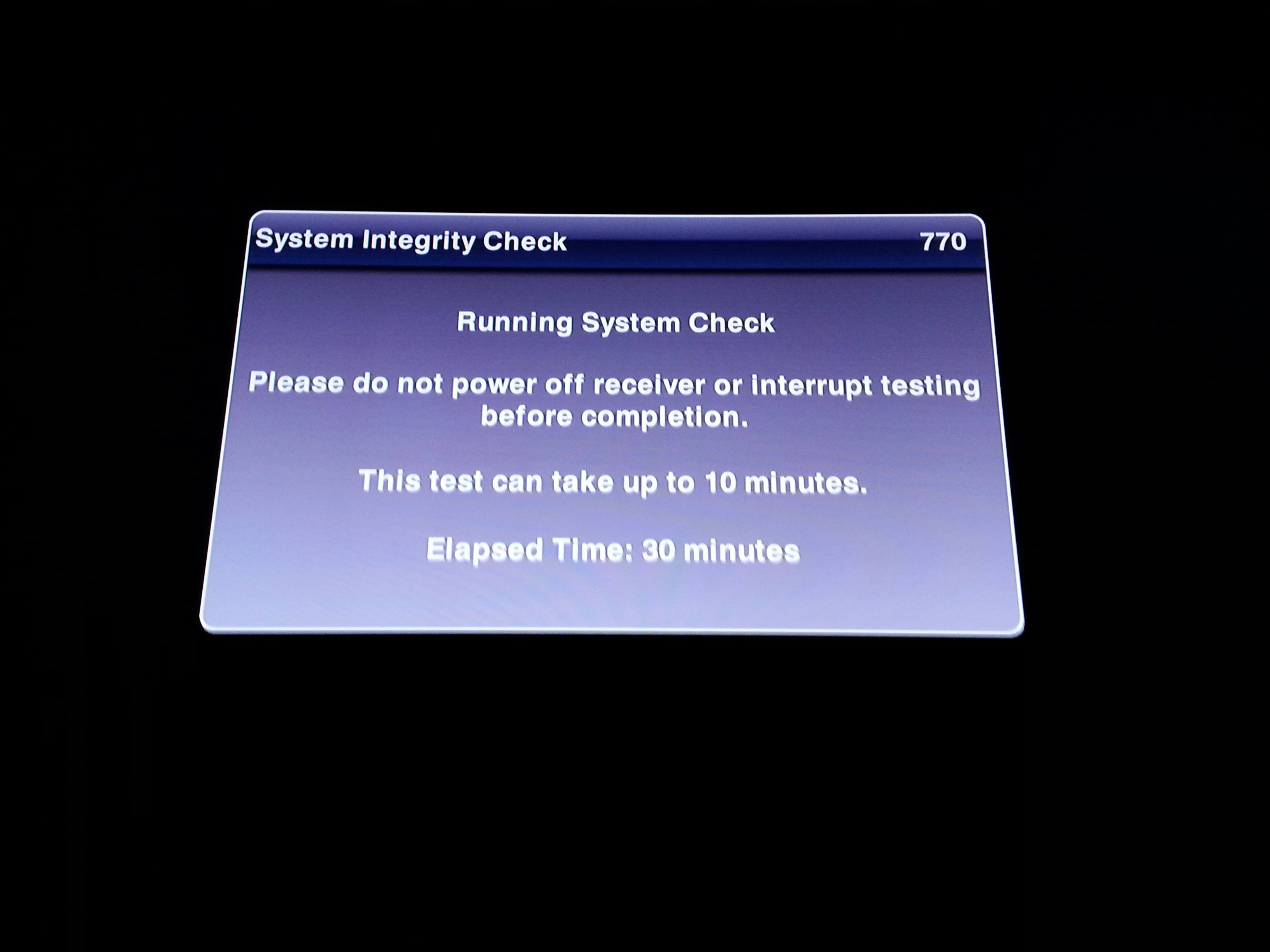

This is my first check of the Hopper when it wasn't available:

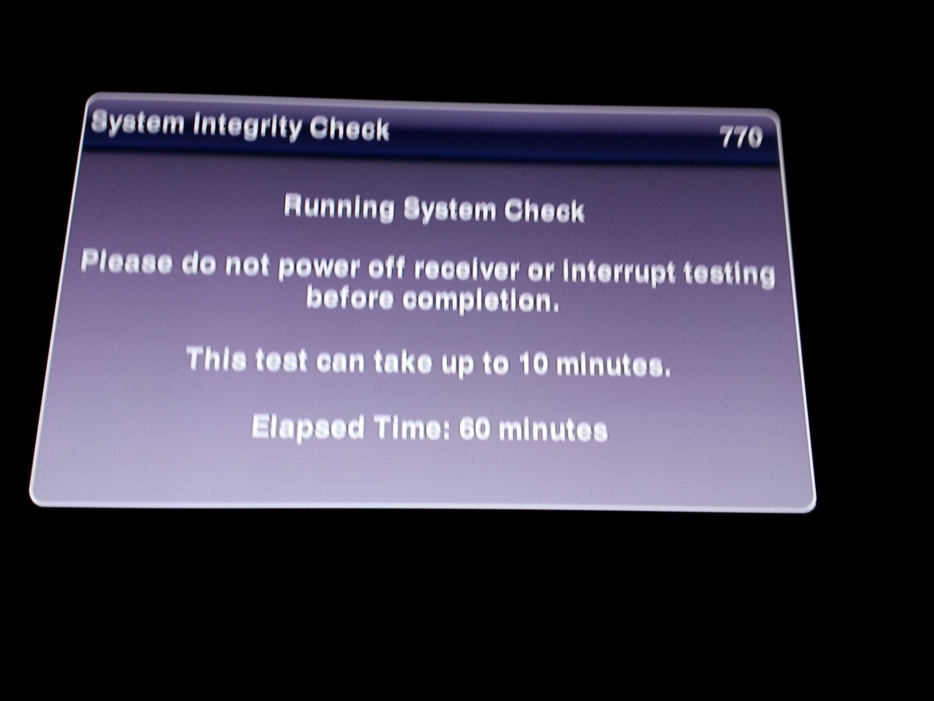

It was at 1:57am and at this point, the hopper had been down for 30+ minutes. That is 1/48th of the day, or > 2% of the day. I continued monitoring and snapping pictures at 2 minute intervals and the last shot I got before it finally finished was this one:
The last photo was taken at 2:27am, and it was in minute 61 (after this shot) when the hopper finally became available again. At this point, I've now had my hopper unavailable for > 4% of the day.
