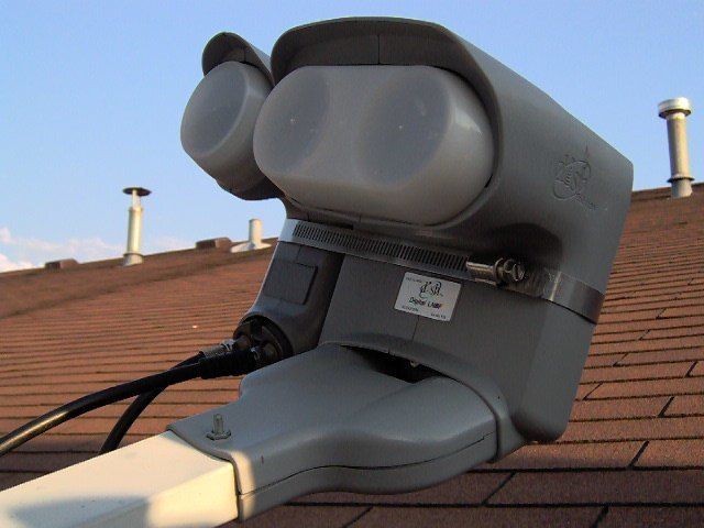

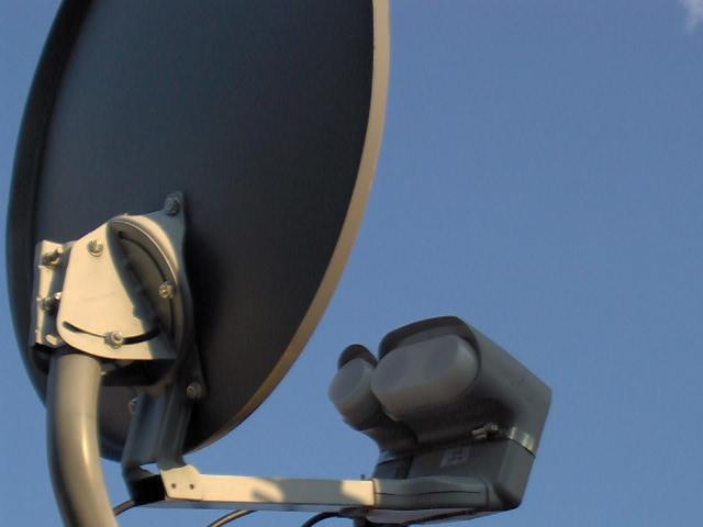

You could always just add a dual LNB to the side of the existing Twin with a hoseclamp. Thats what I did a while back when 129 first came out...ghetto rig. My specialty :)

The DPPTwin has a 3rd port which is an input so you can hook a cable from the output of the dual or single to the DPPTwin...reason I say if you are handy, you may not need the 2nd dish and just hoseclamp it like I did above
