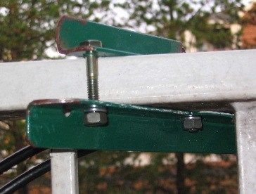

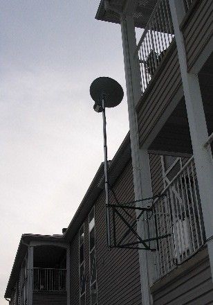

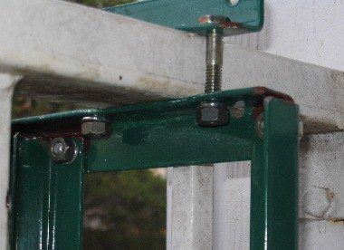

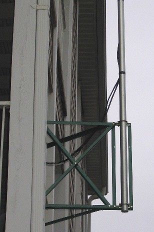

a picture is worth . . .
I had these in my archive.
Have no idea where I got 'em.
Possibly here on SatGuys...
Seems pretty self-explanatory.
At least one guy's good idea.
Nice work!! Improvise,overcome, adapt....
UNfortunately 99% of all apartment communites in this area forbid this kind of work. They go with the OTARD rules and limit the dish location to areas within the exclusive uise of the tennant. Some go as far as banning ANY part of the dish extend over the rail of the balcony/patio.
