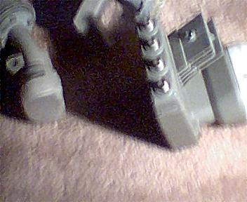

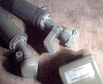

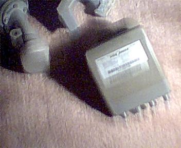

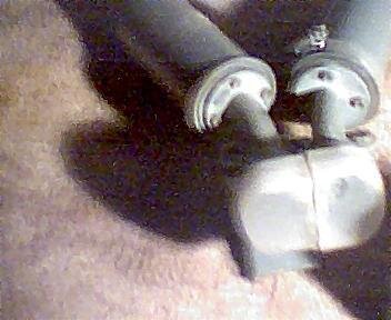

Here are some pics of the old style SC LNB's that I cut in 2 and have been using them as single LNB's.You can see in the first pic where I cut it in 2.The next 2 are current SC LNB's (with built in 22k) that are not seperable.The last shows the first LNB's seperated.They were used with seperate 22k sw.
why did you cut them? They are 3.8 degrees apart so in most cases you were able to get 4 degree spacing (with the SC dish) with no extra equipment or aiming needed
I have several current models for that.Originally,I cut them to use one to snuggle up very tight to119wto receive 123 on the same dish.The flat edge where it was cut,was the only way I could get that tight to 119.
