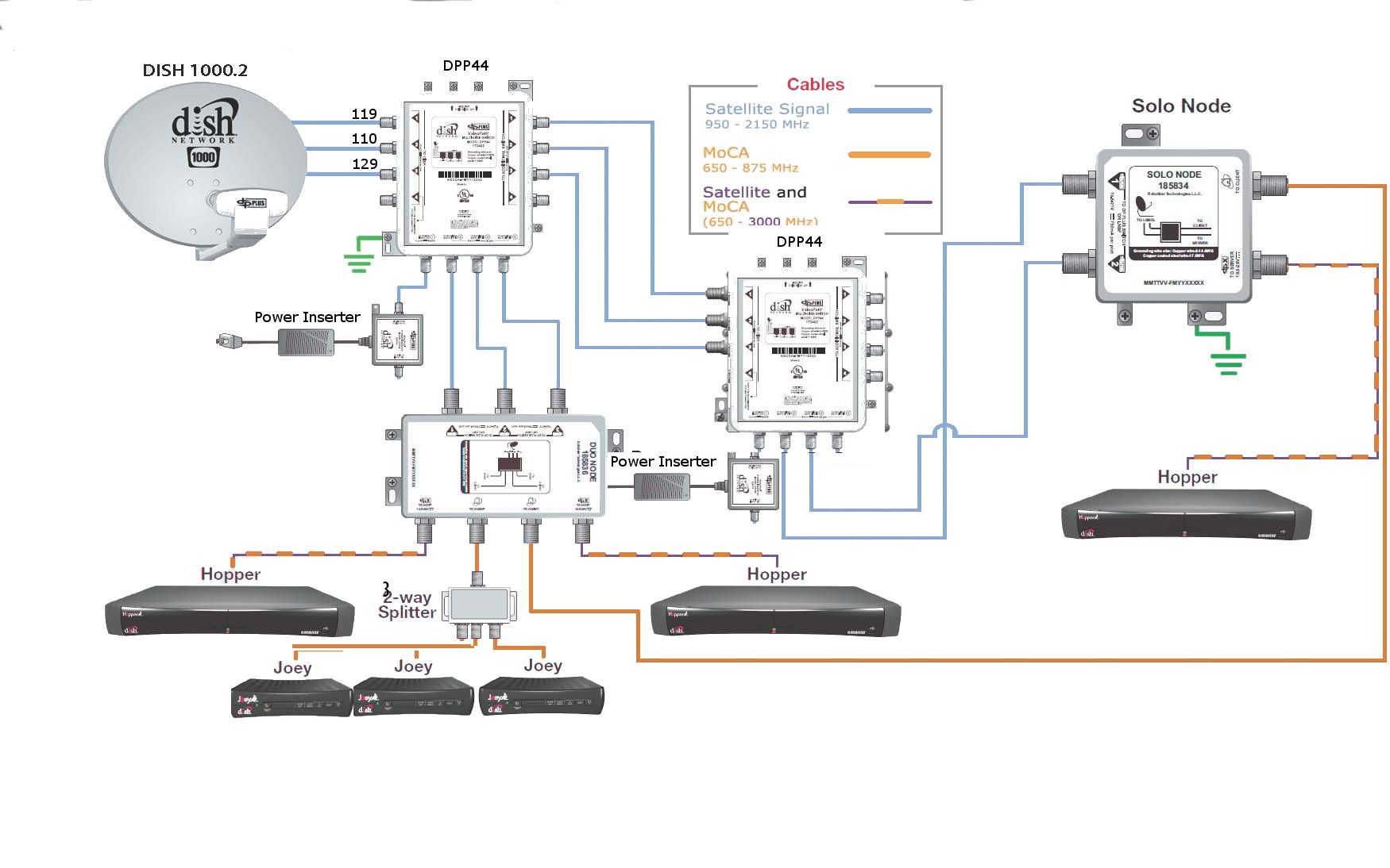

What is your exact wiring diagram? We know the two DPP44's, but what else and how do you have them connected? I am guessing it is either Node or the connection to the node(should have 2 nodes, a Duo and a solo). Can you make a mock up of it and post the drawing of the diagram here?

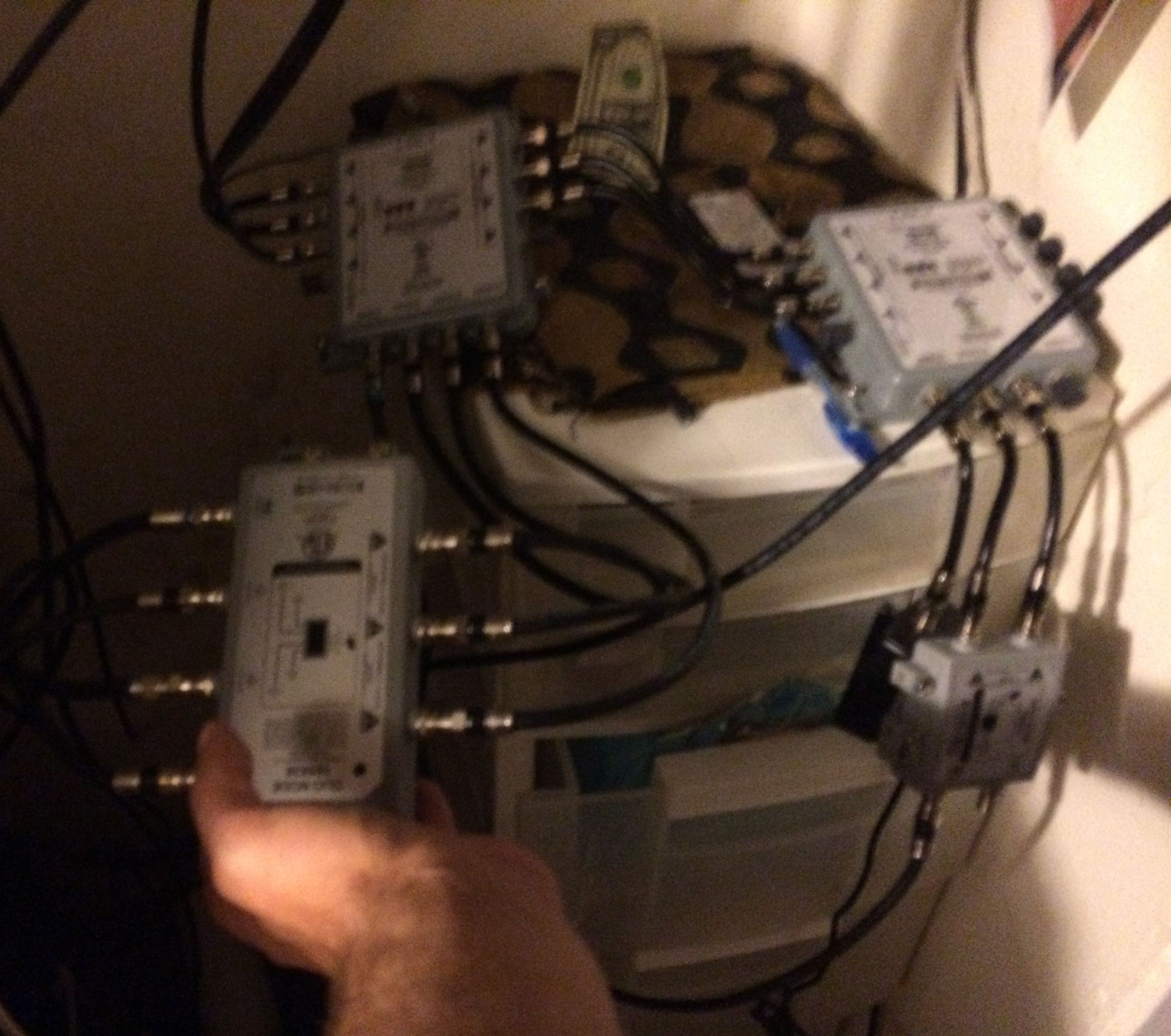

Here is a picture mind you I have never touched this not once ever this is how they installed it (well except to try to make add a cord from the client port to the other client port which they did while here and it caused a system malfunction). Its not pretty like the guys in the other picture. its in a closet in my basement.
Maybe a tech can make a little more sense of that, but can you draw it out by chance? Just a simple which line is going in where. From the picture, I see the 2 DPP44's and it looks like the solo node is on one by itself, and that is connected into the duo node which is also connected to another 44 switch. Just cannot tell the order.
If OP wants a single Hopper network, then he'll need a MoCA connection between the Duo & Solo nodes -- it looks like this is no connection.
I gave benefit of the doubt that there was a link between the solo and duo node, via splitter into the second host port. There is a cable coming down but it is out of frame.

it looks much nicer looking here but here is how that mess is hooked up minus the line from the single node to the duo node right now to get it working again however someone said I should try removing client items...........................so first I'm trying the office joey to see if its that line
Looking at both diagrams, I always thought the host port had to be split for the third hopper on the duo node, into a solo node from the client port. Looking a tthe other diagram posted, it is not like that, so not sure. It has been awhile since I deciphered these diagrams at Dish so I am not sure.
