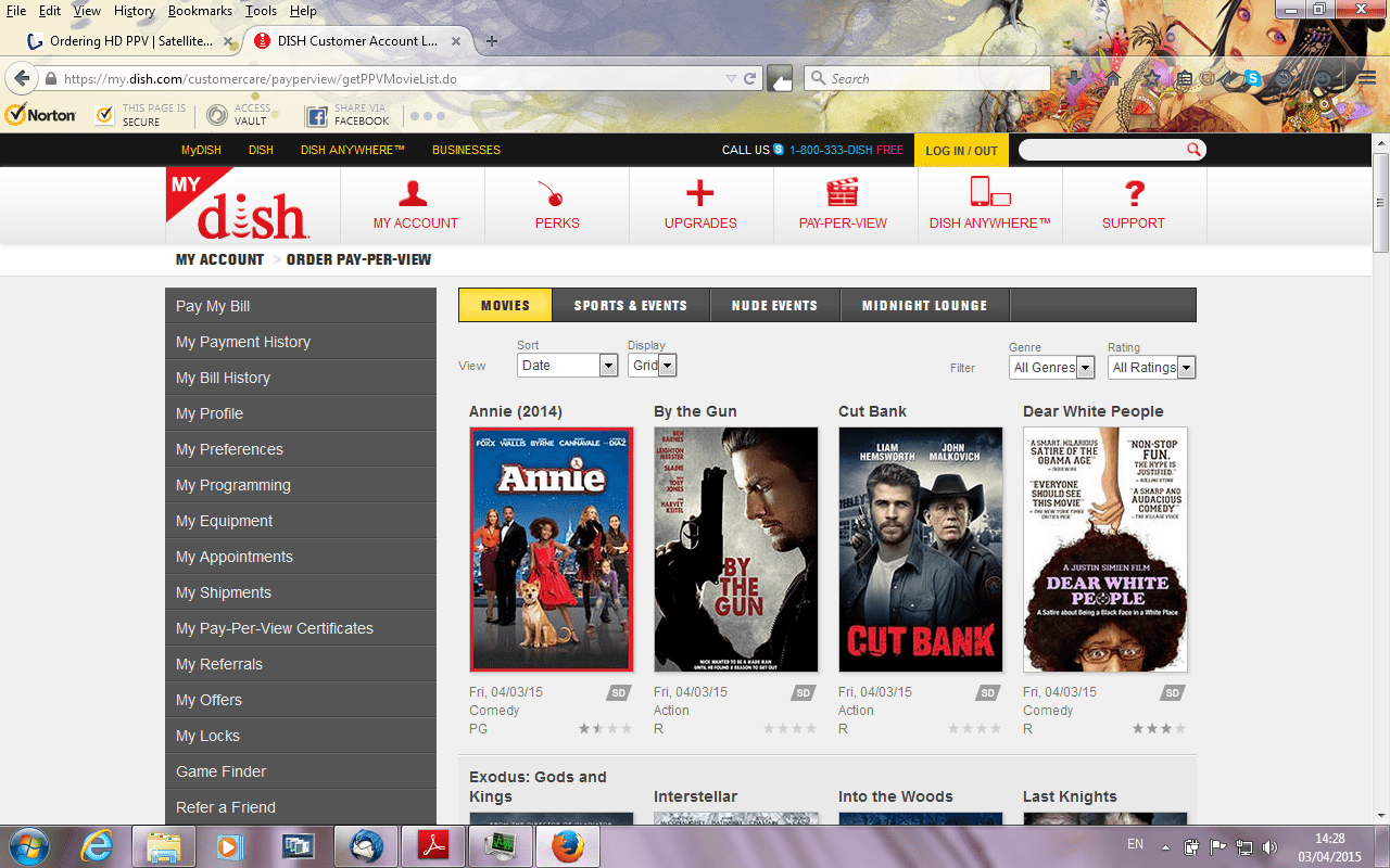

When I try to order an HD PPV movie through the Dish website, the order screen only shows me the SD versions. What am I doing wrong?
Thanks. I am able to see HD and SD. I logged into MyDISH.com then I went to Order PPV. At the top of the page there is a video format button, select HD from that drop down. I clicked on Interstellar and it shows HD 504 and 3 other channels which are SD. Then under order movie the red dot should automatically be on HD.
I checked but I can't find that option. Here is a screenshot of my Order PPV screen:

I have the same trouble. Only shows in SD. Wonder if it is a Firefox thing.
...nope... same screen as shown above in Google Chrome and Firefox.
I still can't order HD PPV from the Dish Network website. One thing I have noticed is that when I go to the order page (like the one shown in post #5) the HD/SD selection box appears briefly where the word "filter" is but then it disappears. It does this in both Firefox and IE. Is this a problem with the web page or does the Dish Network system think I can't watch HD content?

Just for so, I tried ordering a PPV film using the toll free number. After I had worked my way through all the prompts I got a recorded announcement saying that my account doesn't support HD. I stayed on the line and spoke to a CSR. While she wasn't able to fix my account she did order the film for me.
What would cause the Dish system to say my account didn't support HD even though my account shows the correct VIP receiver and I have the HD package?
If their system is not tracking that you have the right satellites, such as only 119/110 then that would make sense. There is no way for a customer to know what their system says either. It is only on the company side, and is used internally.
