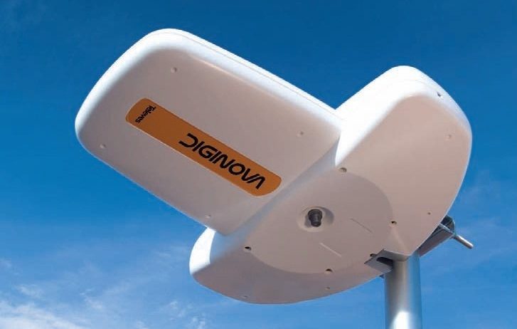

It is not powered and looks like this. I will ask dish to come check it out, but i doubt that they'll come out for ota issues since they don't really support that. Getting to ot myself is tricky since it sits at the highest peak of my 2 story house.
I have the same OTA antenna that Dish installed on my roof years ago. I ended up buying a new one when Solid Signal had a good sale on it a few months ago. I called Dish and set up the protection plan for a month and they charged me like $50 for a custom work order which I was fine with because like you I didn't want to go up on my roof. When I spoke to Dish I just had to explain that they installed the original one years ago. It took a little bit of explaining to the rep but it worked out for me in the end.
That antenna should of came with a power adapter. It's not always required though. Who installed it? Could be possible if someone else installed it that there is a power adapter behind TV or in attic. If you're sure there's no power adapter then your issue is the antenna itself or the USB adapter.
