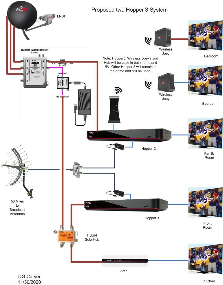

How about this configuration?

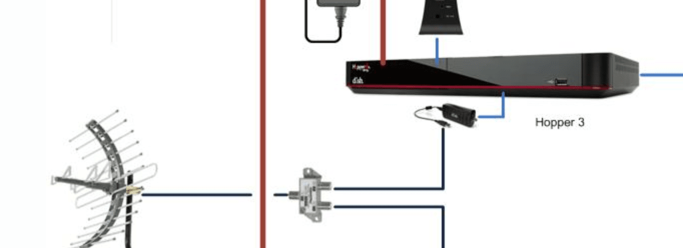

Actually I believe the picture is simply showing a coax going from the splitter to the adaptor and then the USB going from the adaptor to the Hopper rather than whee the actual wires connect.
I was pointing out the obvious, all in fun I hope!
That looks like a single tuner adapter, too.

The way to think of it is a single Hopper is going to control and manage only ONE USB tuner with the result being only that Hopper will function properly with the USB tuner. So, ideally, the USB OTA tuner is to be installed inside the home next to each Hopper or H3.
Unless someone has done so, I don't believe you can install a single USB tuner and then have multiple Hoppers share that one USB tuner. Do correct me if I am wrong, but I think only ONE Hopper can magange and contol a single USB tuner for use on ONE Hopper only.
