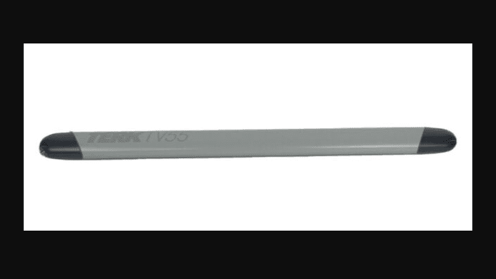

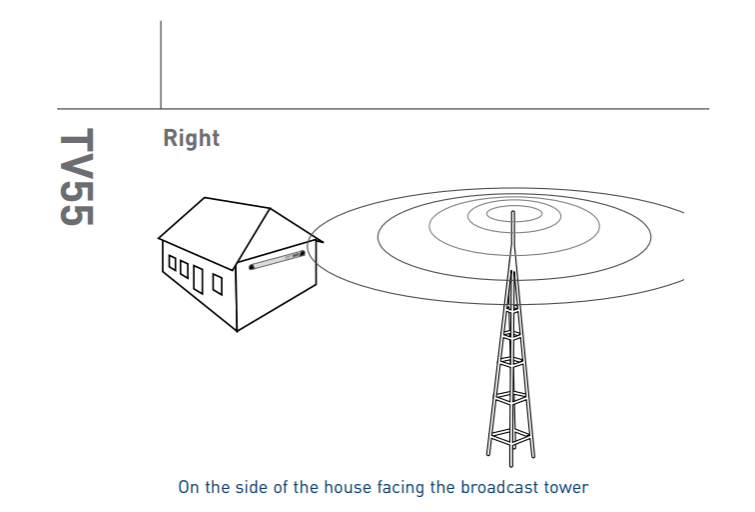

Somebody was kind enough to send me the link for Terk55 manual. I looked at it. The entire surface (with the name and model number) is front of the antenna. I assumed the front was either pointy edge. The installer hang it incorrectly because label side was facing North. I did not flip the antenna, just changed its direction. And, it worked.
So you have the front face of the antenna pointing which way now? I'm really confused. Obviously, don't change anything, but the fact that you're getting Lexington AND Cincinnati stations (or just the NBC?) is what's confusing me.
Sorry Sam; I will be clearer. That Terk55 antenna looks like an arm. Both pointy edges look identical. According to the manual, the side that has the name is front, and the coax is attached underneath. The installer attached the antenna to a metal bracket hanging from a rafter. He aligned perfectly, the side with the label(which is supposedly front) facing north toward Cincinnati. But, the transmitter towers I need r located South toward Lexington. If I understand correctly, the front of any antenna should face the towers, in my case South. I thought I needed to loosen the bracket and flip the antenna so that label side (front) would face South. I didn't do that. I changed the direction just a bit. That new direction provided great receptions from all Southern towers and Cincy's NBC which is close to 70 miles up North.
If u click the thumbnail, u will notice the label side, front, facing u. So, that side is facing North. The pointy edge on the right (when u r looking at the picture) is facing West. Pretend u r standing in front and looking at the label and logo side. Grab that edge (facing West) and rotate little bit toward North (Now that edge is showing about 280 degrees on my iphone compass.)
Hope I was able to explain myself. I only get NBC (channel 5) and its sub, Metv from Cincinnati. The rest are all Lexington and one extra public station (52 from Owenton and its 3 subs) from Northwest (Owenton).
