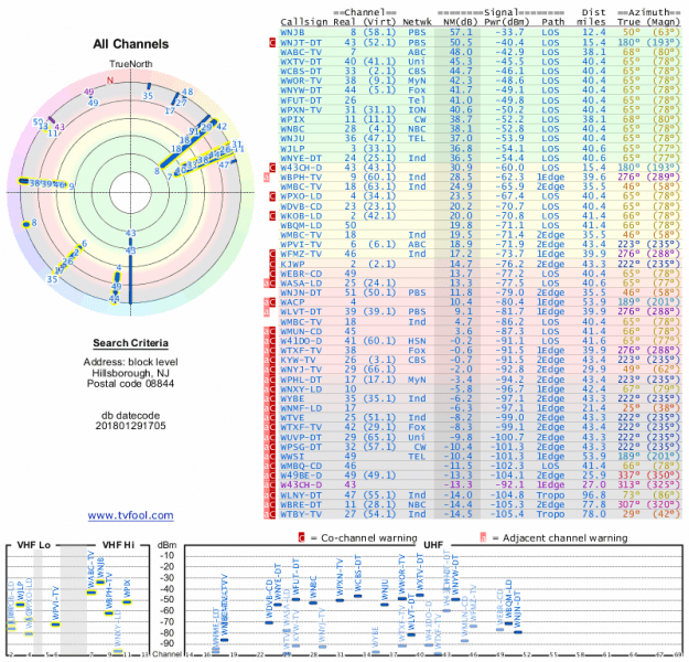

Results weren't great. On the second floor I got spotty pixelated coverage on NBC, CBS, FOX, WOR and a few local PBS type channels. No ABC or CW. When I put it on the window (not really what I'd like to do) the pixelation stopped but I still didn't get the missing channels. Tried several different locations and channel scans not much difference. My TV Fool is attached.
My question is would a different indoor antenna yield better results or is it just my location and not worth the bother?

The logos mean nothing, just that you 'might' receive channels like it. Once again, just because the say you 'might' receive channels 60 to 80 miles away means nothing in the real world.
Reactions: comfortably_numb
Those mudflap antennas never do well for VHF, which is what WABC is.
Might be worth checking out a decent set of rabbit ears with VHF capability. RCA makes some good ones. Add a distribution amp or inexpensive preamp if needed. I have 3 of these: RCA Antennas : Indoor HD Antenna : ANT112R
2 of them are in use at a friends' house. They do well on VHF less than 45 miles away, so you might get WABC with one of those. Walmart has them IIRC

Much past 30 miles indoor antennas have so many disadvantages that they work very poorly, walls filter signals out refrigerators, ovens, stoves, AC/Heater units reflect signals, even the human body walking around indoors can reflect and absorb RF signals.
This is why an outdoor antenna is encouraged, especially if you want stable picture/sound 24/7.
A small UHF/VHF all channel antenna mounted above your roof line can be had for less than $100 installed (don't buy cheap Chinese junk even if it promises 100 mile reception - LIES).
