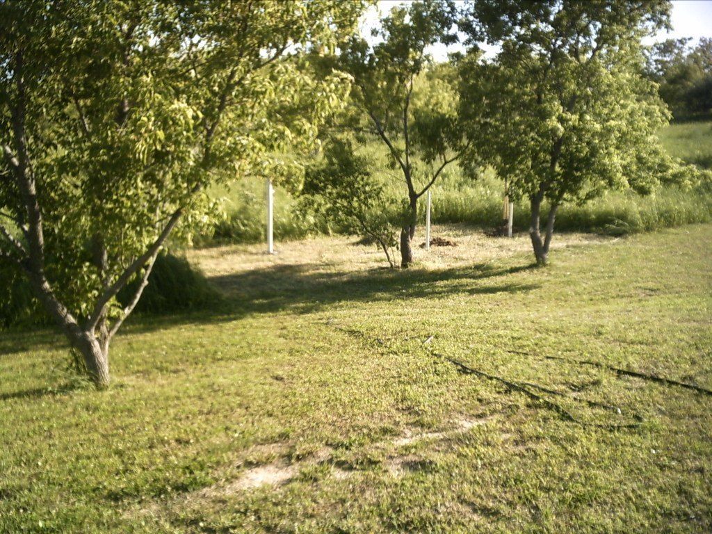

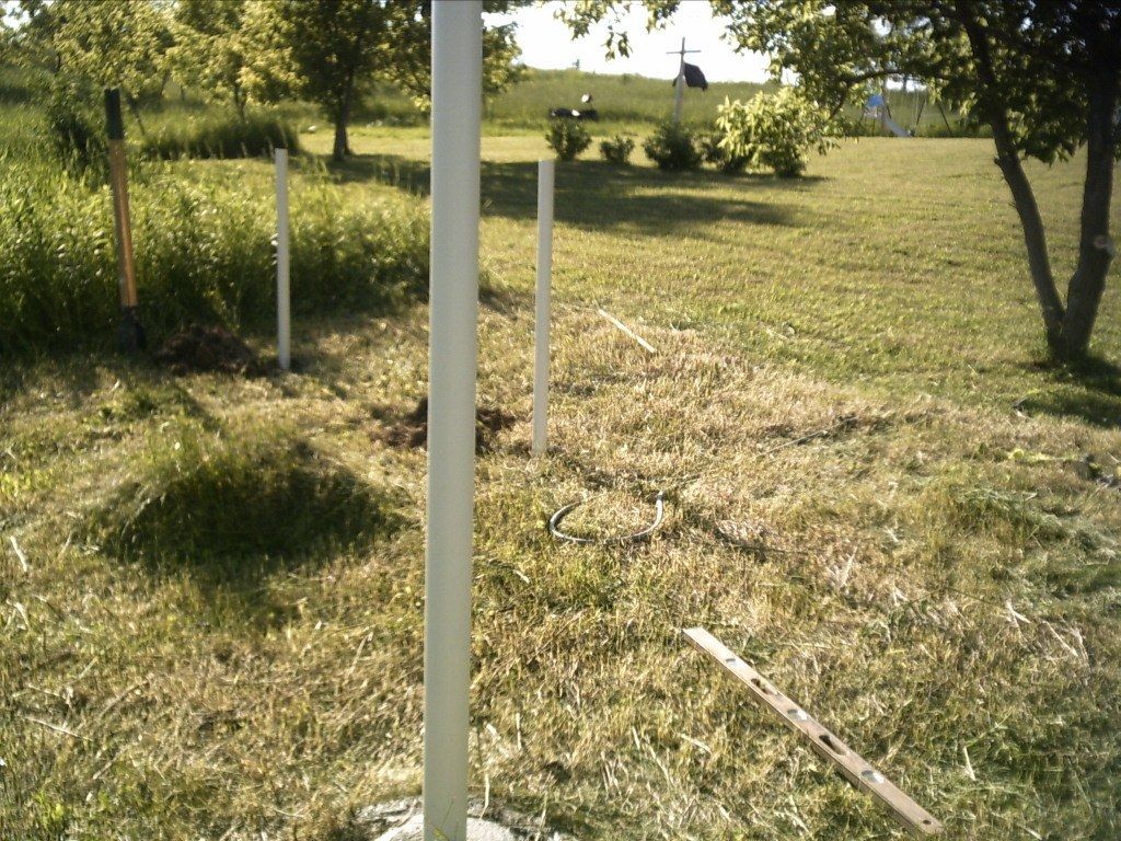

Just planted 3 new poles today. 85 deg in the shade today but it was the first day I had to get it done.
Put a 9' 3.5" pole in for c band with 5 ' above ground and 2 7' 2 3/8" for my 1.2 m
with 4' above ground. That should keep them out of the snow and below the frost line. I found 120 ft of c band ribbon cable in the pole barn and ordered a Sadoun g3000 mover. Now when the cement sets up I can begin the job of moving the dishes and setting up the c band.

You're on your way. Hope those smaller dishes don't end up looking at the back of your c-band, looks like they're behind the big pole.
edit: Must've been the way you were standing with camera, lol.
the first picture is the best way to visualize the layout. They are in a east west line with the c band slightly more south of the 2 smaller ones. There is 7 feet between the 2 smaller ones and about 10 between the c band and the closest 1.2m. Thanks for taking a look. Ill be adding more pictures as it grows.

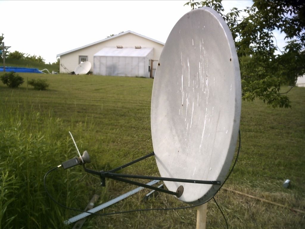

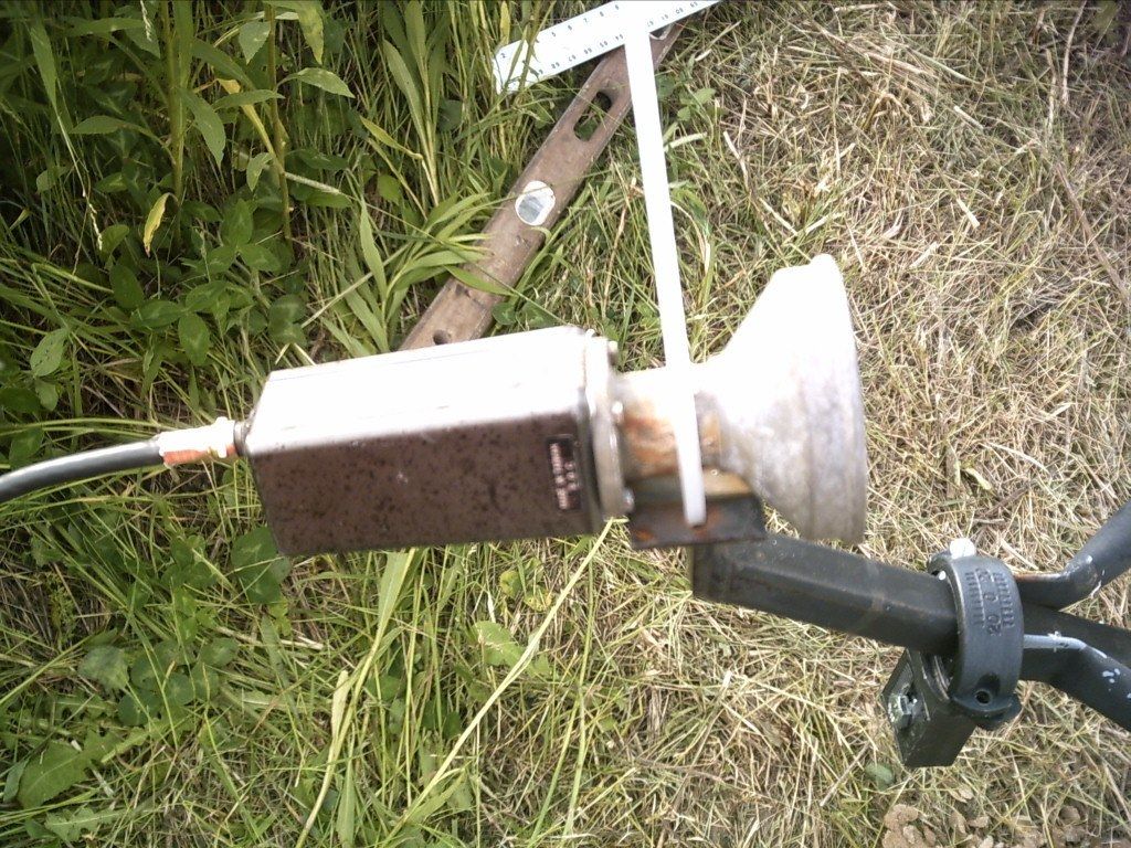

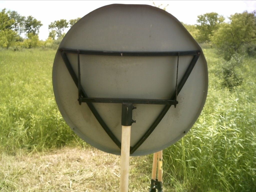

Any one ever seen a dish like this one?
Haven't seen one quite like that before, looks ok, could use some paint! Maybe a newer lnb will fix it up. I been watching WhiteSprings most of the afternoon, and it's putting out plenty of power.
Yes needs paint, the birds been using it for a bathroom. And need lnbs (2) hope to use it to get both 123 and 129. I swung it back to 123 before I came in and checked what all I could get on a single polarity lnb. Also it is a little bent up around the rim at top but only the flange the dish does not seem to be distorted. I think if I can come up with the right size steel tube I could weld it to the other tube and motorize this one without too much problem. It not all that heavy of a dish with the bracket on it.
The elevation adjustment is 2 bolts through the frame up at the top of the V arms.
I think the reason I had trouble with 129 is setting the skew. Now that I know where both 123 and 129 are at I can set it in the middle and build a bracket to hold a lnb for both. But I have to order lnbfs. I found small dual .02bd at Galaxy-marketing for 17 bucks each if I buy my needed 6 of them. Spent too much last week with the gbox and 3 poles so have to wait.

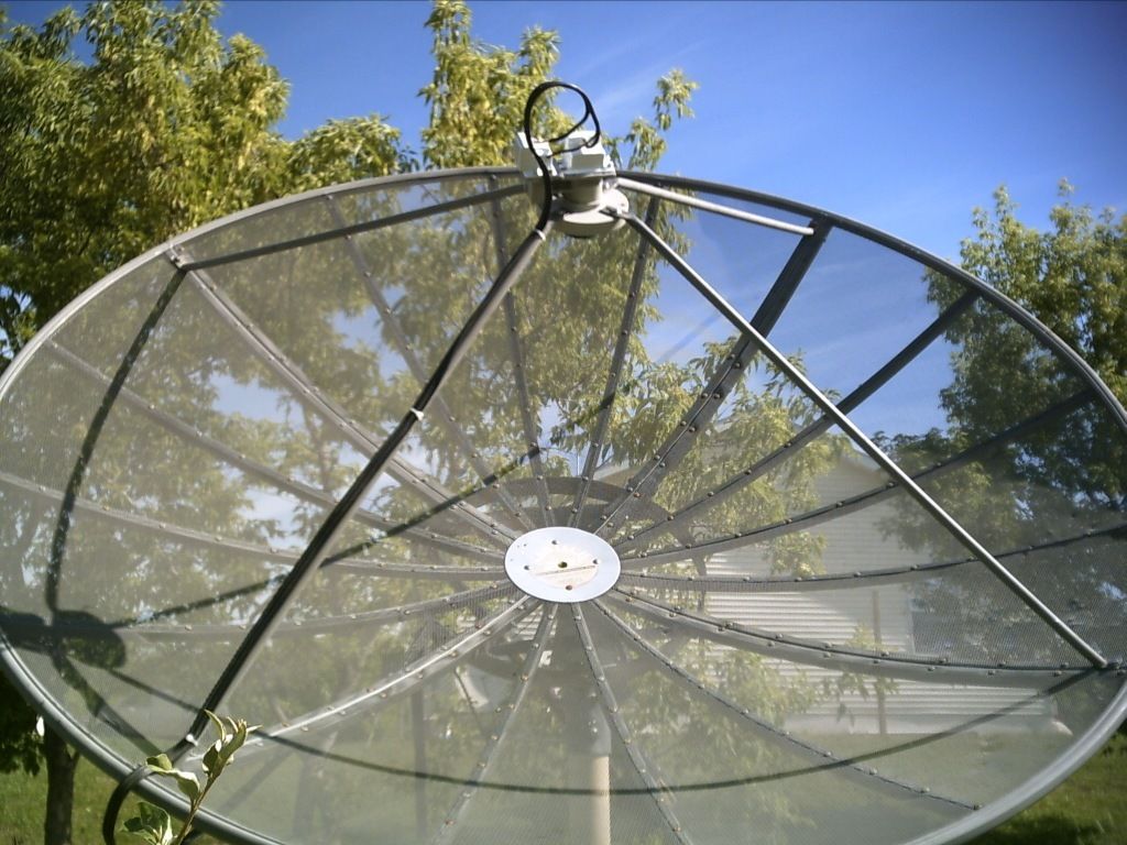

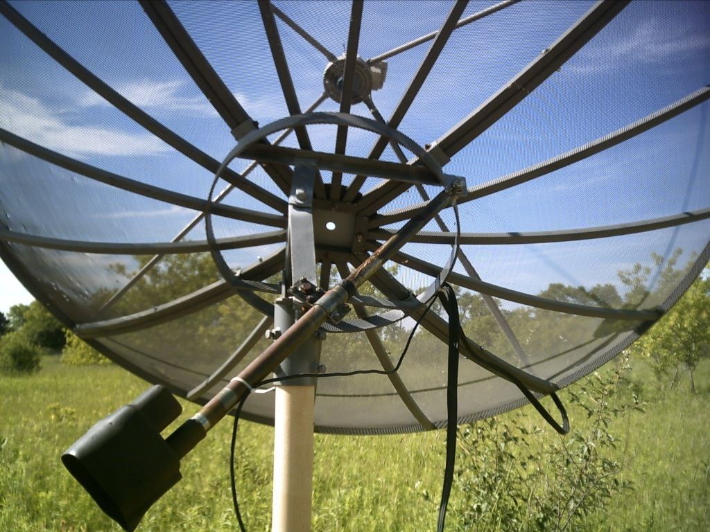

C band dish and mover

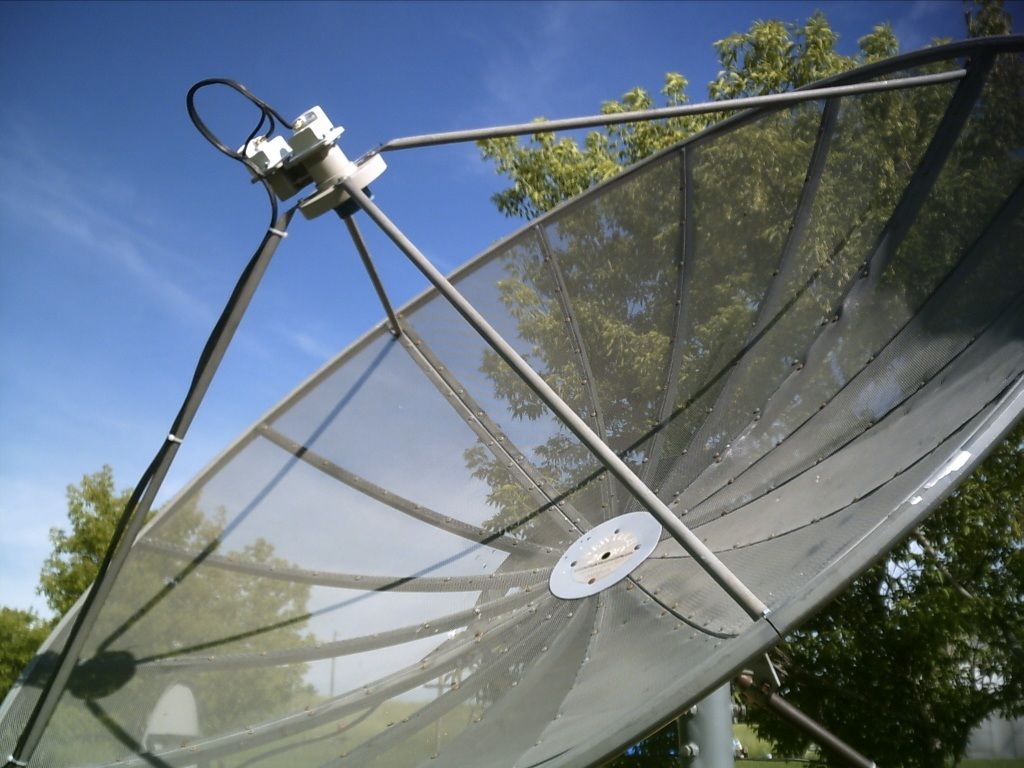

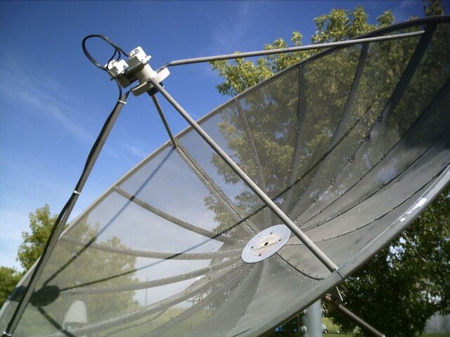

I got the c band up yesterday. These pictures are of the closest sat to due south.
Do you think that my movers are is too far out and should be adjusted so I can go farther east? This is a 7.5ft mesh with Von Wiese mover using a Gbox I have not totally figured out yet, with a dual c feedhorn. More questions to come on the switch configuration as I want to be able to use this dish on more than one receiver using zinwell 6x8 and 1x4 switches or what ever I need to make this work.
I also plan on adding a dual ku lnbf on the side of the feedhorn or drilling a hole in through the scalar. Also have a question on the operation of the gbox I have hooked up to it on the forum that I need some answers to. thanks in advance.
