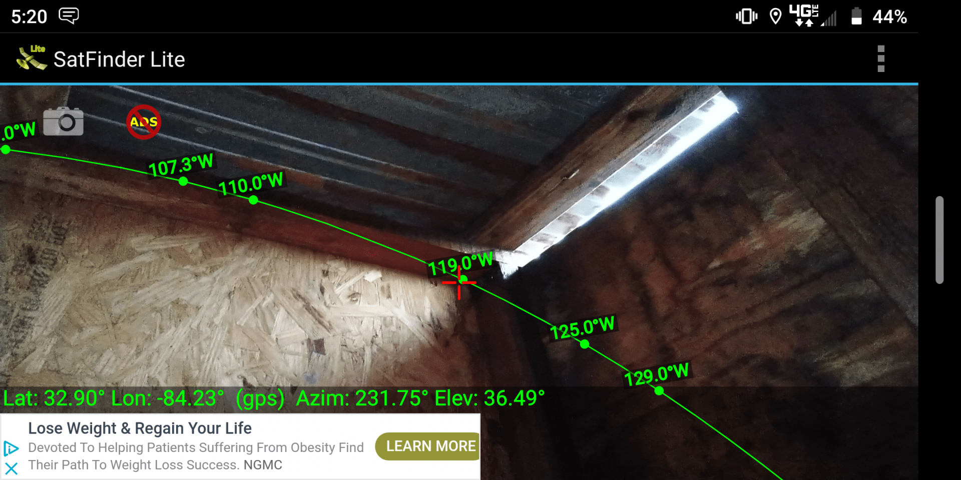

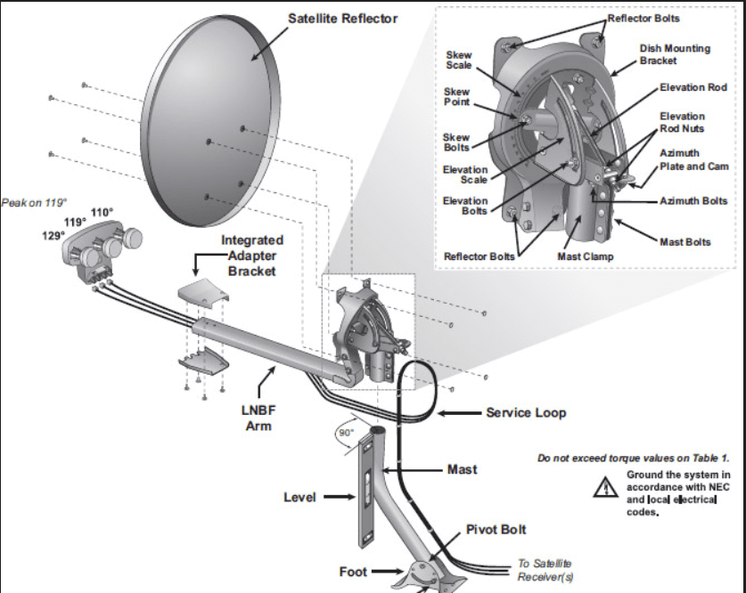

So I hit 110,standing behind the satellite dish, with the left lnb. And I can get 119 with the left lnb. I'm covering the others with foil. I can't get the center lnb to hit anything. I'm thinking maybe a bad dish?
I think you've got that backwards don't you?
No, Tvland1 had it just right.
Sorry the images just now posted. It doesn't make any sense what you said because when I am standing behind my satellite and I'm locked on to 119 I can point it more to the east and a little further north and get to 110. What you said is basically the opposite. I'm not trying to argue or anyting I'm just saying with what I thought I knew and according to the screenshot I just posted where the satellites are in the sky what you are saying doesn't make any sense to me
