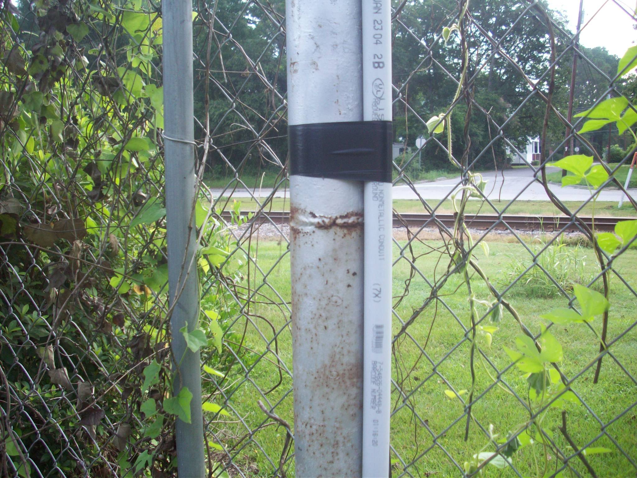

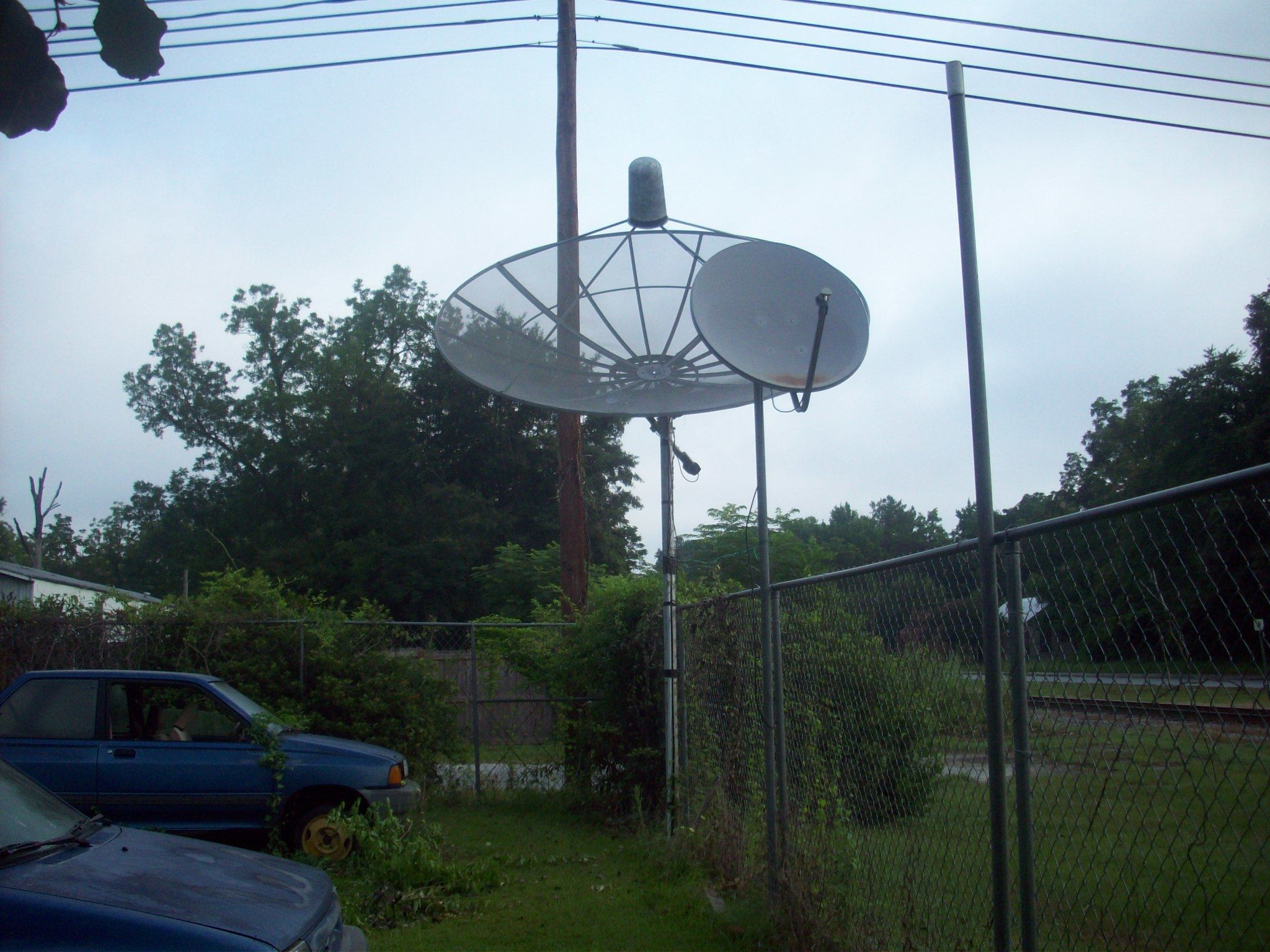

I've welded two short poles together with good results, too! I sleeved them together to make sure they remained plumb.
See the results!!!
Happy satellite hunting.
