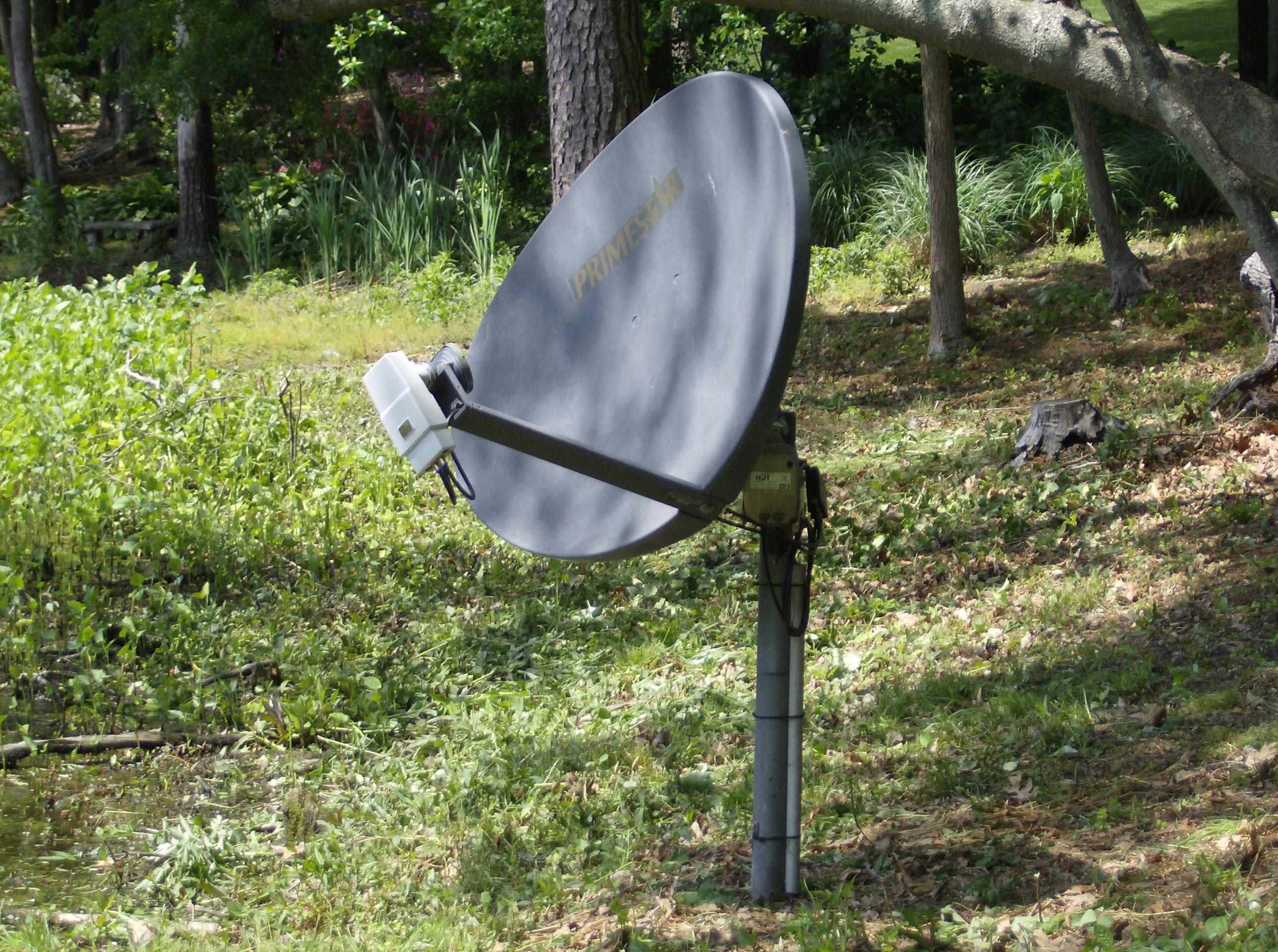

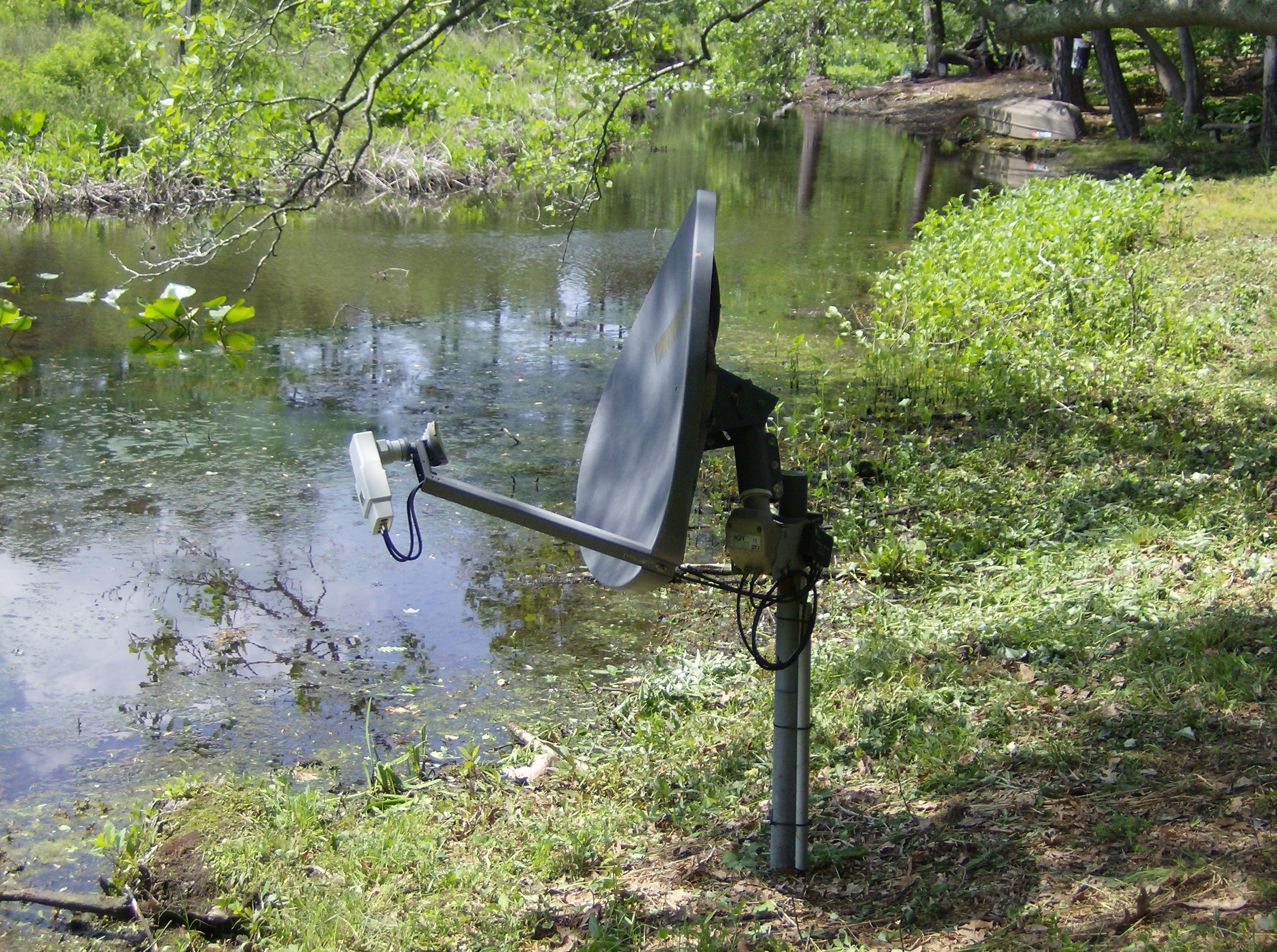

I've had good luck with the QPF-031 mated to my stock Primestar 84E feedhorn (see attached pics). In my opinion, the QPF-031 is well worth the extra money, and I was able to pick it up for a decent price ($80).

The QPF will work on any C-120 flanged feedhorn, regardless of whether it is prime focus or offset. The feedhorn is what is specifically for either a prime focus or an offset dish, the QPF is only an LNB and will function properly on either. The QPH (the one with the feedhorn built-on, or in other words, the LNBF) is for offset only.

No need to make any modifications at all. Simply swap out the stock Primestar LNB with the Invacom QPF-031 right on the original Primestar feedhorn. Fits perfectly! :up
