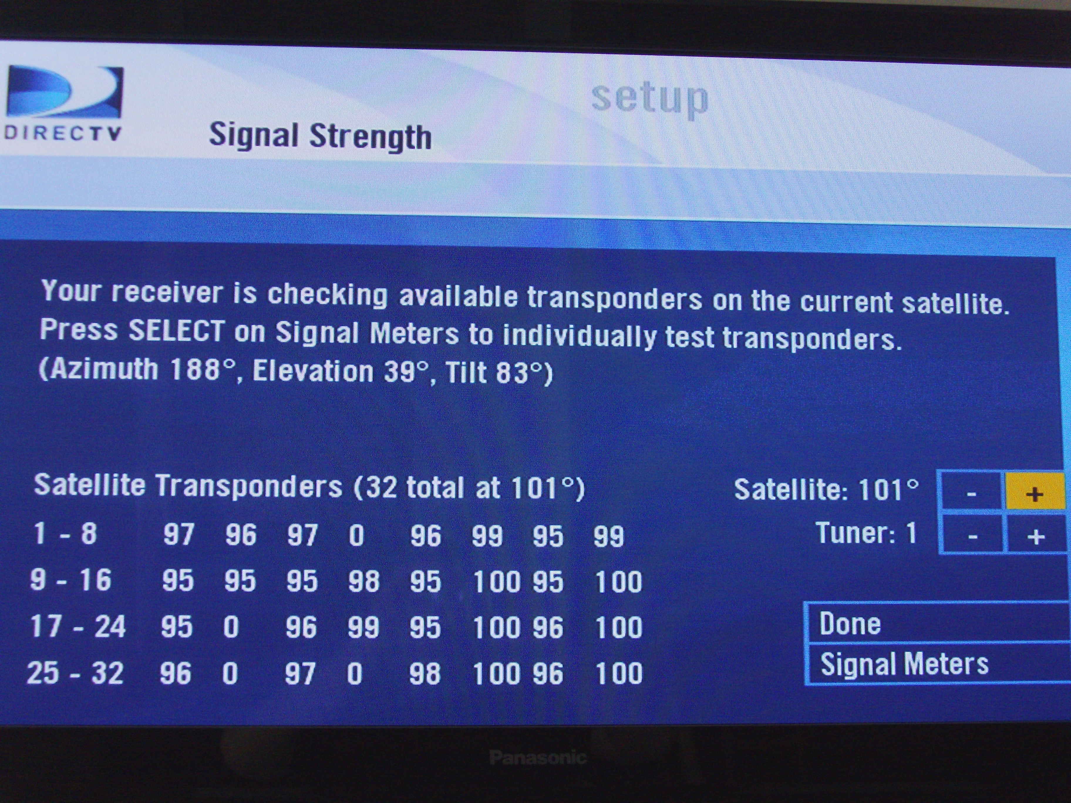

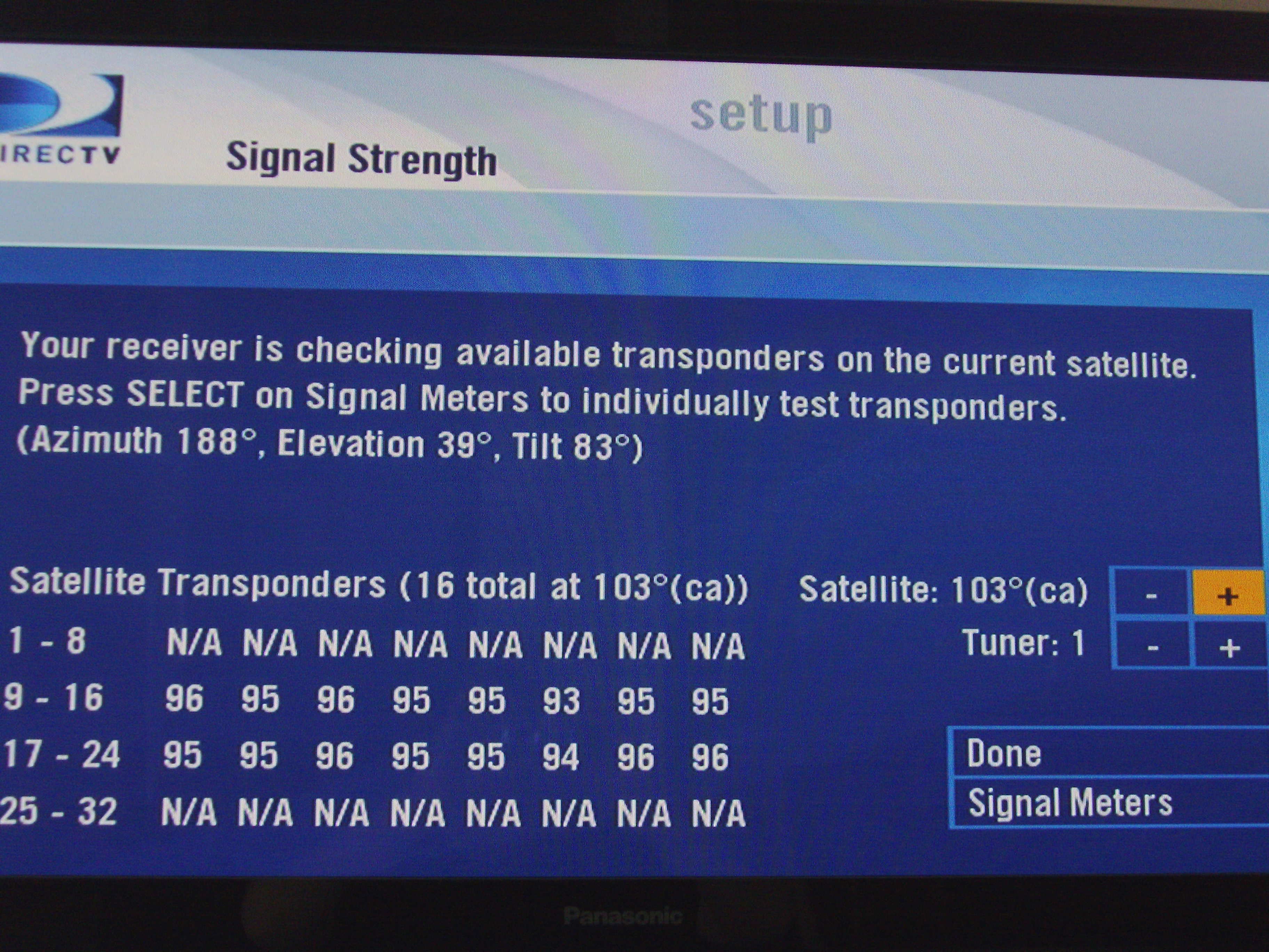

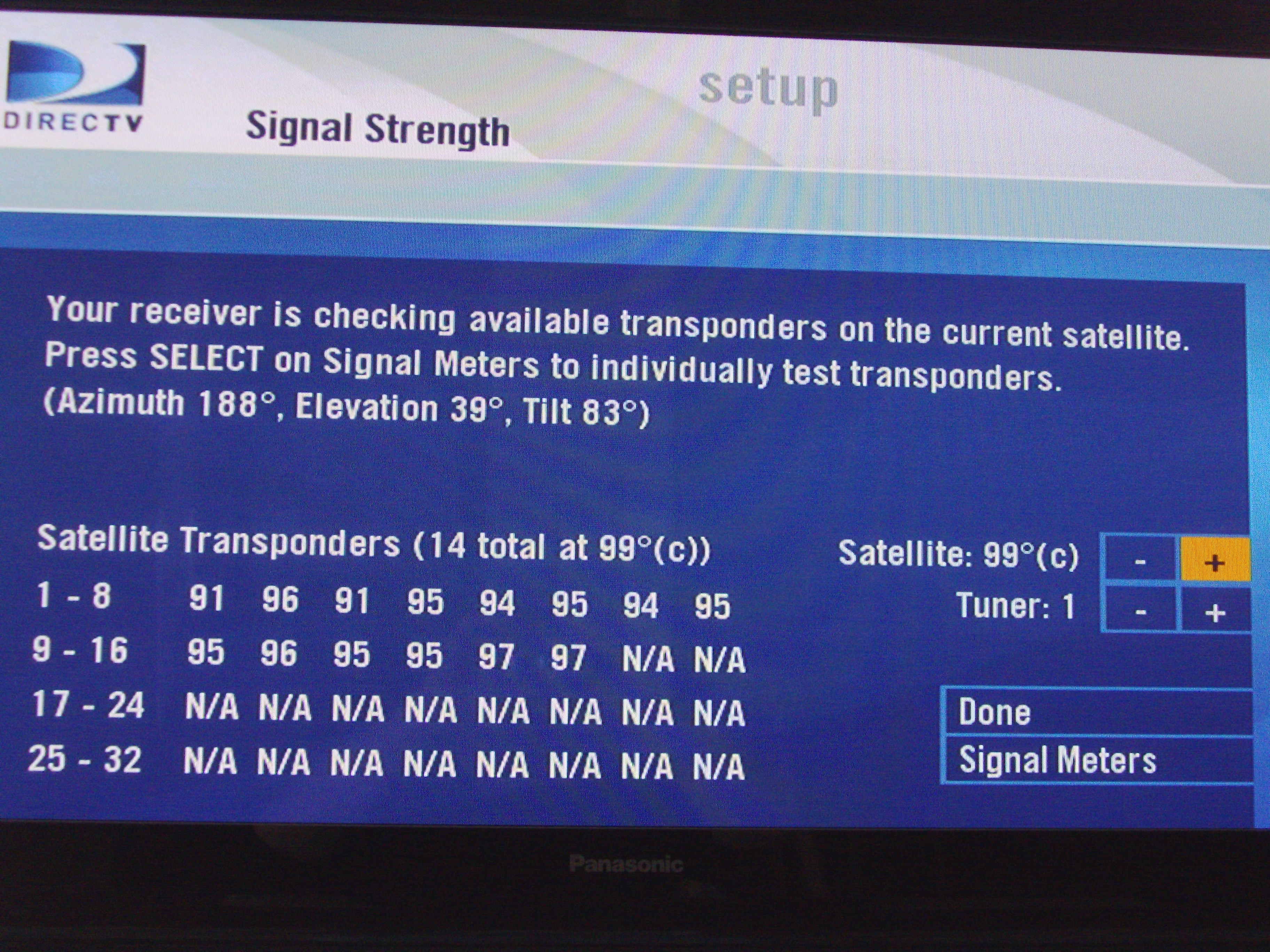

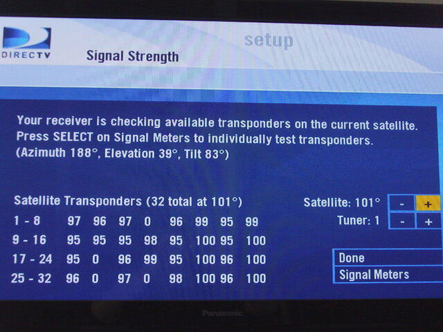

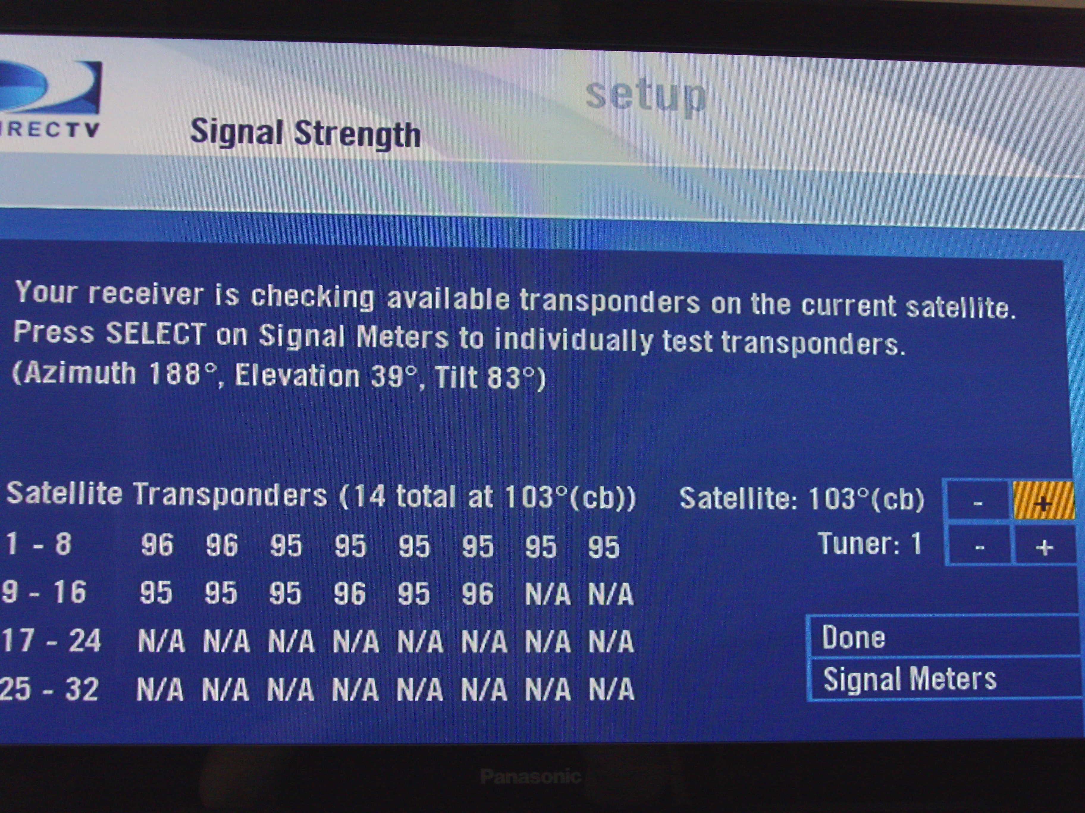

Here are mine on a SL3 setup. I'll only post the conus TPs
