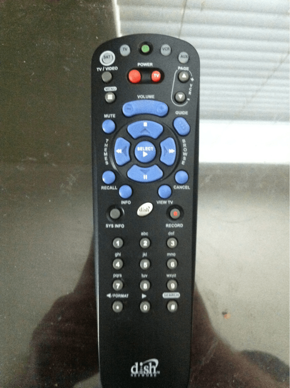

I have a 3.0 IR Dish Network remote control that I had programmed to use my surround sound unit for volume rather than my television. I'm getting rid of the surround sound unit and would like to reset my remote control to use the television for volume control. How do I reset the AUX part of the remote control? If I can't, then how do I get it back to using the television's volume control instead of the AUX?

  1. Press and hold TV mode button until all mode buttons light up
  2. Press #
  3. Press VOLUME UP
  4. Press 0
  5. Press #
This should disable AUX mode volume override (same steps to enable/disable - changes volume to default to TV mode, or AUX mode).
