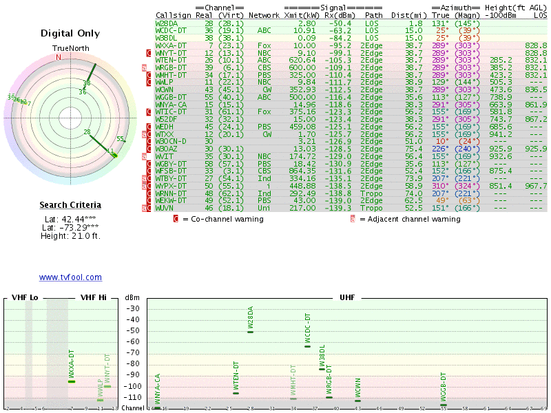

Tower Guy = Here is what TVfool says. I think I can also point toward Springfield 156 range and pick up those channels, but I really do not want to put a rotor on given that all the major networks are on a single tower near Albany - I am just getting half of them reliably.

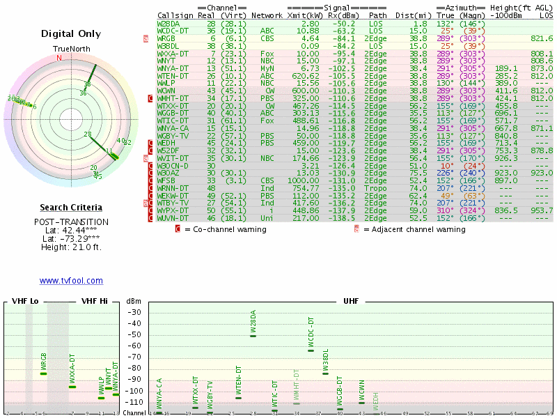

Springfield stations are even weaker than Albany's. I wouldn't bother with them.
WRGB switches to channel 6 in February. According to tvfool, the predicted signal level goes up by 25 db at your house. There will be three remaining UHF stations on the main DTV tower in Albany, but WTEN is duplicated on WCDC; leaving only WMHT and WCWN as your potential problem stations.

Thanks guys. I was hoping WRGB would improve when it moves to a VHF station in Feb. I am using a 722, but I also have a TIVAX STB-T9. Splitting the signal to both does not seem to decrease it from running to just one box. My TIVAX STB-T9 is reporting signal strength of high 50s for 7,12,55, mid-40s for the rest. WRGB has a signal strength of about 15 but of course will not lock.
WCDC is in a strange direction without a rotor. My original installer thought its analog signal my be overpowering my antenna.
I may end up putting a rotor on it when the new installer comes, maybe he can try an angular point.

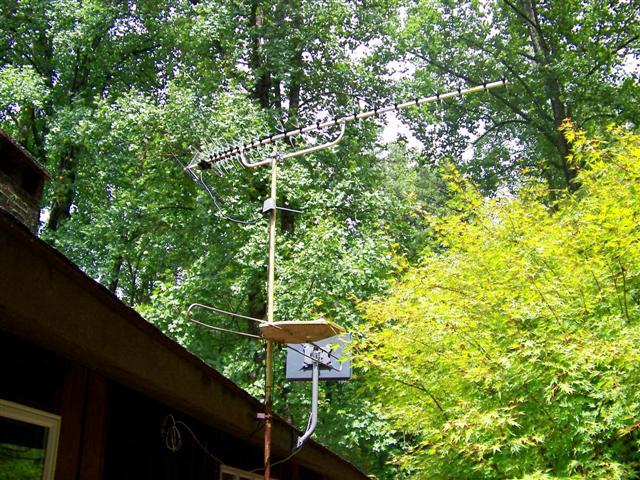

I get analog Ch4, Ch7 and Ch13 easily with a folded dipole, but digital is a whole 'nother story in the mtns of WNC. Digital Ch4 (Ch59) required an elevated and amplified Antennas Direct 91XG (Ch4 goes to Ch36 upon transition) , digital Ch7 (Ch53) I can't get (but it will go back to Ch7 so there is hope), digital Ch13 (Ch56) requires turning the 91XG 90 degrees (it's going back to Ch13 so it's a wait and see). I get multipath on occasion and today's antenna pointing may not work tomorrow.
I resisted a rotor because I DVR everything and winters here are very icy. That was a mistake because at least I would be able to repoint. The antenna is at 21 ft and looks over the house. What is very strange is everything will be fine for a while, then nothing. Even stranger, I got wktv (digital 29) from 130 miles away for two days (day and night), but still can not get wrgb (digital 39) from 30 miles away. Even stranger, I need to look through wrbg's towers to see wktv.
OTA Antennas (Small).jpgHere's a photo of my set-up which is subject to change at transition time. On top is the 91XG, below on the same mast is an old Radio Shack antenna. I am using only the folded dipole on the Radio Shack, I am not powering its amplifier I just have a Dollar Store balun hanging off the dipole so I can sum it with a LaCrosse which you can see just beyond the mast. The 91XG is amplified and used for Ch4 (59) and Ch13 (56), not seen in the photo is a wooden handle I use to turn the mast 90 degrees when I switch between Ch4 and Ch13. The 91XG is also used for Ch33, and in addition I get Ch21 and Ch62 off either antenna (analog or digital). The Radio Shack and the LaCrosse are summed in a Dollar Store splitter and used primarily for analog channels. The two coaxes go inside to a switch near the TV. It's all a bit complicated right now, but I'll sort it out into a usable configuration when I analyze the reality after transition.
Note the trees, about the same in all directions to towers. The foliage gives me rain-fade and multipath when it rains. Better reception when trees are bare.
Thanks for the pic, I will see this weekend if adding a rotor will help me. I resisted because I really want this simple and I want to be able to DVR.
