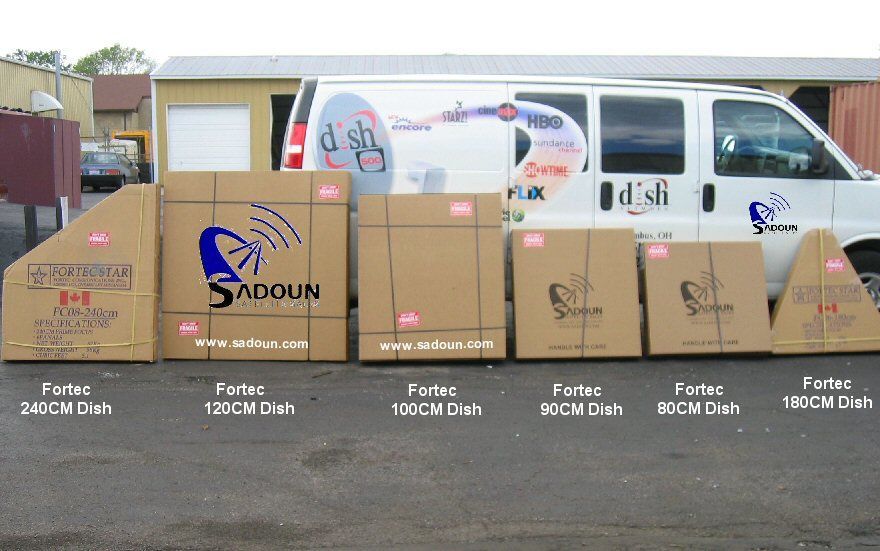

Here is a picture to show you the difference in shipping boxes for several dish sizes:
BTW, it happened we were shipping all those boxes that same day, so we decided to take a picture for comparison. :D

thanks for the picture, but why does the last dish on the right look smaller than the 100cm?
smaller is not always cheaper:
That's why sometimes a 1.8m dish (six feet) is cheaper delivered than a 1.2m dish (four feet).
The smaller dish must be shipped in a larger box than the carriers like to haul, so they might charge more than for the big dish that's broken into wedges.
So, all these guys wanting mini-BUDs on 1.2m (4') dishes, often have not considered all the facts.
Fellows who obtained the dishes locally (used), are lucky! ;)

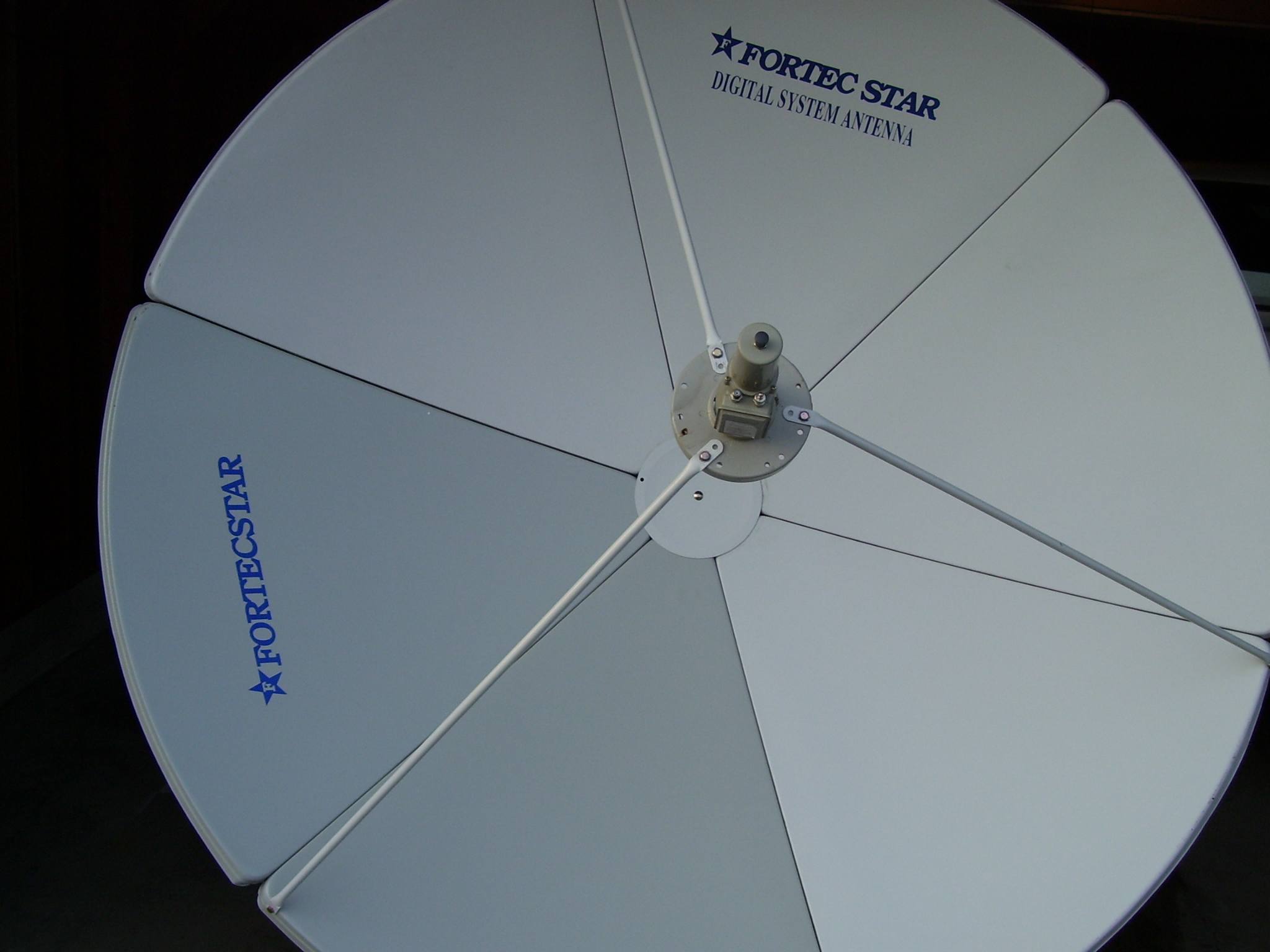

yep the 1.8m & 2.4m (6 & 8 foot dishes) are in sections to be put together.
Thats why it cost 35 bucks to ship a 6 foot dish to Minnesota and for the same price to ship a 80cm dish
as shown here obviously its in pieces ;)
