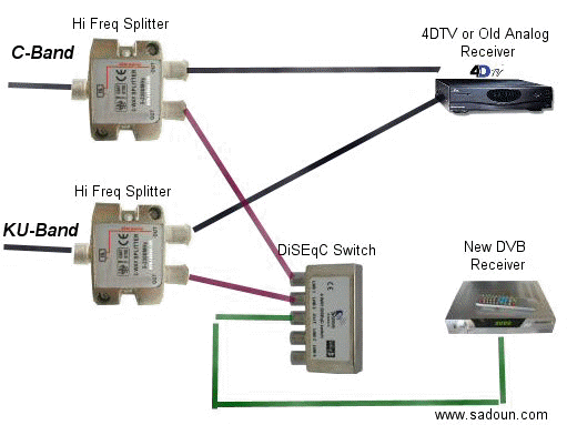

Hey JFOK, I am thinking of getting the Micro hd too. Your description of your equipement said that you have it slaved to your 920.How are you doing that if it does not have the loop-out feature?
DBKD77,
Sorry for the late response.
I'm using 2 hi frequency splitters and a DISEqC switch.
Works like a charm. A pretty straight forward set up.
Can send you a diagram if necessary to help out.
John

You can also attach the diagram here for all to see.
Babadem,
Will do.
The reason I didn't do that initially is that its the 4DTV slave diagram that Sadoun has been featuring online for years.
I figured that it was an easy find on the internet for anyone (as it was for me) wanting to slave a 4DTV to a FTA receiver.
When I can I will post the diagram. Can't do now...at work.
John
Hi,
Here's the 4DTV/FTA receiver slaving diagram I promised.
John
