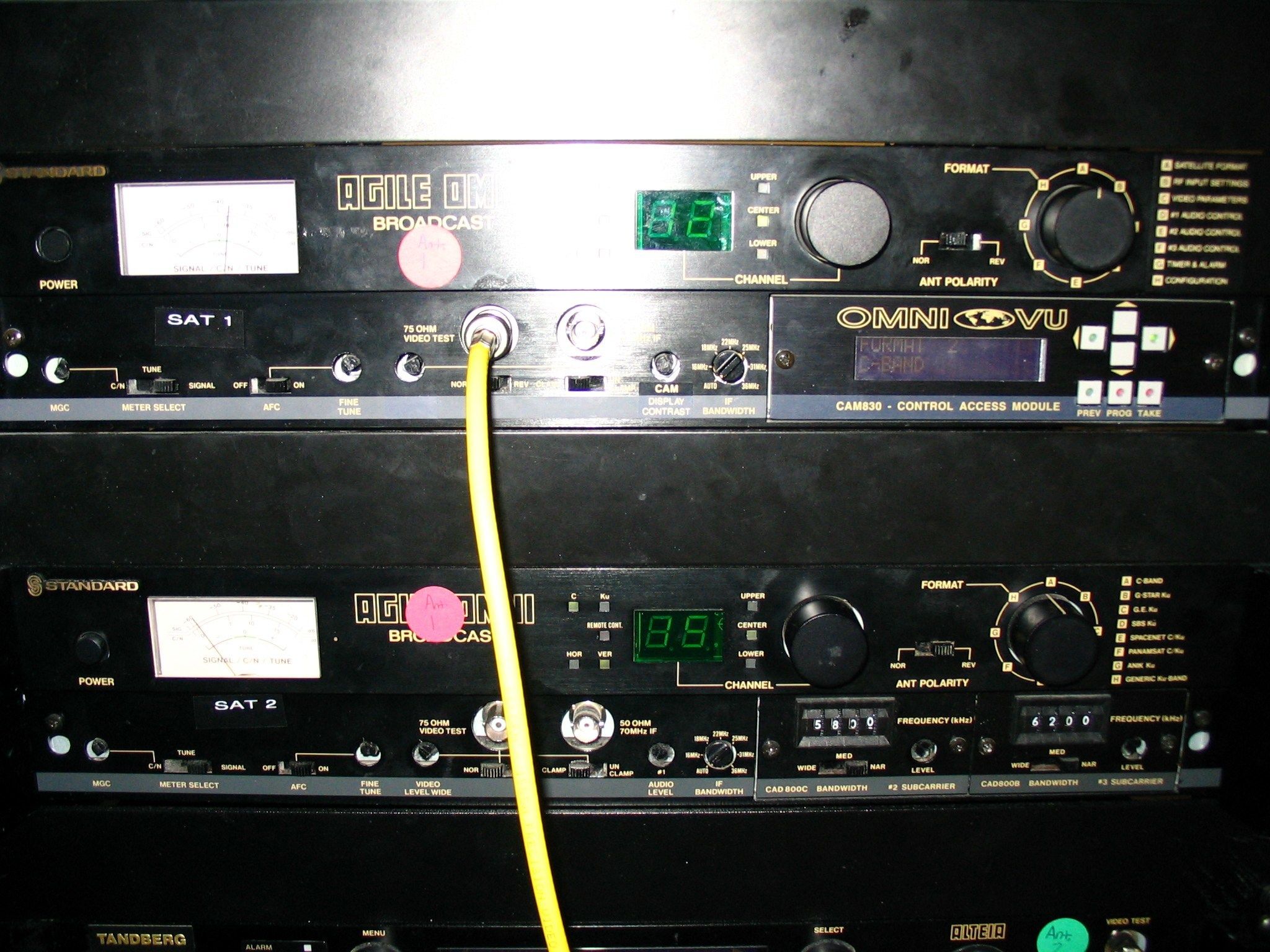

I'll try to help, but it sounds like you know a whole lot about this stuff. I used to work master control at a CBS affiliate. The feeds we took from NewsPath were always some fraction of a full transponder. My sat guy would call up and say he was on IA6 3H or whatever (G26 nowadays). Of course, that was using DVB. Analog sports on SBS6 would sometimes use Upper or Lower. And I always used Standard's Agile Omni IRD to get these. I believe it has an AUTO setting for IF bandwidth, or you can manually select it like ronjohn suggested. There are several of these IRDs on eBay currently. However, I never used the Omni for analog NewsPath feeds, so I'm not necessarily endorsing this method. Hope this helps.

Well, I don't know if I'd call it "a whole lot", but I do work in engineering/operations at a CBS affiliate, so I'm fairly familiar with the details and nuances of CBS' satellite operations with respect to network programming/distribution and their SNG (satellite news gathering) transponder inventory. Given my background in television, I was thrilled when I discovered the world of FTA and that for a couple hundred bucks, I could put together an FTA system and tinker around with searching for feeds and other FTA content at home. I think you would agree with me, Panavision, that broadcast-grade satellite equipment is a little easier and faster to configure than consumer FTA receivers, especially when it comes to tuning in digital signals. Ironically, though, the IRDs that we use at work which cost 10+ times as much as my little Mercury II don't have anything that even resembles a blind scan feature!
What really distinguishes the broadcast gear from consumer receivers is the build quality. I'd swear I could drop a broadcast IRD and it would harm the floor before it would harm the receiver :) Another major difference is that EVERYTHING is manual on the broadcast gear. There are no channel lists, the IRD stays programmed on one frequency until it is manually configured for another. And as Newspath pointed out, there is no blind scan. You have to know where the feed is, as well as the details (S.R., FEC, etc.)...
Exactly. When I'm using a digital IRD at work, I simply select the proper polarity, enter the downlink frequency, enter the symbol rate (FEC detection is automatic on most receivers), and the receiver then locks onto the signal. No need to "scan a transponder" as we do with the consumer receivers - PID detection is automatic and essentially instant with broadcast grade IRDs. That's one aspect of FTA receivers that I didn't quite catch onto immediately, and it led to quite a bit of confusion. I later realized that unlike the receivers I use at work, I actually have to "scan" a newly-entered transponder on an FTA receiver in order to get the receiver to establish a lock on the signal.
