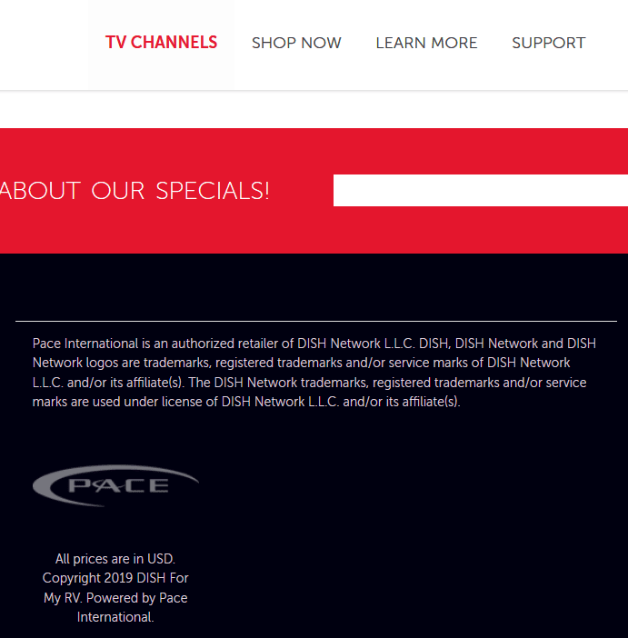

Dish 'Outdoors' isn't really Dish, it's a company called Pace International which is also a Dish retailer. They often provide incorrect information.

Go figure!
When I called to ask about all this I got the phone number right off the Dish corporate web site, the rep I talked to transferred me to what she said was their RV department.
