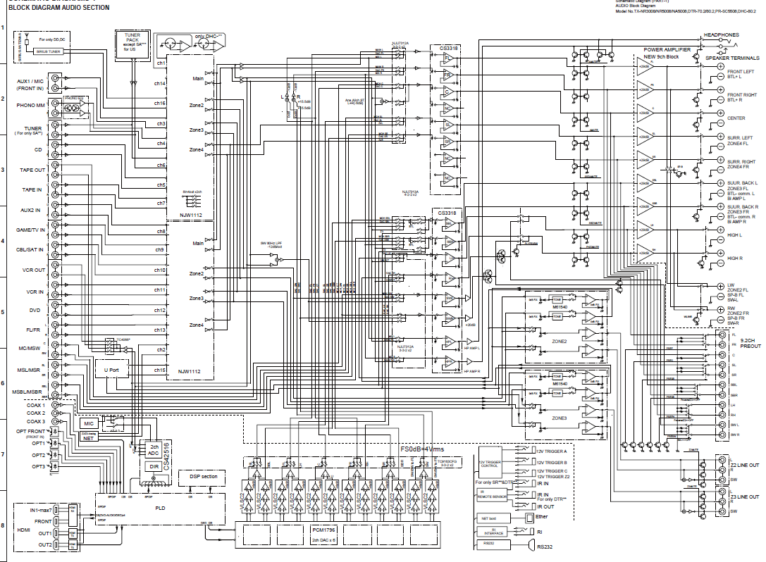

In the Audio Adjust section sub-category Direct is the heading "DSD" with the option to turn "DAC Direct" on or off. I'm thinking that has something to do using analog interconnects but it's not anything I've run across before. I have no analog devices connected, would this have any possible use to me?
The Integra has full pre-outs. Once a speaker is connected and in use, does that pre-out remain live, or is the internal amp to it shut off?

That said. If you can read a block diagram. The pre-out's stay active along with the main amps. The speakers are switcable but the main amps stay powered on. Typical of any receiver with pre-out jacks.
Preamp outs will be controllable with the main volume control.
In essence inviting you to use your own stack of external amplifiers and let the internal power amps set idle or run another room. Think of an actual movie theater with a rack of QSC amps running the speakers and not burdening the internal amps.
I would have to read the user manual. But any time "Direct" is an option I believe you can consider that the signal path goes straight through any post processing (before the main amp section). In the 2 channel stereo world if you can select something like "stereo direct" you will be bypassing the tone controls completely. Different from just setting the controls flat. The switching will jump-over the whole tone control/loudness module.

"Direct" mode cuts out all of the Digital Signal Processing (including room correction?) that might otherwise be in play. Don't worry about it too much unless you're listening to hi-res stereo content and you can't bring yourself to turn off surround modes.
DSD is a lossless digital audio format that you're probably not going to run across unless you subscribe to a fancy audio service that allows audiophile class (stupid expensive) downloads or have a library of Super Audio Compact Discs (SACD).
There is nothing audio-wise going on inside the AVR that is in the analog domain. All analog inputs are routed directly to an Analog to Digital Converter (ADC) and all analog outputs are only an amplifier section away from the included Burr-Brown Digital to Analog Converters (DACs)
