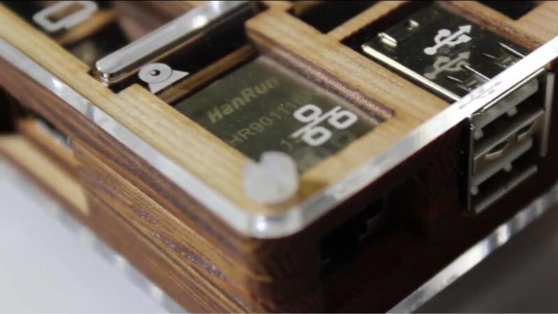

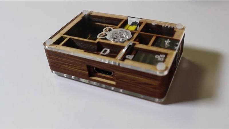

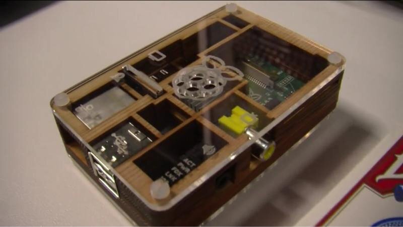

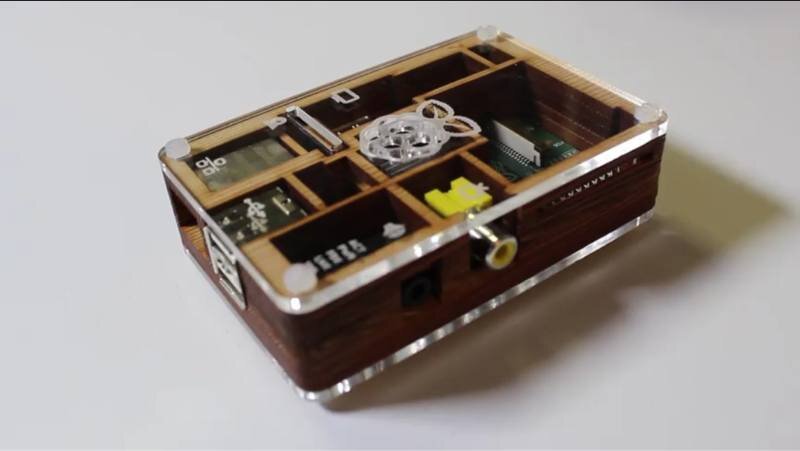

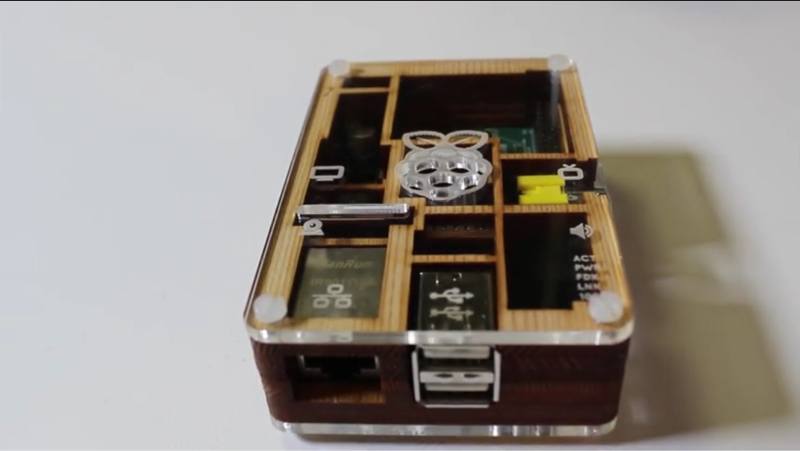

Know How over on TWiT showed how to make a Nintendo MAME using a Pi and a bunch of game ROMs. While watching it, they showed a custom case for the Raspberry Pi:
