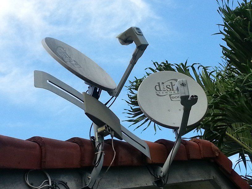

I'm getting ready to upgrade to Hopper with Sling and one Joye. I have VIP722 with Revue and OTA, and a plain 811.
What's the best way to get the upgrade done right?
Why do I need two separate satellite dishes on the roof?
Years ago the installer said that in order to receive HD I needed two dishes.

The explanation is that dish used to use a mixed arc and to get all the channels on the different sats, you had to have 2 dish's. In recent years they have moved to easter and western arc's. Now you can have 1 dish and get all your channels including locals. Only exception might be if you have the latino or international packages.
Ah! 110/119/61.5
I should have deduced that from the picture.
I don't think that picture shows a 119/110/61.5 setup, unless he is south of the equator! :eek:
If the twin LNB (dish with OTA on the mast) is pointing to the southwest, the other dish (with single LNB) must be pointing further to the west. That would imply the wing dish is pointing at 129, but the difference in the azimuth angles looks to be way more than the 10-15 degrees that would be needed. So, is it pointing at 148? That would get him zero signal.
Correct me if I'm wrong (or seeing things), but I am really curious as to what orbitals this person is receiving.
Excellent response from Mary [DIRT] in PM's yesterday evening. I have a tech coming out on Tuesday morning with a new Hopper with Sling and Joye. The two dishes will be replaced with a single 1000.2 dish. This is what I call customer service!
