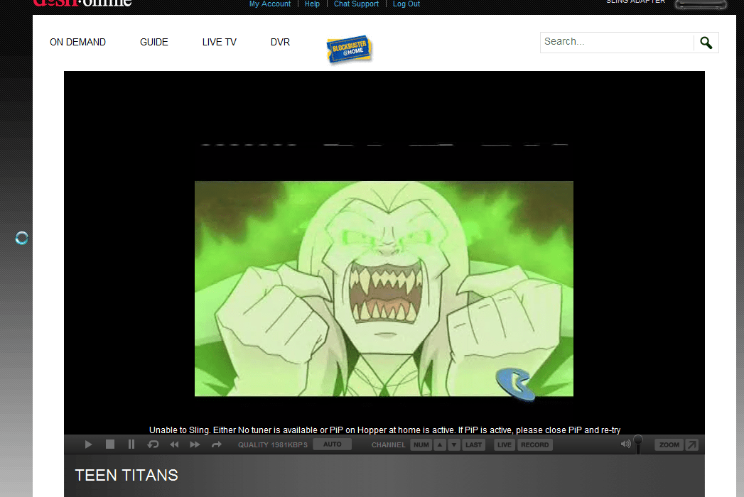

I am getting the unable to sling message. Video continues to play just the message pops up every minute if the screen is maximized. This is occurring on dishonline.com using a sling adapter and Hopper. I do not get any errors watching via slingbox.com with the same equipment. The downside to slingbox.com is a crippled remote and no guide info if using a sling adapter (worked great with my old 922).
