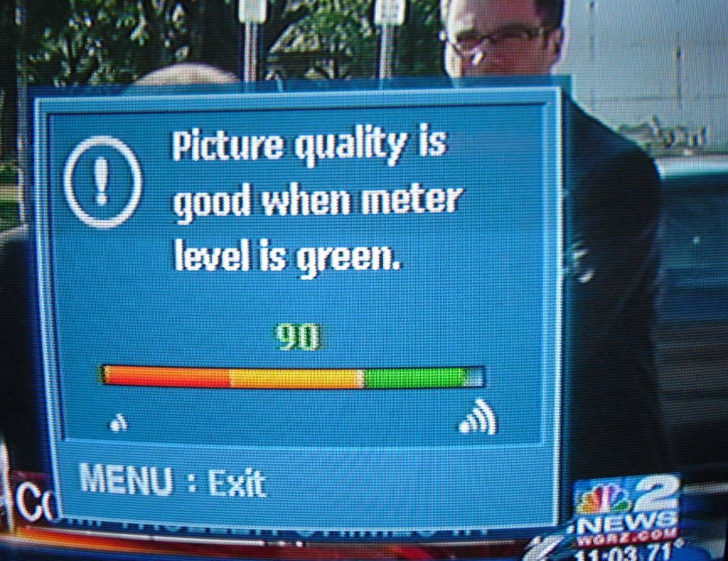

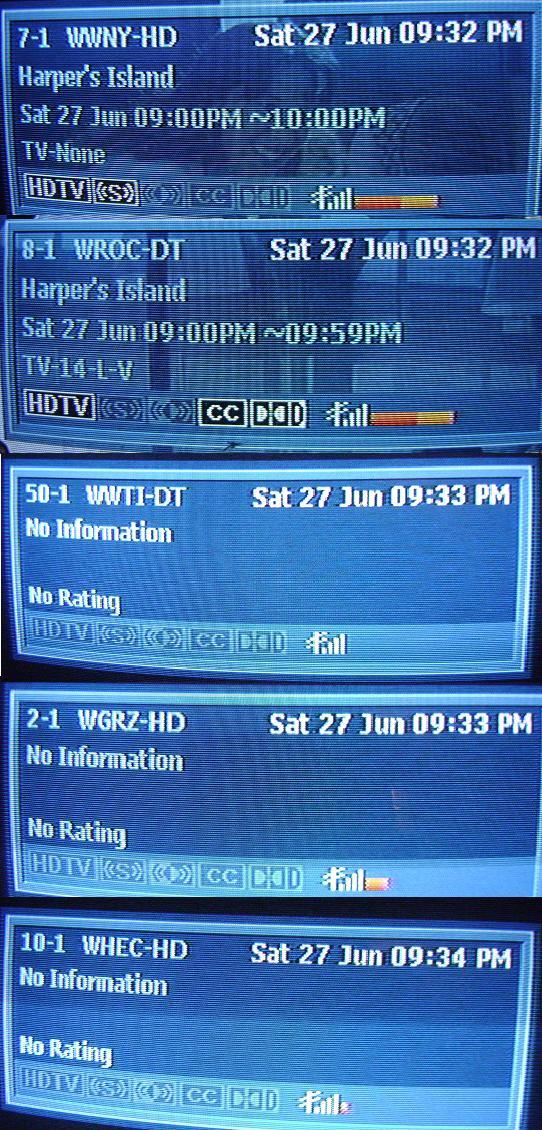

One of my local channels WWTI lost signal, so I decided to do a rescan and got about 10 more channels. Whats surprising is all the channels are from Buffalo and Rochester both over 150 miles away. I have a cheaper roof antenna about 7' long, with no amplification. Channels im receiving are:
WGRZ-2.1
WIVB-4.1
WKBW-7.1
WROC-8.1
WHEC-10.1
WHAM-13.1
WNYB-26.1
WUHF-31.1
ION-51.1
Channels I always receiver are:
WWNY-7.1
WPBS-16.1
WNPI-18.1
WWTI-50.1

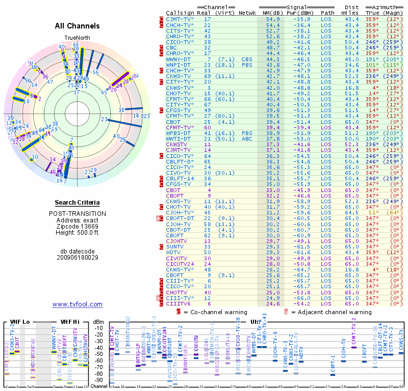

convertunits.com reports flying distance from my town to Rochester is 151 miles and 213 miles to Buffalo.
WGRZ is out of Buffalo.

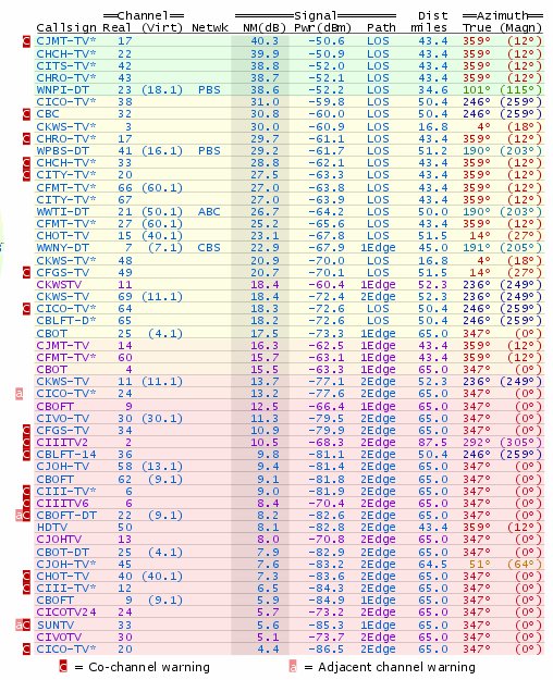

Tv Fool report from my address.

Im pretty sure there's no repeaters around except for Fox 28 in Massena but its still analog. A few of the channels from Rochester where breaking up, although Buffalo's channels 2 and 10 came in strong. Right now 2,10,51 have low signals, 2 breaks up and goes out while the others dont come in.

Nothing tonight but its expected with the rainy weather. Last night it was awfully cloudy but channel 8 still came with 60% signal. Also last night yet again co-channel interference blocked channel 50.1 (21). Hopefully the rain stops and I get my rotator fixed, so I can explore other distant channels. My antenna got stuck in the west position sometime this week and I just realized yesterday it wast moving.

I'm in the same area as you PM. Haven't gotten anything that far away yet with digital, although have had Rochester and Buffalo at times in the past with analog. So far I have gotten channel 4 - CBOT-DT, 9 - CBOFT - DT, 20.1 - Sun TV (2 channels- same thing), Omni 1 at 27.1 on clear nights from across the border, as well as the locals you listed. There is a signal at 66 (Omni 2?) but haven't been able to lock it yet. My rotor works good, but I should probably put up new cable and get a pre-amp.
