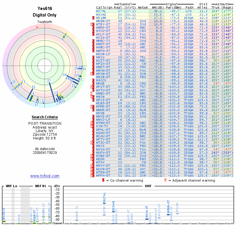

I am not sure what to believe. Antennaweb and TV Fool give me contradictory answers to my problem.
I am located pretty high on a hill (elevation 1850') on a south east slope. To the south east and 85 miles LOS is New York City. To the south west is a mountain about 2100 feet high. In that direction and about 73 miles away LOS are all the Scranton / Wilkes-Barre, PA stations.
Antennaweb says forget about it. All of them.
TV Fool says the PA channels are possible with a good outside antenna (-0.4 to +9.4 NM) . NYC shows up as around (-3.2 to -13.6 NM). I also know I must boost all of these values to above 0 to get a usable signal.
Years ago I had a VHF antenna pointed at New York. 2, 4, 5, 7, 9, 11 and 13 all came in fine with no snow at all using a top of the line (at the time) Channelmaster Quantum. I forget the exact model number but it was the biggest. Some of these channels are going to UHF after June 12th. I never before played with UHF before and neither has anyone else near me except for Scranton but those folks were not affected by that mountain I mentioned earlier.
Take a look at my complete post transition TV Fool report and let me know what you think. Again, Antennaweb says forget about it. Thanks.

I am not sure what to believe. Take a look at my complete post transition TV Fool report and let me know what you think.
I say forget about antennaweb.
In your shoes, I'd get a Winegard HD7698P with a preamp and a rotor. Most of the time it would be aimed at PA and should receive them fine. NYC will be hit or miss depending on the weather and the transmitted ERP in your direction.
The local LPTV station on channel 27 will make it extremely difficult to receive WNBC on channel 28.
It's also worth trying for WVIT.

Just randomly guessing you are on the NW corner of the Thomas Ave loop, WABC-DT is about -3.2 NM which is doable with the proper antenna.
I would recommend seperate UHF and VHF antennas, probably an Antennas Direct 91-XG for UHF and a Wade-Delhi VIP-306 for ch2-13 or a Winegard YA-1713 for VHF high (7-13).
Combine them with a CM 7777 pre-amp and hope for the best.
Nice guess on the Thomas Ave location but I am on the NE corner.
I have no use for low VHF. You don't think I can get away with just one antenna for everything? Also, I was hoping to pick up signals much weaker than -3.2 NM. I was hoping for something as weak as -13 NM. WWOR-DT shown at -12.2 NM is the weakest I was hoping for. Is this asking for the moon?
The 3 nearby LPTV channels shown on the report don't even seem to exist. I have asked everyone around here and nobody has ever heard of them. I do a have cheap amplified indoor antenna that gets nothing. I did find something on the FCC website that says they are all owned by John Mester Income Family Trust. Whatever that is.
If you 're going for below -10 you absolutely must have seperate antennas and the very best of both antennas, too, plus you need the CM7777 pre-amp.
At channel 38 both the CM4228 and the DB-8 will get you about 13.5dB gain, the 91-XG pulls about 12.5dB.
The best VHF-high antenna is the Funke PSP.1922 (14-15dB gain 7-13), but they are a bit hard to find.
The Winegard YA-1713 will pull about 9-10 dB from 7-13, so it should pull WABC and maybe WPIX.
In order to pull low dB stations your antenna must have more positive gain than the negative gain at your location, i.e., you must achieve positive gain at the antenna connection, before the pre-amp.
Down around -12, you're going to need the highest-gain antennas, perhaps separates for UHF and high-VHF, with a powerful preamp and maybe a little bit of luck. And even then, I suspect reception of a usable picture would be sporadic.
