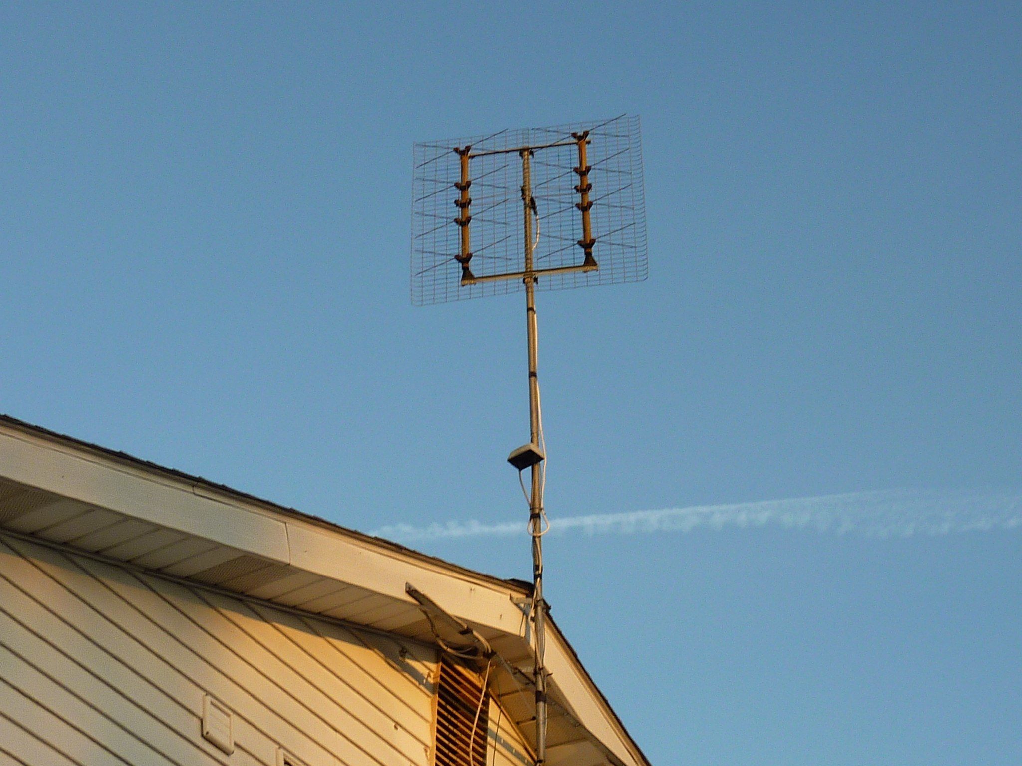

I have a Channel Master CM4228 UHF antenna with a CM7777 pre-amp installed on my house.
There is no rotor on the antenna. I aimed the antenna to get the maximum signal level on my Hoppers from the Philadelphia stations. I receive the following stations at 80 to 100% level on my Hoppers:

I assume the antenna design is allowing these stations to be picked-up from the rear of the antenna and I could improve the receive level if the antenna was rotated more in their direction but it's fine for me now.
