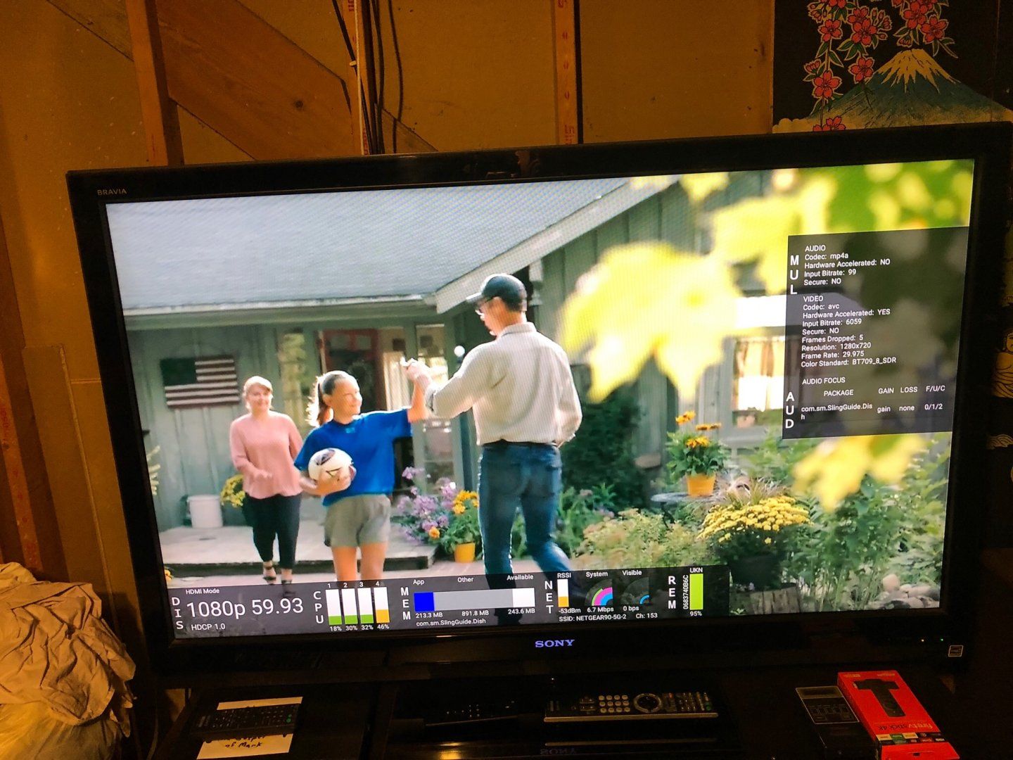

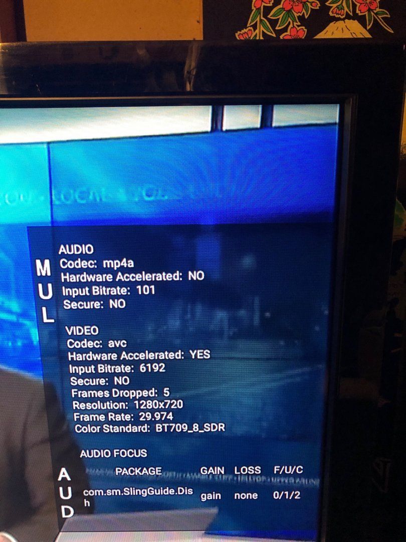

For the Amazon 4K Firestick there is an app called Developer Tools Menu. This allows you to turn on System X-Ray and Advanced Options. When this is turned on it creates 2 overlays that stay on the screen regardless of what app is running.
The one overlay shows CPU usage of the 4 cores, memory usage, and network diagnostics.
The other overlay displays the audio and video codecs, input bitrate, frames dropped, resolution, and frame rate.
This is normally used by developers to test their apps on the Firestick.
I have found it useful when debugging Dish Anywhere on my sons's TV.

Here are screen shots showing System X-Ray with Dish Anywhere on my Amazon 4K Firestick.
