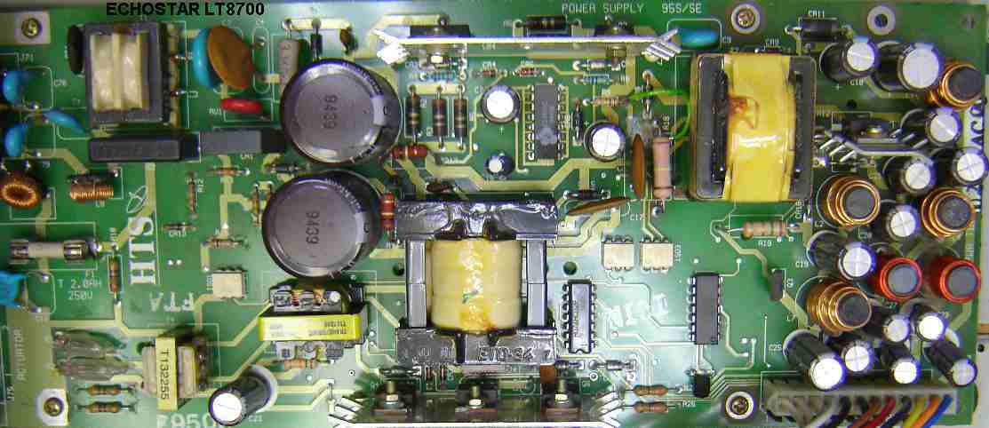

However, there's one thing that keeps occurring time and again: something goes terribly wrong in the 230 Volt power part, causing not only the fuse to blow but also some kind of power surge most likely between C18 and R18, causing the entire track on the motherboard between R9 and T1 to melt
away.
After replacing the melted line and of course the fuse the receiver then works normally for up to a year when the same mishaps reoccurs. This has been happening in a number of copies of the LT-8700 in different locations and leads to the assumption that there must be something in the power part that slowly looses it's value over the years and thus causes a voltage to become too high at a certain point.
Most recently we thought we were lucky because only the fuse had blown, but once it was replaced a few days later the receiver blew up once again. But then again, the mere replacement of the melted track and introduction of a new fuse somehow resolved the problem again for the time being. But of course we would like to resolve this problem permanently but we have no idea what to replace. The elco's don't seem affected, and also it seems rather illogical that replacing the fuse would cause this major shortage while repairing the erased track that was wiped out by that shortage suddenly makes the receiver work OK again for up to a year. We really have no idea where to start searching for a solution.

I'm sorry, I should have added the schematics and a picture of the place where the track on the motherboard melted away. As the LT-8700 and it's predecessor the SR-8700 were just about a DX-er's dream in the analog period, it hadn't occurred to you that this type of receiver didn't have the same reputation in Echostar's homeland.
And to reply to the other question: yes, the fuse of course was replaced by a correct one, 2.5 Amp, slow, 250 Volts. No mistake possible as Echostar was so smart as to print the value right on the motherboard.
I hope I did OK uploading the two illustrations, the Dutch word "voeding" means "power supply", I see a question mark over the schematics of the receiver which is a pdf file, if I need to alter it into something else please let me know?

Is the trace that's burning off at the spot where there looks to be a green jumper wire connecting two resistors? Can you tell me the location numbers on the board for those resistors, if that's the spot? I can't really tell for sure if it is from looking at the picture, if that's where it is or not, the picture's not really clear on my computer.

Its me helping PaulvR with this problem .
Paul already wrote : [causing not only the fuse to blow but also some kind of power surge most likely between C18 and R18, causing the entire track on the motherboard between R9 and T1 to melt away. ]
looks to me the track did not burned away by overcurrent but by the lightning .
The green wire connects again R9 and T1

Typo? Did you mean R9 and T2? The R16 and 17 that Fat Air posted about above are right in that area, I'd start with checking them, also R18 and CR6,5,4, C1[or maybe C18-schematic's a little blurry] and other components in that area. Also check for bad solder connections, especially on the pins of T2, but also across the whole board.
